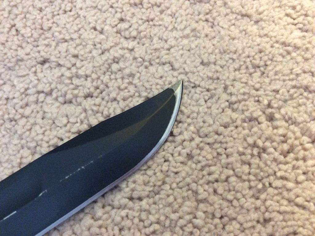

So i have a kabar short sitting in my drawer doing absoulutly nothing its just not a good cutter for well anything i was wondering if anyone has taken the coating off of a kabar and if so plez post pics so I can see if its worth it the problem was that the tip of the blade the coating is pealing upwards and moisture is getting under and its a high carbon steal so well yeah
also towards the end of the sharp part of the blade it is like a differnt angle i have a lansky 70 grit stone and have spent over a hour on it but cant get it down to a 20 angle i use a sharpy to tell if im hitting the edge yet but im not so any suggestions to help ???:confused:

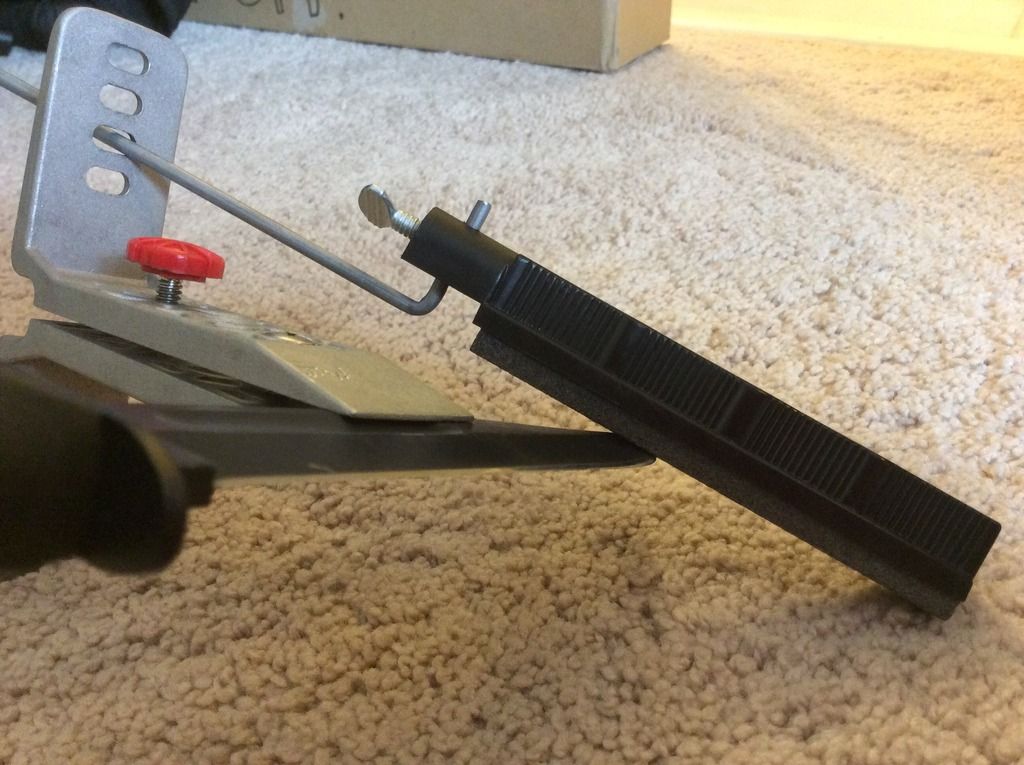

I saw someone explain why the tips of knives get weird angles on these guided sharpening systems...
I think Jason B can explain it, but the bevel will almost always be wider at the tips using guided systems.
I'm not Jason, but the farther away the edge is from the hole of the clamp, the more acute the angle.
Yep, basic trigonometry.
With a guided system, the farther the stone moves away from the clamp point, the more shallow the angle becomes. Starting at 20° at the clamp, then moving 2" down the blade, the angle could be be 15° or less.
Then why does the sharpy mark on the tip of the blade not come off see pic
Because the angle has dropped to where the stone is no longer hitting the apex of the edge but riding on the shoulder. (See top pic) It's thinning behind the edge, not sharpening its apex.
Note that the Sharpie is gone from the edge closer to the clamp point and that the bevel is starting to widen as it gets closer to the tip. Keep grinding and it will become wider and wider.
When I use my Lanksy or DMT system, I try to stay within 1.5" of the clamp point. A single clamp point mid-blade is fine for 3" folders but with a 7" Kabar, I use 3 different clamp points.
If you moved the clamp closer to the tip, the Sharpie marks would be gone in the first couple of passes.

Thx would that still be necessary even though it's a kabar short
IMO, yes.
The short Kabars are 5.25". So I would use 2 clamp points. One clamp point about 1.25" to the left of the edge's midpoint, the other about 1.25" to the right.
