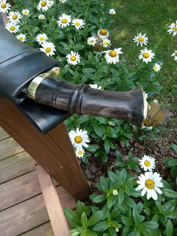

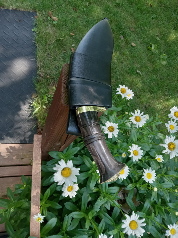

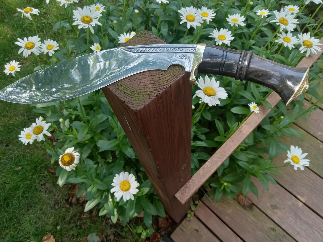

A good rule of thumb might be to add some mineral oil when you do your kitchen cutting boards and wooden knife handles. They will soak up the mineral oil which gives them their shine and glow back. I just did my horn handle and so far it has not soaked it up like the wood, but I'll just let it set a while and check it later in the day. If it hasn't soaked it up, I'll just wipe it down with a paper towel and call it good. At least this way, you have a reminder of when to oil it. Cutting boards start to look dry, especially in their centers where you do the most cutting, when they need oil. I've had this 9" mini now for about 6 months and it is not absorbing much mineral oil. Reading this thread was a reminder to add some oil in case it did need some.
