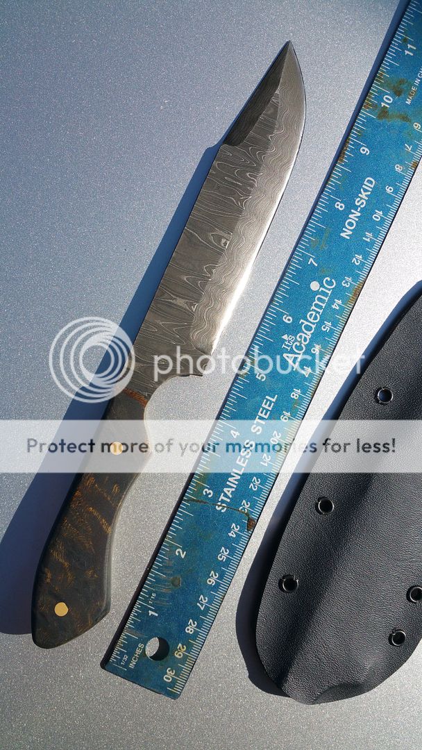

It arrived yesterday but I had to wait for the belts until today. I realized I needed to do something about the platen and do it quickly, so I got to work with a marker and a Sawzall. Once the bulk was out of my way I finished it up on the grinder before hand sanding all the edges and face of platen. Once I had everything dialed in I slapped on a 120 grit Norton Blaze belt and sharpened a few knives, worked perfect!
Obligatory photos,
You don't need the yellow thing. I tossed it. You can use the idler pulley for contour inside curves.
Tempered glass works fine for a platen liner. You can have them cut at your local glass or mirror shop. Quarter inch thick material is quite satisfactory. Attach with JB weld, it will slide out of place until the adhesive sets up; I super glue farmer match sticks around the perimeter to hold the glass in position. Bevel the leading edge of the glass where the belts come across.

Some mods I made over the years to my Kalamazoo:
Can set the belt grinder to any angle quickly then back to 90 degrees just sliding the angle (below the legs) and dropping the plate the grinder is mounted on. Plate is hinged on the back.
Made an adjustable platen to allow the belt to be as slack as I wish. Less/more convex on edge.
Handle for leverage when changing belts.
Some belts: grits 800, 2000, 2500, 3000-3500,5000-6000
Stock belts: 80 up to 600 grit
1200X (9 micron), 500x (20 micron), Trizact A45
Leather belts, Linen belts loaded with Hand America 0.5 & 0.25 spray, green chrominum oxide

I will be replacing it with a surgi sharp wheel soon, I have a fine scotch brite wheel coming that I will be using to deburr between the belt and the leather wheel. It's a solid 3 step system that creates very nice machine edges.
I haven't done a lot on mine but did refinish a Swamp Rat the other day, turned out nice. More than sharpening this was one of the main reasons I purchased the grinder.
before
After, A65 belt
Nice work.I don't know if they make a scotch bright belt for a 1x42 but they really put on a nice finish and they're pretty fast.Is the surgi sharp a leather wheel?When I visited RW Wilson He used a hard felt wheel to finish his edges.He came off a worn 320 belt and used a green and then a fine white to finish. He said he considered it to produce one of the best edges.It was really sharp and well polished. I've considered getting a 1x42 just because of how portable they are.My 2x72 is pretty much sitting in the same spot it was for the last 16 years.
There are several Scotch brite belts available in 1"x42".
I prefer zirconia alumina over the blaze belts and have had better results with Trizact than scotch brite.
