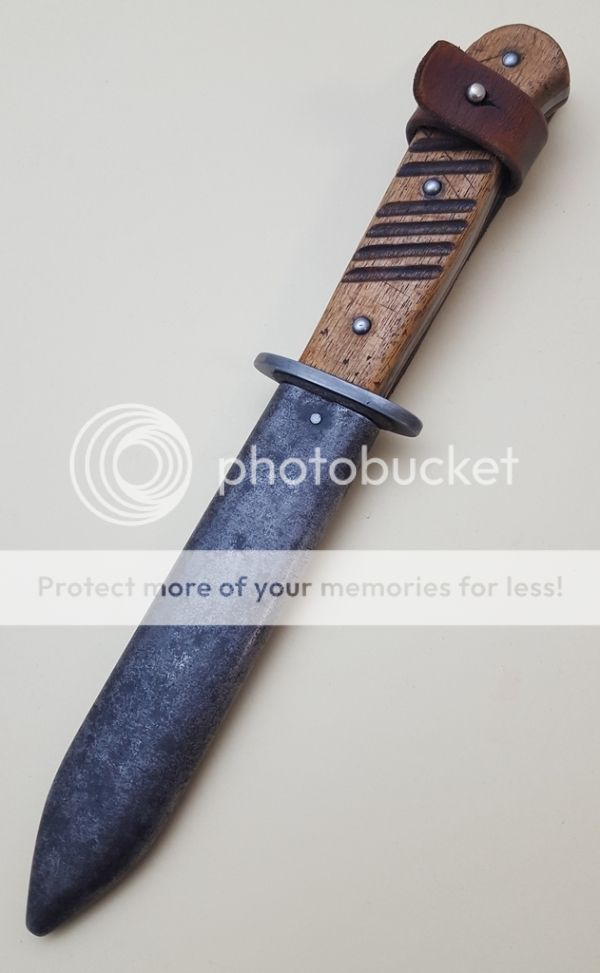

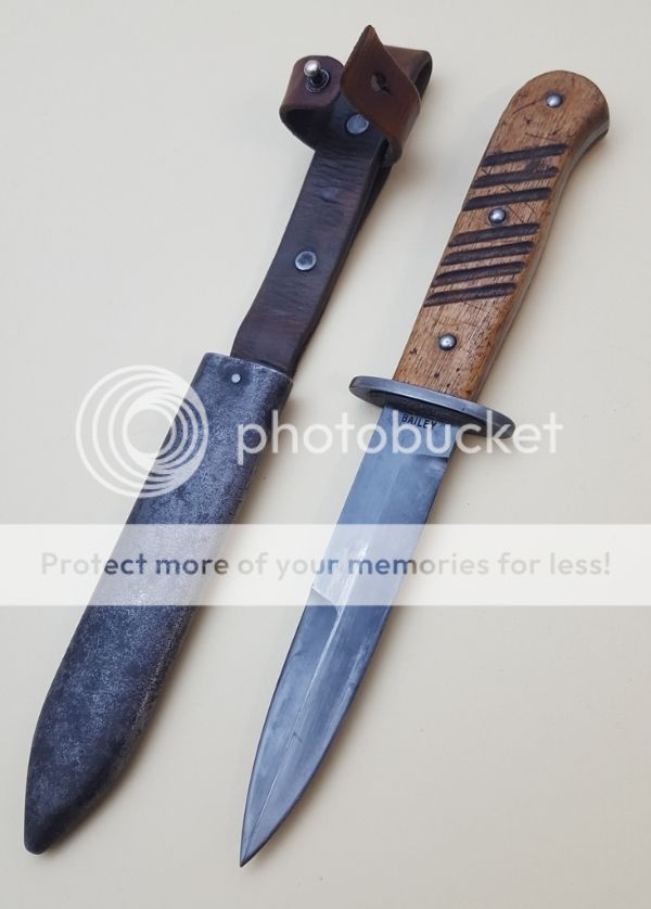

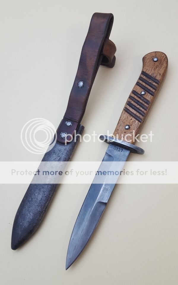

There's a long story behind this one.
When I was nine or ten, I was given a steel knife sheath. It had no belt loop on it, but my Father made one from a piece of old conveyor belt and riveted it on for me. For the next few years it was used to carry several leather and stag handled knives bought from the local fishing tackle shop.
At some point, the belt loop disappeared and I learned that it was an original Hitler Youth sheath.
For years it has sat in my shed gathering dust, until last week, when I decided to do something with it.
First job was to fit a new belt loop based on the one it would have had on it originally. I then aged it to try and give it a 1930's/40's look.
Next step was something to go in it.

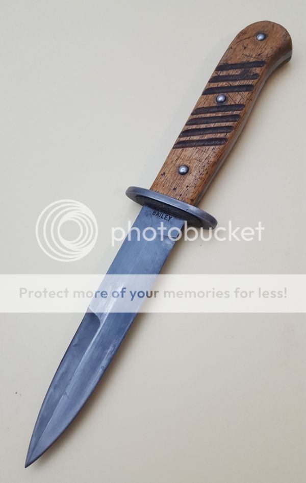

I decided on a trench knife influenced by WWI and WWII German designs.

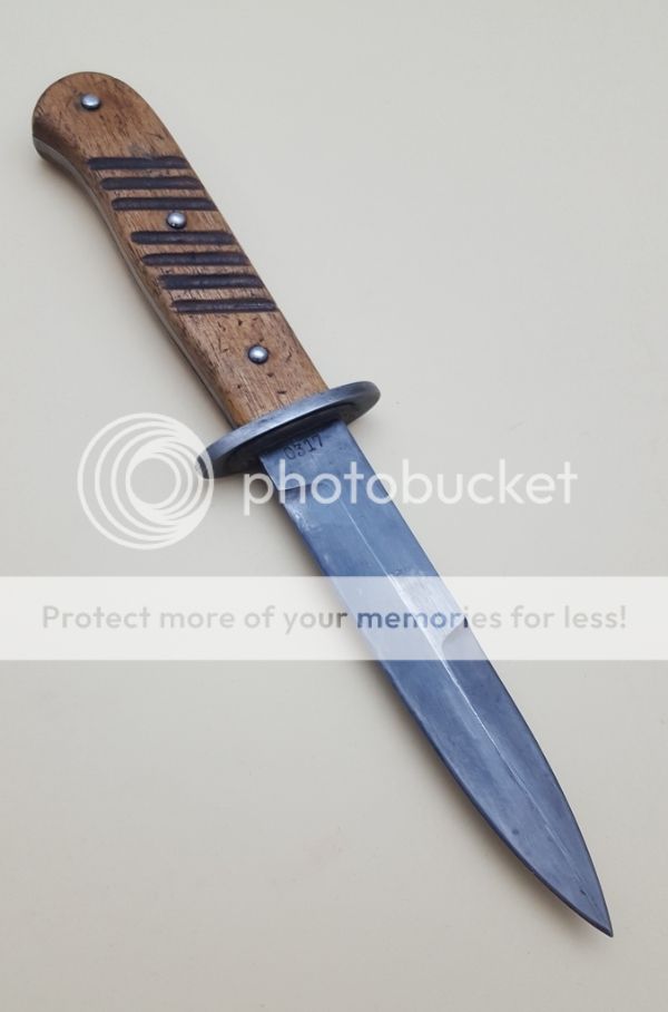

With a little cold blue, and some select distressing, I also tried to make this look 70 years old.

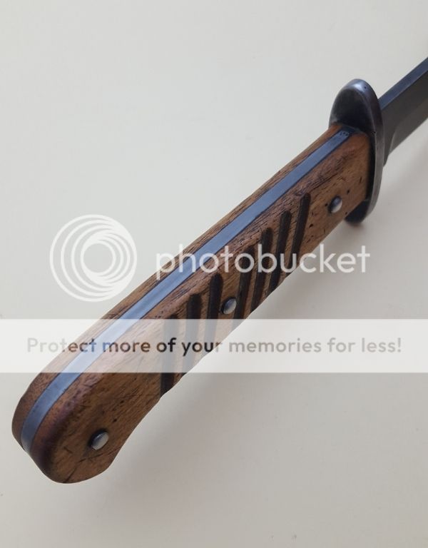

The blade and guard (complete with period style leather washer) are 01, the handle is beech as was often used on these type of knives and the pins are steel.
As well as my name, I also added the month and year I made it to give it a more military look.
A strange project, but hopefully you can see what I have tried to achieve.
Thanks for looking,
Ian.
That looks 70 years old. Mission accomplished! :thumbup:
VERY cool project, man.
Sorry, I forgot to put the dimensions...the blade is 5 1/8" and the handle is 4 3/4". Both blade and guard are 5/32" 01 tool steel.

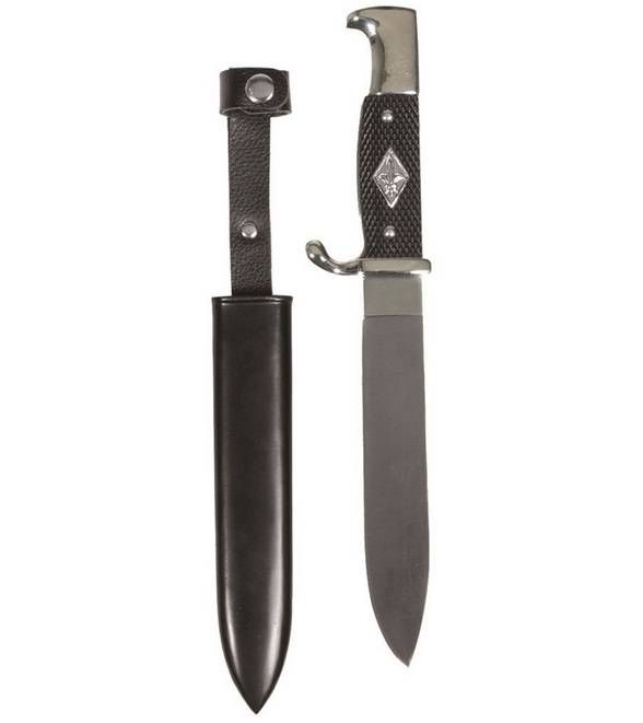

This is what my old post WWII German made scout knife looks like (photo of generic scout knife snagged from the web) - notice inlaid handle diamond scout organisation Fleur de Lis symbol.

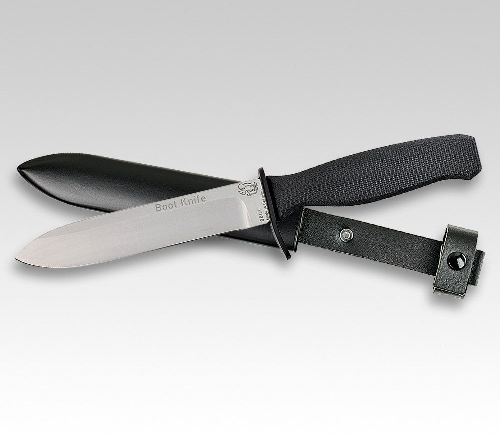

Various other knives also still comes with a similar metal sheath - here is but one example. This has similar blade and sheath (not handle) to one version of the post WWII Bundeswehr knife, just labelled 'Boot Knife,' for that tacticlol vibe as sold on the civilian market. Eickhorn made.

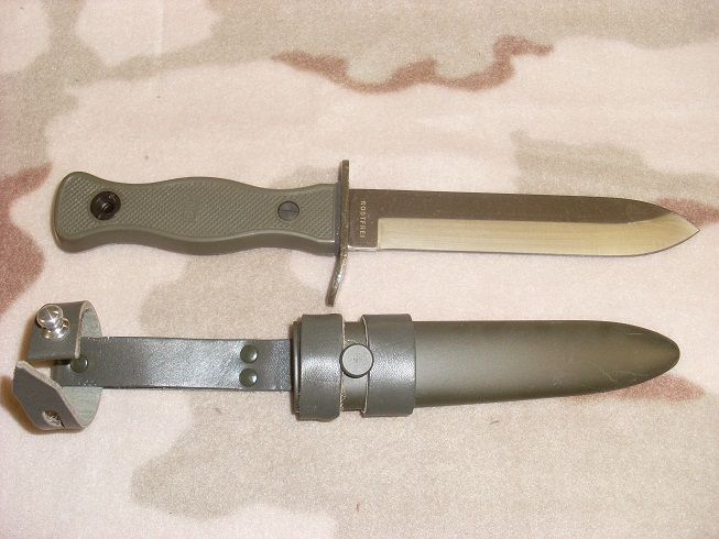

Here is what the post WWII Bundeswehr knife looks like. So a lot of overlapping and selling military styled knives on the civilian market - most likely many were military knives simply relabelled and/or with slightly different details (handle config, logos, markings etc etc).

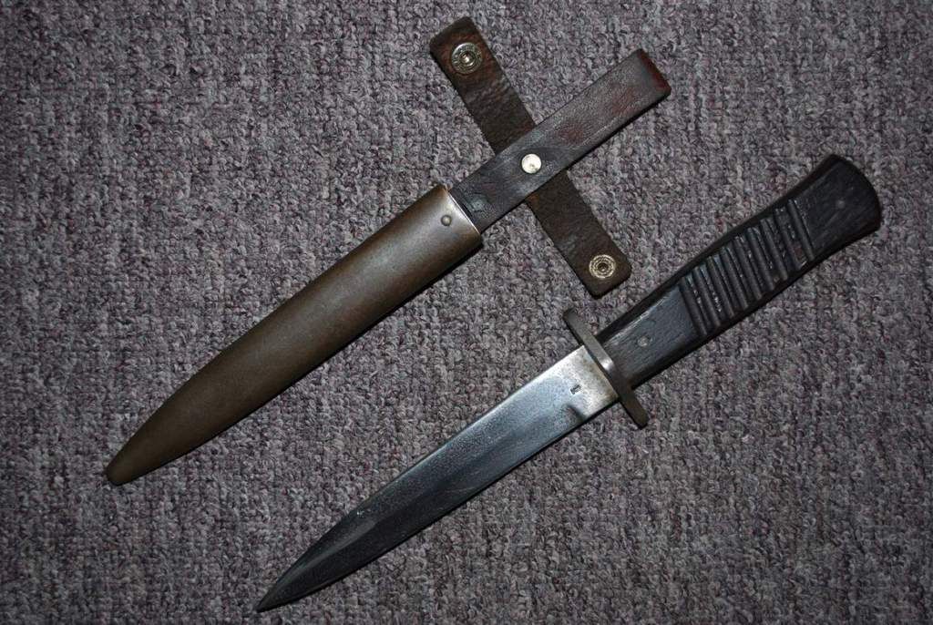

Here a German WWI & WWII 'Grabendolch' ('Trench Knife').
Notice how the sheath of the 'Grabendolch' is more pointy than the scout knife above.

Thanks Bladescout.
Some interesting knives there, especially the Grabendolch. That along with the Luftwaffe fighting knife I own were probably my biggest inspiration with this.
I'm pretty certain that the sheath is HJ. It came from an old man who lives near me who had a lot of WWII militaria, my Father just fixed up a belt loop for me.
I also had a 1945 dated US issue folding shovel, a 1943 dated US issue canteen and a WWII US respirator case from him.
The sheath looks identical to a HJ sheath, and is the correct size. From what I know about HJ knives, the main thing which sets them apart from post war scout knives is the lack of lip on the top.
The rivet holes are also identical as are the zinc plated internal retainer springs. I may be wrong, but all the evidence seems to point towards it being an HJ sheath.
As with all militaria/antiques, it's a shame these items can't speak.
