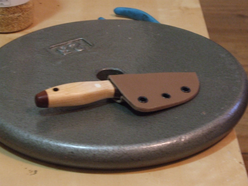

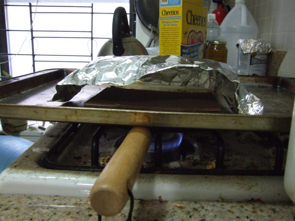

This is my first Kydex sheath that I have made. It was fun. I improvised a sort of toaster oven, with a heat diffuser, cookie sheet, and some aluminium foil, set up on a gas stove top.

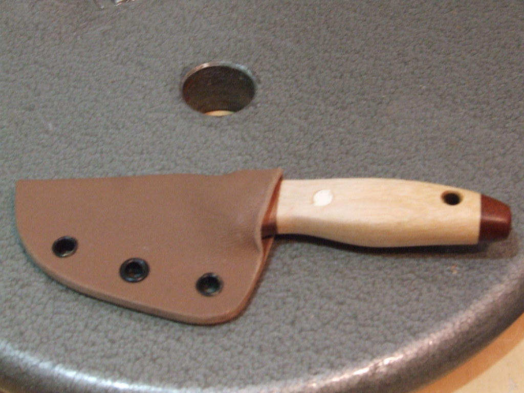

I tried some different ways of pressing, but did most of the shaping with just my hands, insulated with terry cloth rags. I decided that making the sheath with one side flat would be easiest.

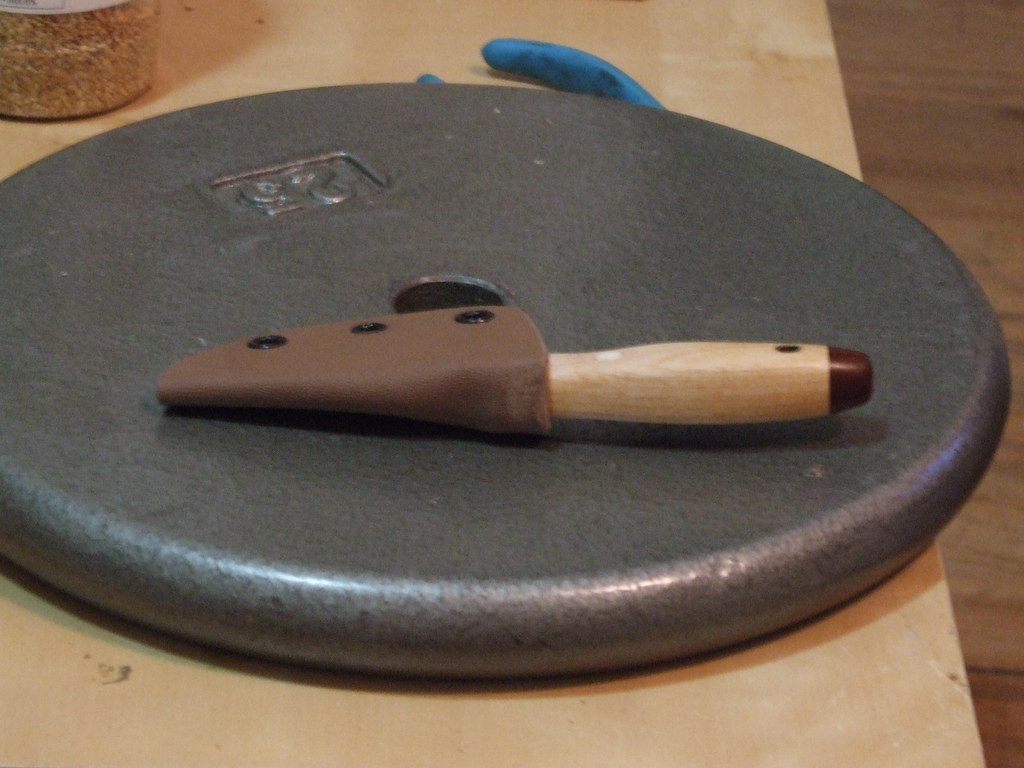

Seems to retain very well; I tried shaking it every which way, and could not shake the knife loose.
Fun!
