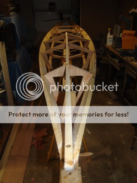

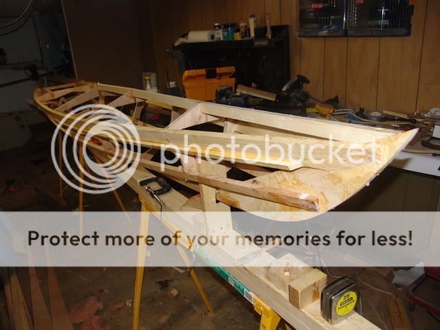

I started building an 18' wood and fiberglass kayak, but it will take hundreds of hours to get looking the way I want it to, so I put that boat on hold and started a skin on frame kayak which goes together much more quickly.
SOF kayaks are built just like the first ones - a waterproof material is stretched over a wooden frame. Only difference is that I'm using nylon instead of seal skin, and because I have plywood available, I don't need to steam-bend dozens of ribs. Here's the progress so far. The wooden frame is just about done; I need to finish the stern and sand/oil the wood. After that, I just stitch up nylon around it and paint it with urethane. I hope to have it on the water by the end of the week.
It's based off of Brian Schulz's design, the F1 http://www.capefalconkayak.com/f1.html
I would call it the F1, but I'm using a different construction style, and Brian would probably not appreciate this kayak being attributed to his design work. At any rate, he posted a diagram of the boat for free on his website, and this is what I've come up with. It's within 1/8" in all the places that I've measured to his design according to the drawing.

The construction method is not my own - apparently it was quite popular for a lot of the 1900's. Tom Yost has an excellent website showing this style being used to build his kayaks. You can find it at yostwerks.com. He also adapted it to make aluminum, folding kayaks. As far as how it feels compared to the traditional method: I'm not sure. This is my first kayak, so I don't really know. It's definitely very stiff though and I'd imagine it would be at least somewhat stiffer than a purely lashed kayak.
Another cool thing about this kayak: it's currently at 26 lbs. Even with fabric, foam seat, foot braces, and coating, it will weigh under 36 lbs. That's about half of the weight as a 900 dollar kayak I saw for sale at the local sports store of the same length.

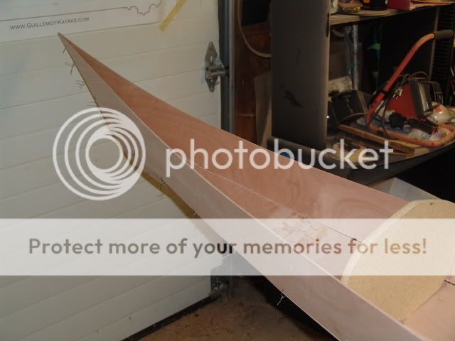

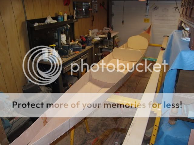

For those curious, here's the kayak that I started before this one but that's now on hold. It's a Stitch and Glue plywood hull and will have cedar strips for the deck. 18 feet long. The wood will be encased on both sides by perfectly transparent fiberglass. The result should be lighter and stronger than commercially available kayaks while being gorgeous. The only problem is that it will take a while to finish. There's another 400 hours or so left to get the result I want, compared to about 50 hours total for the skin-on-frame kayak.
This one, I used actual plans, purchased from Nick Schade of guillemot-kayaks.com It's the Hybrid Night Heron.

In other news, the frame of the skin boat has been completed, and I just applied two coats of epoxy to the plywood cross sections - I'm going to wait until tomorrow to varnish the stringers since it's 2:30 AM.
