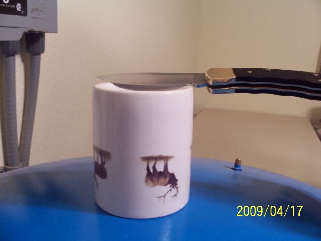

In a pinch cardboard will sharpen a knife.Wet it and put ashes on it and this does it better.No fire,no problem.Go to a stream or water hole find some fine silt or clay.Take a handful and put that on the flat part of a log and start stropping.You'll have a sharp knife while waiting for Turkey at the water hole.In the desert,pull your leather belt off lay it on a hard surface and start stropping. It will be sharp before the next coyote comes to your call.No excuse to ever be w/o a sharp knife.DM

I can't beleive DM left out the disclaimer about making sure the coffee cup is empty first! :) Another cheap tip is to use the cardboard backside of a yellow legal pad for a strop once you get it sharp. This really puts a nice hair popping edge on the blade. I like leather better, But this works too.
