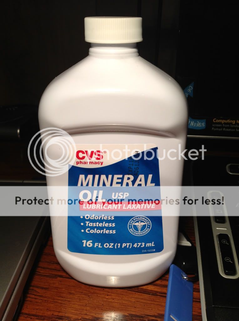

Just bought a bottle of that mineral oil stuff from my local drugstore
