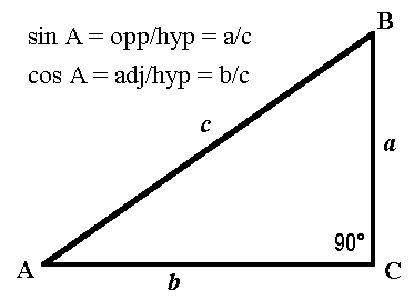

My fuzzy geometry knowledge is as follows. This is a triangle. The angle desired is 20 degrees. The distance of the edge of the knife I measured is about 11 cm. What I'm looking for is the height required (above the edge) to place the rod into.
This is tan(20) = height / 11 cm, which is tan(20) * 11 = height, which equals 4 cm.
Does this look correct?

I've been taking the lazy way out, and using a web-based calculator ( http://www.csgnetwork.com/righttricalc.html ). Plug in two known values, and it will calculate the rest of the unknowns. The image below is the model from that site. With the numbers you've given, 4 cm seems to be correct for the height (vertical side 'a' shown below). I'm assuming(?) the 11 cm distance is the 'bottom' side of the right triangle (side 'b' shown below), measured from the back of the clamp to the knife's edge, with the desired 20 degree angle shown as 'A' below.
Thanks, yes about 4 cm looked correct. It's slightly +/- depending on where you gauge the middle of the spine edge is. Unfortunately, the Lansky only has 5 degree increments and therefore it will be difficult to retain the original factory 20 degree edge exactly.
