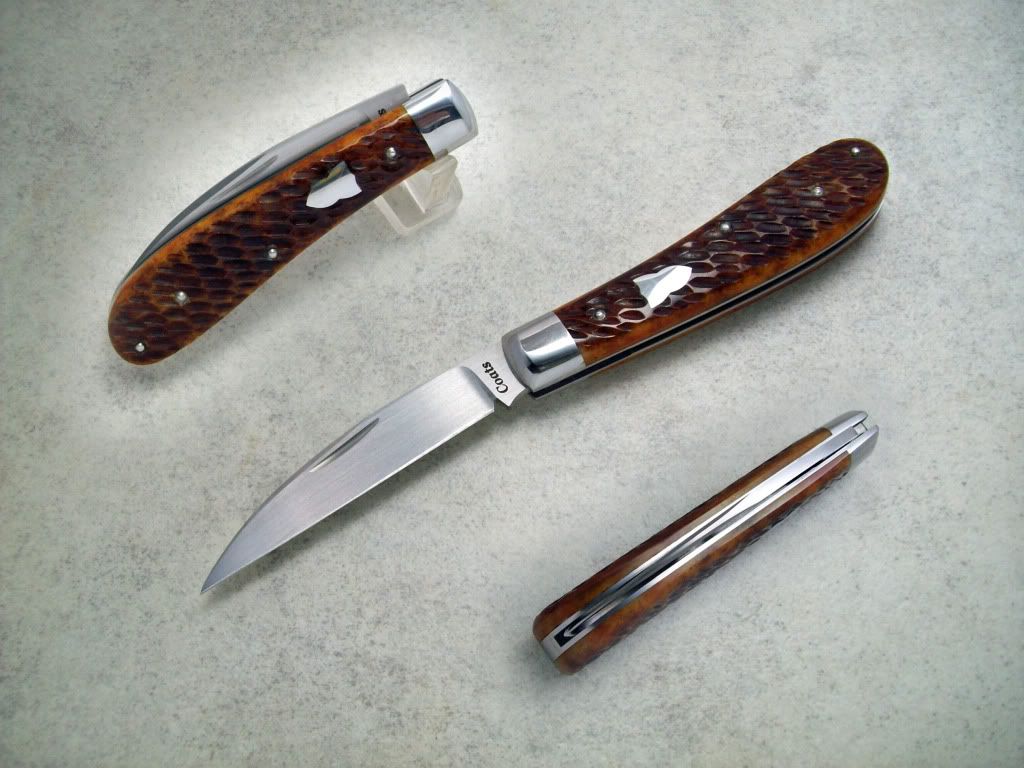

At the recent Guild show I got to ogle a knife made by Tony that belonged to Don Hanson III.
I was impressed by the fact that I could not see a line at the solder joint. With constant small
cutoffs from my integral milled frames I took another shot at it and am very happy with the
results. This does not mean that I won't continue to make integral bolsters. It means if they
are soldered I will tell you so.
Specs
Blade and spring Sandviks 13C26 Razor blade steel, Blade @ 61-62 Rc-cryo.
Blade has a 14' hollow grind, hand finished, drawn swedge, 3/32" stock.
Frame- Bolsters 416ss, liners 410ss mill relieved
Scales My dyed and jigged bone, crest shield is pinned.
Closed length 3 5/8", open length 6 5/8" Back is flush all 3 positions.
About medium on the pull scale with positive snap.
Crescent nail nick, blade lays dead center.
Specs
