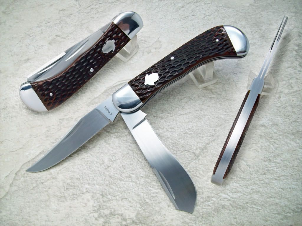

Here's another one I made for a forum member, Blades and springs 01, Rc-58
Frame 410 ss, liners and bolsters integral, Blades are hollow ground 400
grit hand finish. Master has drawn swedge, spey has a cut swedge. Some
of my dyed and jigged bone. Acorn shield is pinned. Comments welcome,
take a look.
Ken.

I think when referring to the swedge differences that Ken refers to this. Look where the swedge tapers off on the clip blade where the end feathers. On the spey it is cut down into the blade with a very distinct line or stop point for where it ends.
STR
Drawn swedges are done by pulling the blade (pointed down) up and away from
the wheel, cut swedges are ground with the blade held horizontal to the wheel
and running across the blade. Hope this helps. STR is right the cut has more of a
plunge line than the feathered taper of drawn.
Ken.
Ken.
Got it. Thanks for the explanation.
