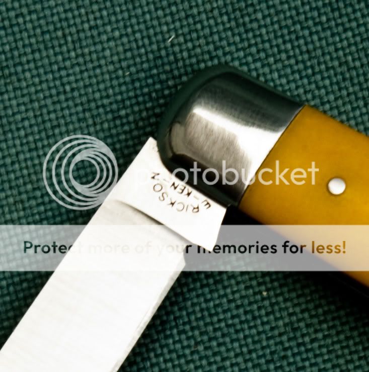

I think two stamps will be a necessity. I was hoping to get the smaller one worked out first. "K. Erickson" is a possibility. My stamp maker told me that this was the largest font usable and keep within my width parameters.

IMHO the new stamp looks really great. For some reason it has a very old school look appearance to my eye. The only change i would make is to somehow "attach" the "N" a bit more to "ERICKSON".
Looks great.
Rick
I like the curved stamp, and since I know stamps aren't cheap, I see no problem with you using it the way it is. Use that one for a couple years or so and get another one. The example you show there is stamped pretty lightly so I would put it back on the bench and whack it again to make it a tad bit bolder.
Rick
To me the N , being spaced a bit far almost could be mistaken for a Z. Good eye Rick!

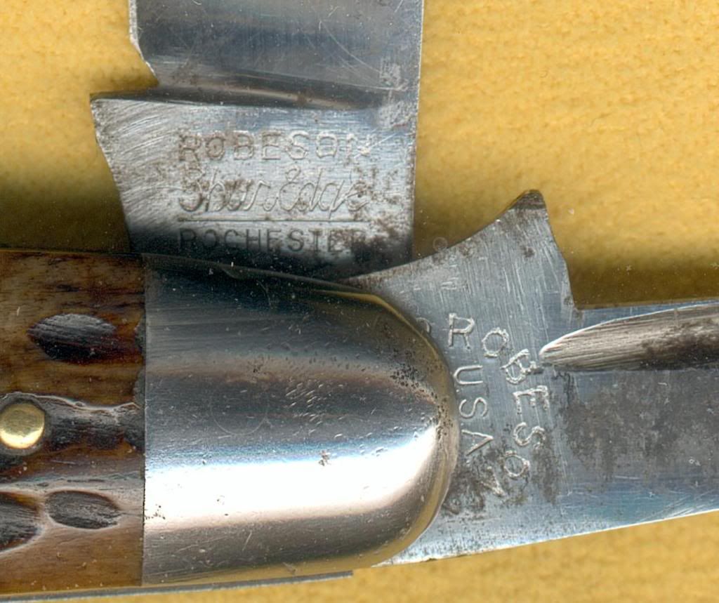

Sometimes, Ken. But secondary stamps varied considerably.
Case used stamps that were considerably different from the main stamp, as did many cutleries. Some cutleries put a different stamp on each of four sides of a two bladed knife!!

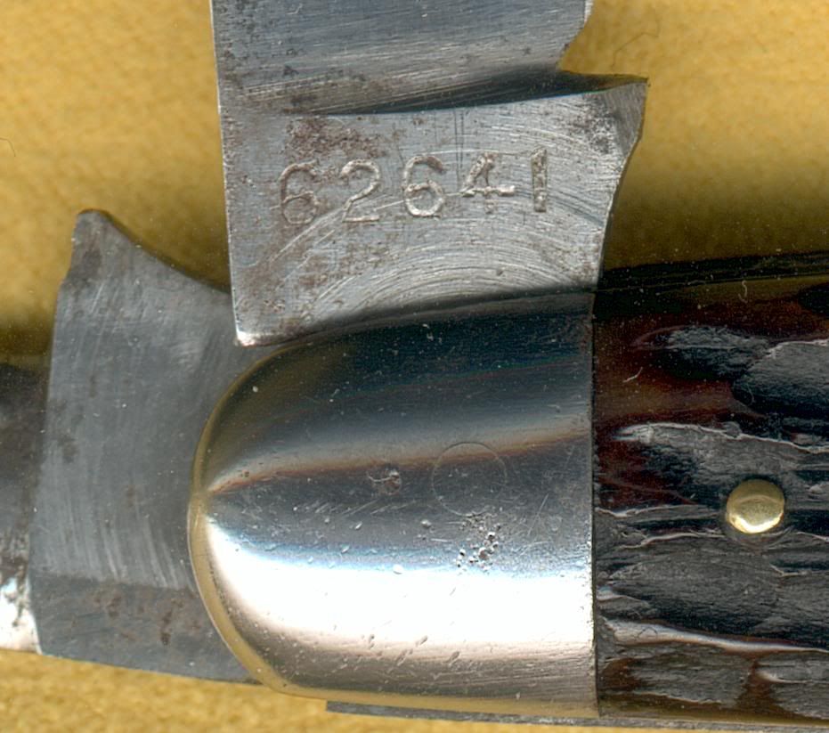

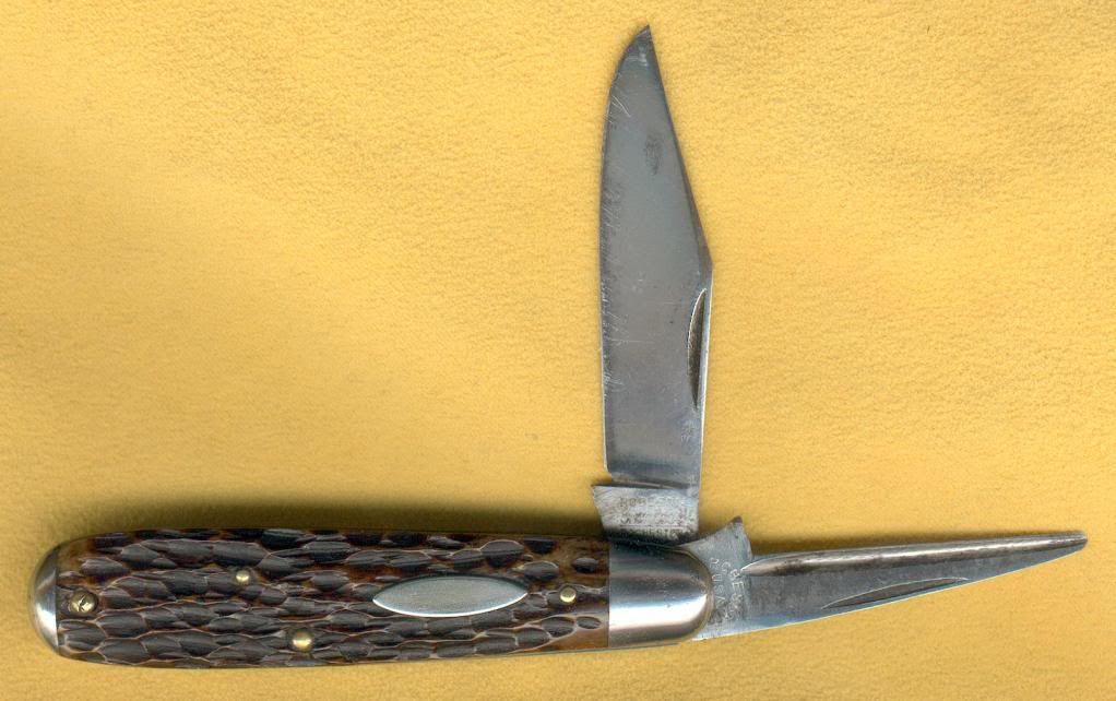

Here's a Robeson HJ with two different stamps. There is also a pattern number on the back of the main.

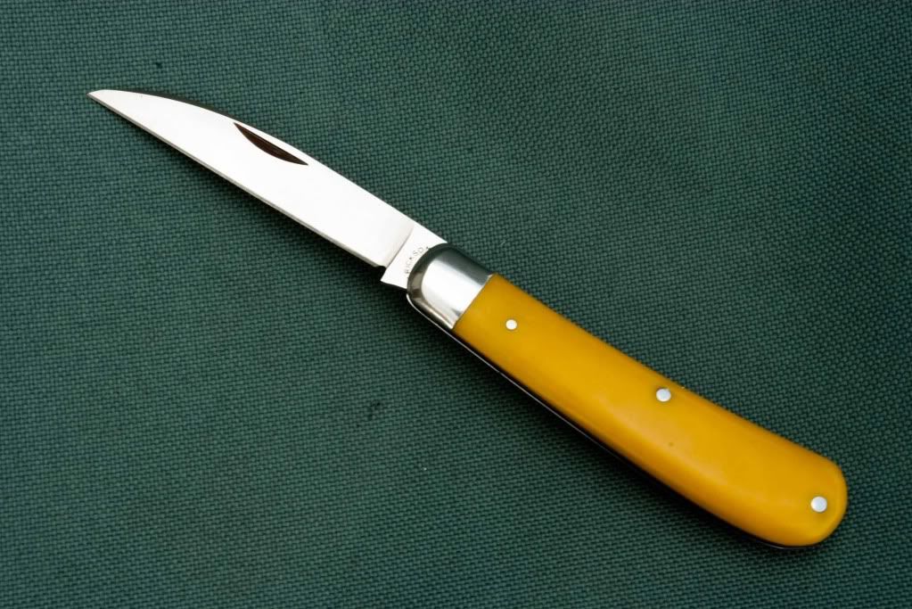

I did go ahead and finish the knife today using the first stamp. This knife is NOT available but I thought I would share a few pictures. Sorry for the quality of my pictures of late. My light box is completely unusable at the moment.
Ken
3 5/8 swayback
Really nice butterscotch/yellow paper Micarta.
ATS-34 blade and spring
guys, you're gonna make me buy a swayback DAMN
all look nice and useful, the upswept handle is somehow, strange and that's the nice part of it
Maxx

I actually did what Kerry had suggested. Put her back on the bench and wailed away at it. In hand it comes across much better than the photos convey.
