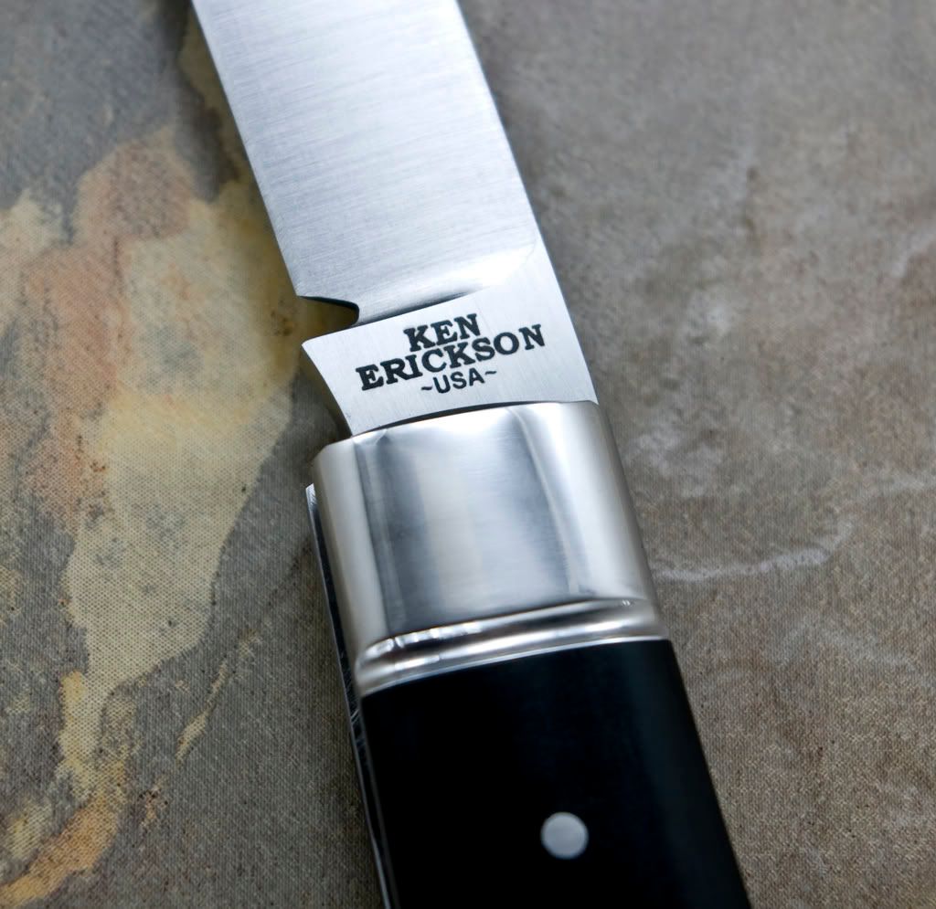

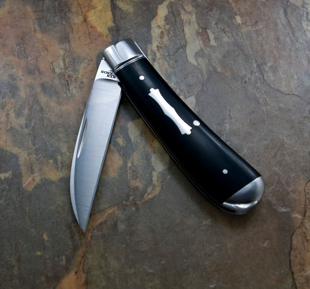

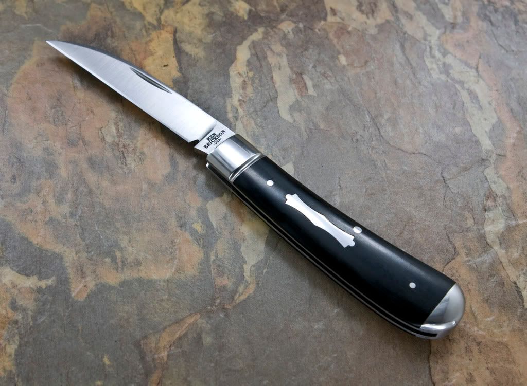

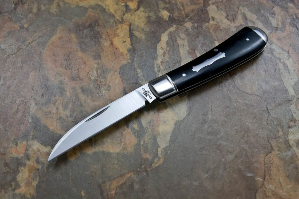

I finished this 3 5/8 swayback up for a customer. This is the first use of my new mark. Any suggestions or comments more than welcome. I think most makers and manufacturers have had a progression of tang stamps or marks. I am sure this one will not be my last. Those of you that are familiar with my past work know that my mark said simply ERICKSON
Specs on the knife.
3 5/8
ATS-34
black paper Micarta
410 one piece milled relieved frame/bolsters
"gimp" shield double pinned
Thanks for looking!

Stunning work on that swayback.
As far as the mark goes ...:thumbup:
Ken, as always your work is stunning.
Really like the lines on that knife.
That should make the perfect gentlemans pocketknife.

Whoever ordered that knife is going to be real pleased,it came out fantastic.Your knives are really gorgeous.I like the finishes on the blade & bolsters,beautiful well proportioned shield & I don't know what you did with that micarta,but at a glance it looks like ebony wood,so on this knife you get the performance of man made scales,too

I like the knife a lot, Ken. Have you done that one with the tip bolster before? Looks great!
The mark looks like a laser etch. How do you make it black??
I also like it, but, stick in the mud that I am, prefer the old looking type mark, more simply stamped into the steel.
Well done. The knife is a fine example of your work. The new mark looks more complete with your first name and it's always good to say USA.
I have to say I like the old mark better. Your knives are elegantly understated, and do not need decoration to look fantastic. You don't need to say much on the tang either. JMO, but I think the old mark fits that image better.
Anyone who knows knifes will always know whose it is with just ERICKSON on the tang.

Thanks for ALL comments and suggestions so far. Charlie , I use the electro-etch process. At times the mark will come out blacker than other times. Eventually I want to have a stamp made up. I agree its more old school. I want to be sure and settle on what I want my mark to read before the expense of having a stamp made. This is also the first 3 5/8 swayback's that I have done with tip bolsters.
Ken
By the way , thanks to Ernie Grospitch , a forum member for making the stencil.

Ken, I think your new makers mark is good. The knives that wear the mark are outstanding. I'll get lucky one of these days. ;-)
Ken, I've long admired you knives. To me you are a master of simplicity and clean design. Your lines are deliberate and not excessive; you take basic shapes and work wonders with them, without adding unnecessary frills.
Your blades and handles, to me, have a kind of living quality about them. No only do they look like they were designed to go together, but each also has a kind of life-spirit about it. For example, you get the nail nick placement just right, and the angle of that nick. They evoke eagle's heads, hawk's heads, and other animals to me. Each nick just works with the profile and grinds of the blade. That's just one simple example of how your design elements come together in a way that looks just right, in a way in which each element doesn't compete for overall attention, but each contributes to your greater overall vision for that particular pattern.
The thick black letters of your latest maker's mark take away from that. The busy-ness draws my eye away from the simple, straightforward beauty of the knife itself. A stamp would be an improvement, or better yet, a simple symbol (that those other guys' fish or "D with an arrow" symbols--understated but meaningful). Clean, understated, and not competing for visual attention with your masterful, overall design. [If you decide to stick with this lettering, I'd suggest reducing the kearning on the "I-C" and "O-N" letter combinations].
