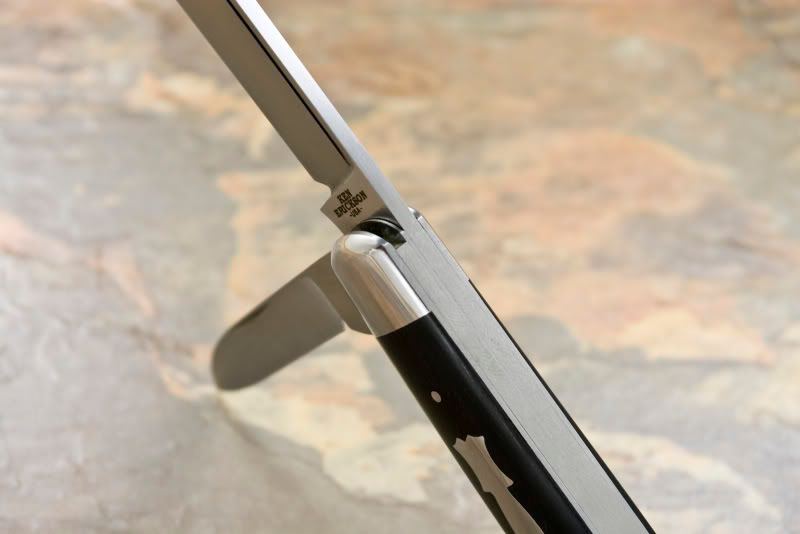

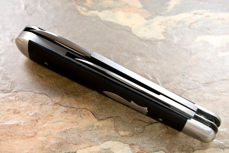

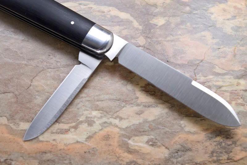

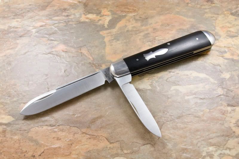

I made this jack up at a forum members request but thought I would share some pictures of it. I REALLY enjoyed making this one up. I was shooting for the vintage look. This is a lot of knife, a tad over 4 1/8 closed and 3 1/2 oz.
This jack is also the first use of a double pull on the master blade for me, long pull along with standard pull just below the cut swedge. Hope you enjoy looking at the pictures as much as I enjoyed making this one.
4 1/8 closed
CPM154 CM blades and springs
Spear master , cut swedges dual pulls
Secondary blade modified pen with cut swedge on pile side
Ebony scales
modified bomb shield (My take on a vintage Ulster) pinned
410 integral bolsters/frames
extension spring for secondary blade
