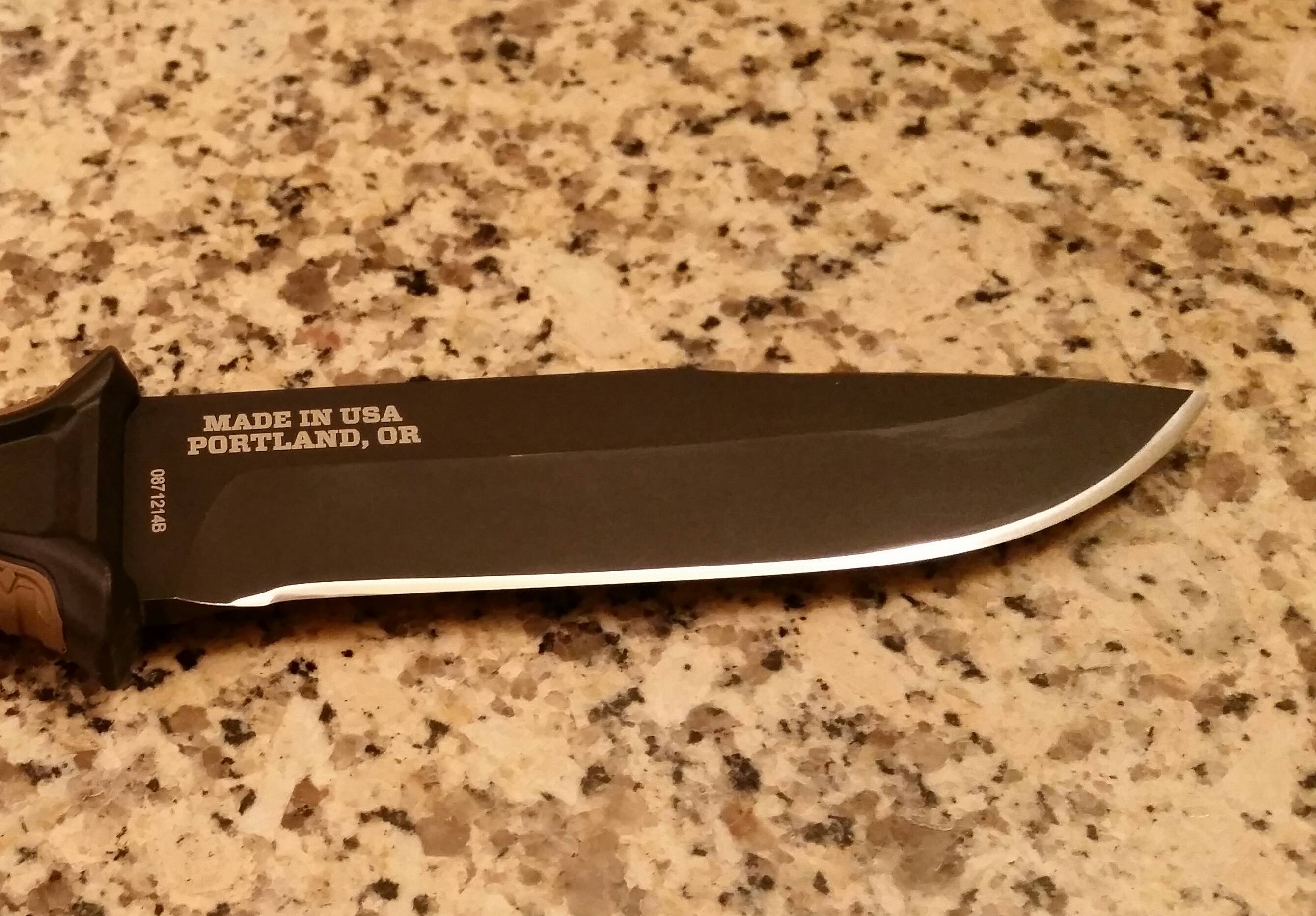

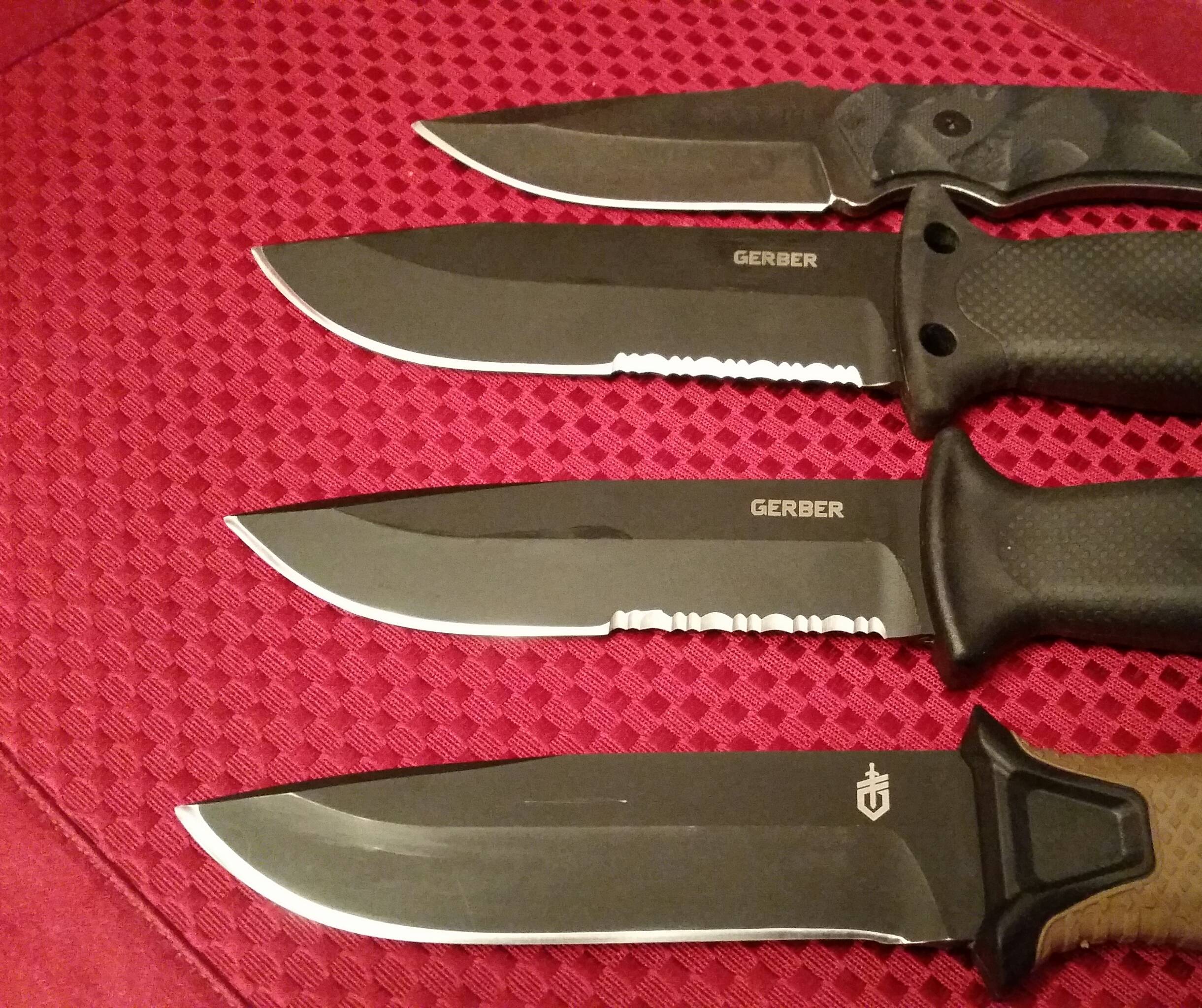

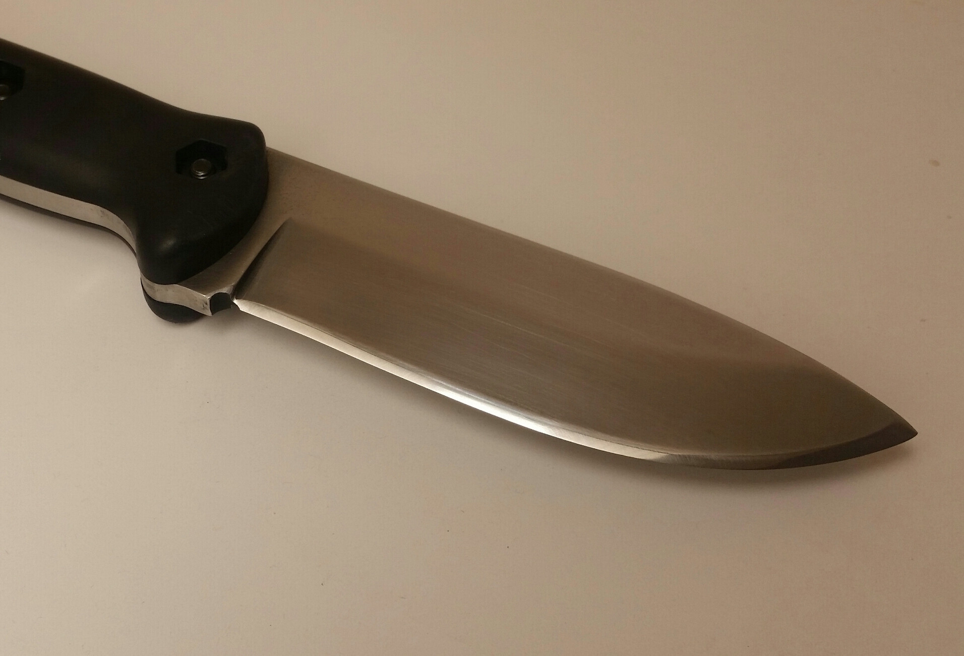

Here's a few I've done with wskt-ko
the bk2 I originally set my bevel with the wskt-ko then used the mouse pad method finish it up and maintain it.
