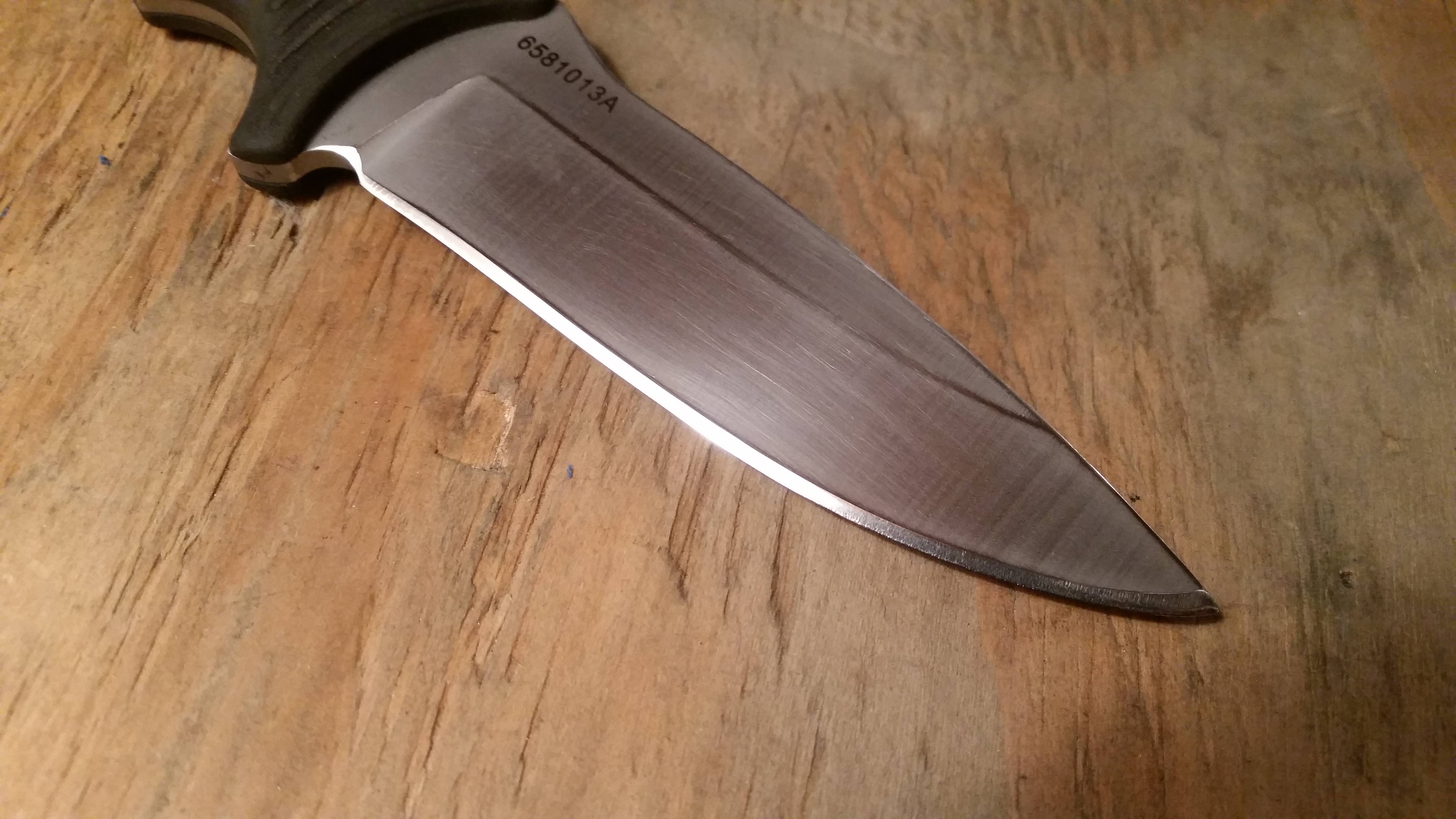

Yep. If you're not careful, it could take the tip off in one pass.
The instructions explicitly warn of this.
Specifically, STOP ON THE BELT AND LET GO OF THE TRIGGER!
It's really the only rule that has to be followed very closely no matter what.

The few things to watch with the tip are pulling the tip out instead of stopping it middle belt and also lifting the handle to far up when approaching the tip. Both will blunt your tip. Also you gotta start pulling as soon as you turn the machine on, any delay could result in a recurve over time.

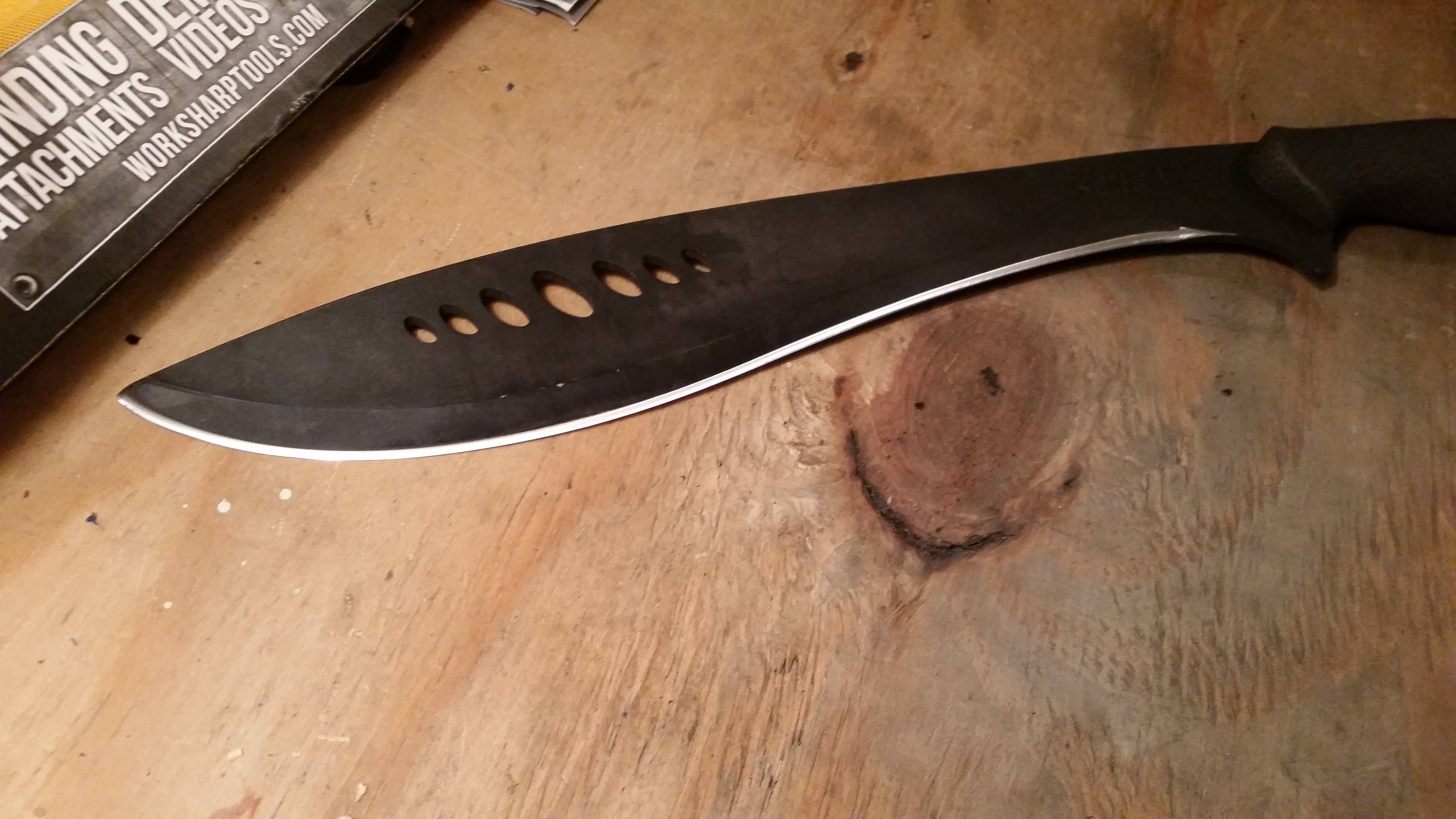

It's also not limited to just knives. It makes sharpening machetes, axes, lawn mower blades and whatever else a breeze.
How long would you spend sharpening a machete? With this machine 10 minutes tops

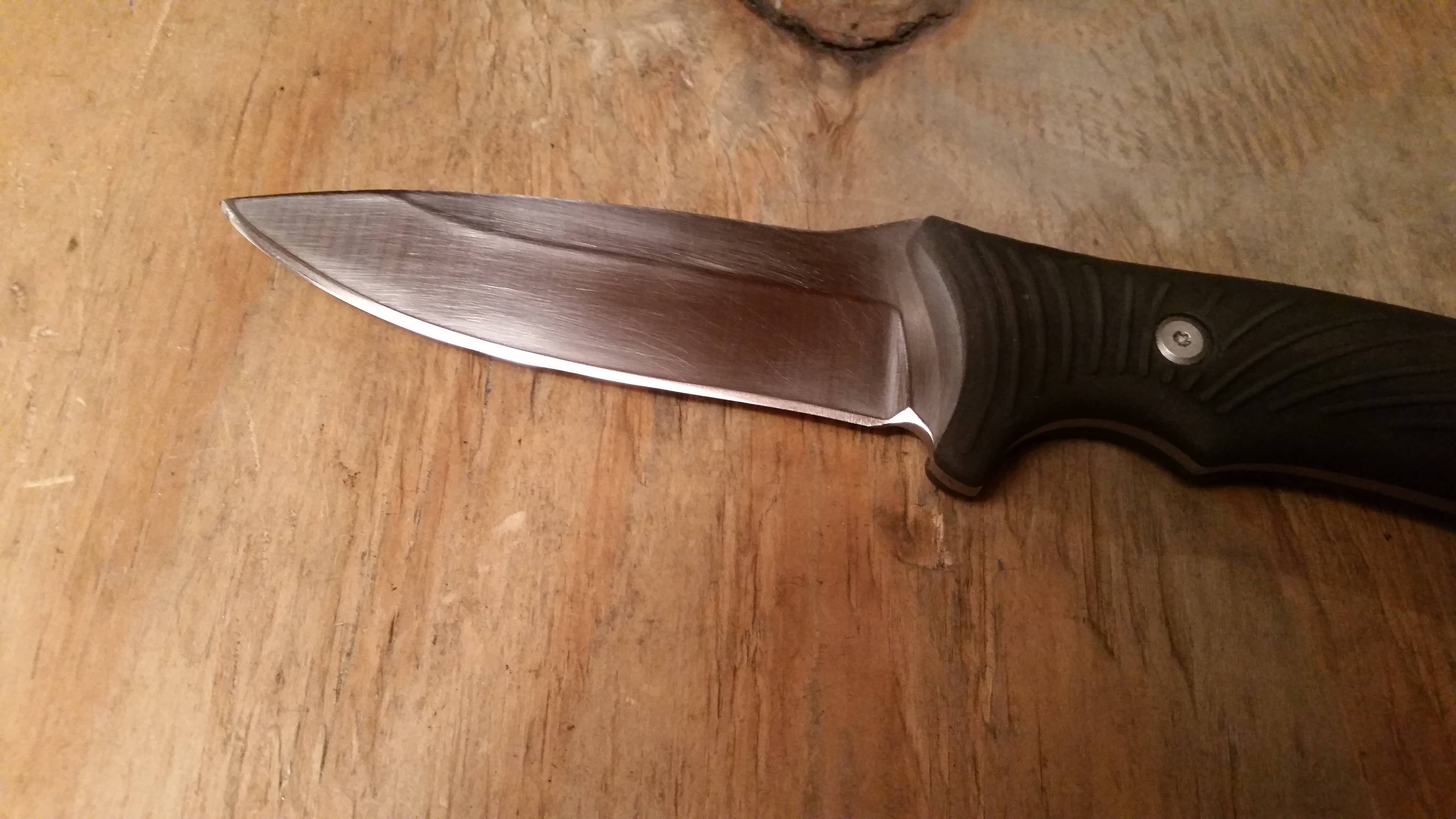

I was also able to turn this pos mystery steel Gerber into a good useable knife. I was able to completely reprofile the knife in minutes and now it has an edge that holds up really well with allot of hard use (it's my go to beater knife for things not worthy of a bk2). Since reprofiling I've only had to strop it a lil and it's razor sharp again.
