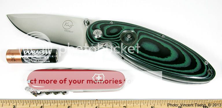

Size comparison to my two most recent reviews -
Top: Enlan Bee L01-MCT and Bottom: Mcusta 113D - "Tsuchi" (links to respective reviews)
How about some that are closer to the same size?
Chris Reeve Large Sebenza -
the nearest I have -
Top: Kershaw JunkYard Dog II (link to review) and Bottom: Benchmade 710 Axis
Sizes closed -
OK I think you get the idea - the handle is massive -
it is 5" closed, at 1 9/16" wide and 15/16" thick (not counting that protrusion) -
(blade is nicely centered)
the rest of the measurements are 3 3/4" blade length (I know the specs say 4" - but I measured 3.75") and measured 3/16 thick (vs 0.170" spec)
and it weighs in at a hefty 7.6oz - that's nearly 1/2 lb!
compare to large Sebenza - 4.75oz, BenchMade Axis 710 - 4.32oz and the JYD2 - 5.77oz.

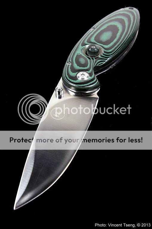

Opened -
everything is nicely aligned
Lock up is solid -
that button protrusion presses out an internal release bar that depresses the substantial locking liner to allow the blade to close.
once the blade has been initially/partially folded - have to release the button -
otherwise the internal release bar gets in the way of the blade closing.
One of the main features of this BGG knife is the convex grind/edge - it is continuously convex -
zero bevel (ie: without a separate edge bevel) which makes cutting through things great - and the knife is really, really sharp.

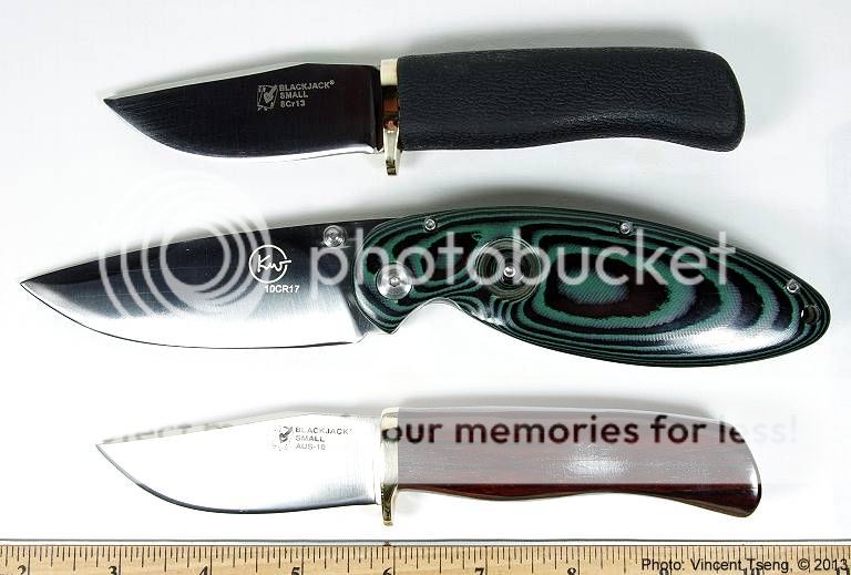

Some relevant knives - these are the KnifeWare BlackJack smalls -
the Cocobolo AUS-10 Seki, Japan, and the Kraton in 8Cr13 made in China
Effingham, Il BlackJack Trail Guide with Dymar handle
Effingham BlackJack AWAC bead-blast finish - I think a special for Cutlery Shoppe - one of the few knives that did not have a convex edge -
it was so obtuse that I sent it to BlackJack for re-profile and re-sharpen with a convex edge.

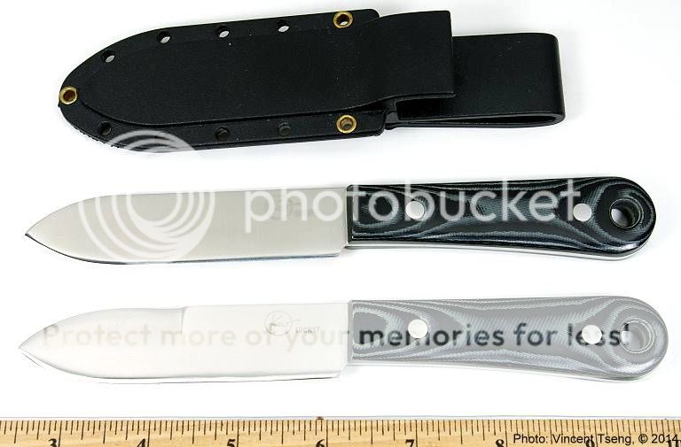

BTW -
pictured with the BGG and SAK is the Ken Warner Utility fixed blade (with great hard plastic sheath, leather is also available at a higher price!)
also in this 10CR17 steel - shown is the semi-double edged version in gray/black Micarta -
but single edged is available as well as green/black Micarta
and if you thought the BGG was whoppingly priced -
I got this KW utility for all of $11 delivered.
Do a search on "Ken Warner knife" at the auction site then sort price low to high...
