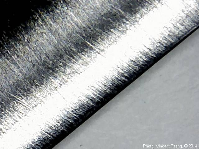

I am a bit surprised that you thought both the fixed blades had obtuse edges.
My KW03 single edge gray/black Micarta had a few flats on the edge -
so I ran just that part of the edge over the Work Sharp Knife & Tool Sharpener - Ken Onion Edition -
I use a "guided freehand" on this sharpener - which is merely holding the blade vertically to the belt
The belt is at 17.5deg - and allowing for flex the resultant edge is about 20deg per side -
this is very acute for an outdoors knife - 20deg is the usual acute angle for good Western kitchen knives.
After the sharpening to remove the flats - usb microscope pic at approx ~110x magnification
The resultant sharpened edge was almost indistinguishable from the parts that I did not sharpen -
so the original edge had to have been about 20deg per side too.

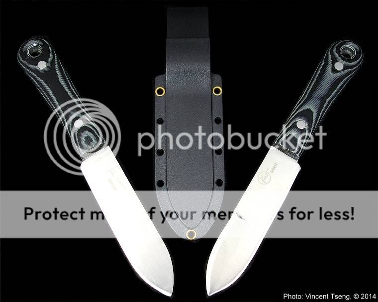

Ken Warner Utility - left -KW03 (single edge); right -KW04 (semi-"double" edge) - both gray/black Micarta.

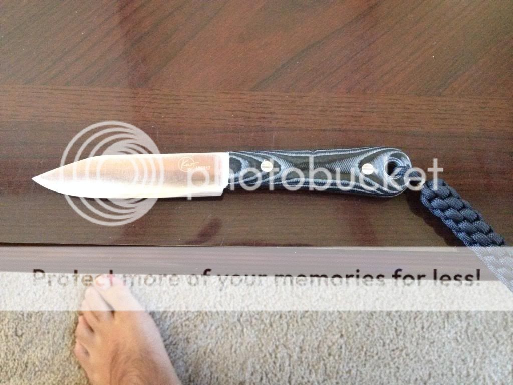

I just wanted to throw in my two cents on the blade steel. The website says it's equivalent to 440C and I feel that is pretty dang close. I have the fixed utility version and I use it daily at work for cutting open boxes and tearing down cardboard. The edge holds up fairly well to that kind of abuse. I like the sheath too. I'm left handed and the sheath is ambidextrous so I didn't have to make one :) I also didn't really care for the tip shape so I ground it down into more of a drop point. All in all, I'm very happy with this knife and the steal quality. I also reprofiled the edge to about 15 degrees per side. Its a real slicer. It's a great bargain and I would recommend it to anyone looking for a budget blade that will hold up to some abuse.
Nice mod. :thumbup: I love the sheaths on these too. The combo of ambidexterity and the pocket clip mean I can carry the knife clipped inside my right front jeans pocket just like a folder yet have the edge facing the correct direction. A future project I have in mind is to mold up a few similar sheaths out of Kydex for some of my other smaller fixed blades. :cool:
