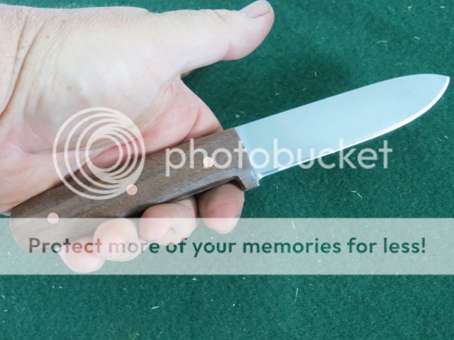

I wanted to try and make a Kephart knife very close to the specifics that Horace outlines in his writings. This is what I came up with.
I'd never handled a Kephart before making this one. In his writings, Kephart noted that his knife was homely looking. I had to agree. But once I got it made and started handling it, I couldn't believe how such a simple design was so comfortable and easily controlled. Needless to say, I nearly kept this one and you can bet I'll be making more from now on!

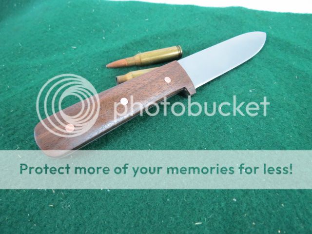

I chose Premium American Black Walnut for the handles. I thought about a lot of different woods to use, but couldn't think of anything more American to put on such an iconic knife design!

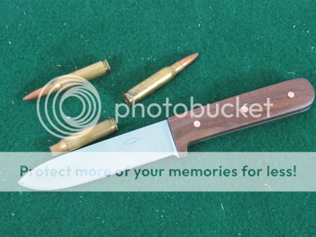

Here's the specs:
Steel: 1/8" Aldo's 1084 High Carbon Steel (about .130)
Handles: American Black Walnut
Hardware: 3 3/16" Copper Pins
Blade Length: 4.5"
OAL: 9"

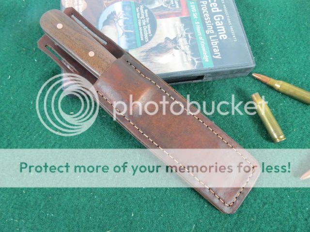

Includes a premium leather sheath made in the Kephart style.

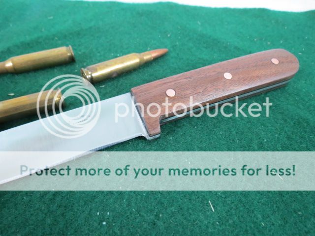

It's amazing how the KISS principle really works out. Such a simple design, but 100% functional. Your Kephart looks good. About the only suggestion I would dare make is to round off the finger guard just a tad. Great looking knife!
Very nice, I too would say the only thing needed was to round the handle on the underside by the guard.
Thanks for the kind comments guys. I nearly did round off the "bump" but from the pictures and drawings of some of the original Kephart knives I saw, they were nearly 90 degrees. After struggling with getting the bump at right angles, I agree, the next ones will be slightly rounded! It's a lot easier grinding in a slight radius than trying to keep that right angle!

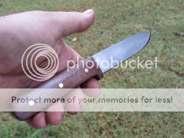

It's still amazes me how good this knife feels in the hand. And that 1084 steel is a workhorse. I made about 100 cuts into a Red Oak board and it would still shave hair afterwards. Love this stuff!
