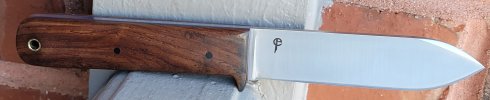

Good Afternoon,
Here is another Kephart according to the dimensions given in Horace Kepharts book.
From Camping and Woodcraft by Horace Kephart
“Its blade and handle are each 4 ¼” inches long, the blade being 1 inch wide, 1/8” inch thick on the back, broad pointed, and continued through the handle as a hasp and riveted to it.”
“The handle of this knife is of oval cross-section, long enough to give a good grip for the whole hand, and with no sharp edges to blister one's hand. It has a ¼” inch knob behind the cutting edge as a guard, but there is no guard on the back, for it would be useless and in the way. The handle is of light but hard wood, ¾” inch thick at the butt and tapering to ½” inch forward, so as to enter the sheath easily and grip it tightly. If it were heavy, it would make the knife drop out when I stooped over. The sheath has a slit frog binding tightly on the belt, and keeping the knife well up on my side. This knife weighs only 4 ounces. It was made by a country blacksmith, and is one of the homeliest things I ever saw; but it has outlived in my affections the score of other knives that I have used in competition with it, and has done more work than all of them put together.”

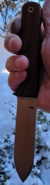

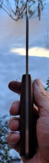

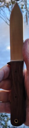

This blade came out very close to this description. The only deviation is my construction came out at 5.5 ounces instead of the listed 4 ounces. The tang is skeletonized and fullered so the only thing I can figure for the additional 1.5 ounces is the density of the wood. Kephart describes the wood as hard but light but doesn't list the wood type. In this construction I used cocobolo which is very oily and dense so that is probably the additional weight. The book didn't describe the small false edge on the top of the spine but a picture I saw of an original Kephart from a museum had it so I included it. The spine is also a crisp 90 degrees for the rest of the length.
Because of the symmetrical shape of the knife and handle I was able to make the leather sheath ambidextrous and included the split frog type belt loop as described in the book.
Not sure if it is just my computer screen but the sheath looks a little purple in the pictures. In person it is a navy blue color and is pretty close to the blue liners.
