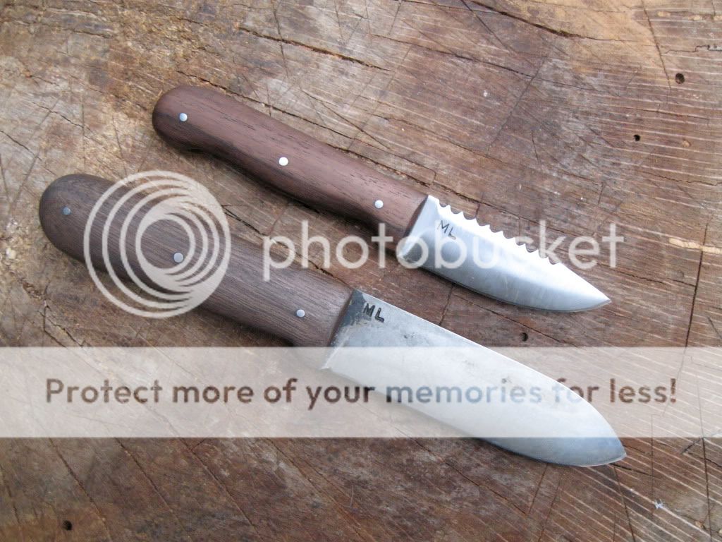

My ML Keppie is definitely one of my all time favorite knives.
I've used it continuously for about four years.
I might slightly tweak it here and there but it doesn't really need it.
I think it is pretty close to original dimensions.
It has a pretty fat handle and I love the round butt.
I understand about wanting to change the butt end when designing a blade ....... the aesthetics aren't that pleasing but it feels great in use.
Maybe adding a flat to the front of the scales near the plunge line would help with thumb comfort in the chest lever grip ....... but that would depend on scale thickness to an extent.
To me it's a great all around design.

To be fair I've never owned a true Keppy but the tip/point has never really done anything for me. I like more of a point to my blades. Something like the ML above with a more gradual belly and pointier tip and it would be a lot more attractive to me.
