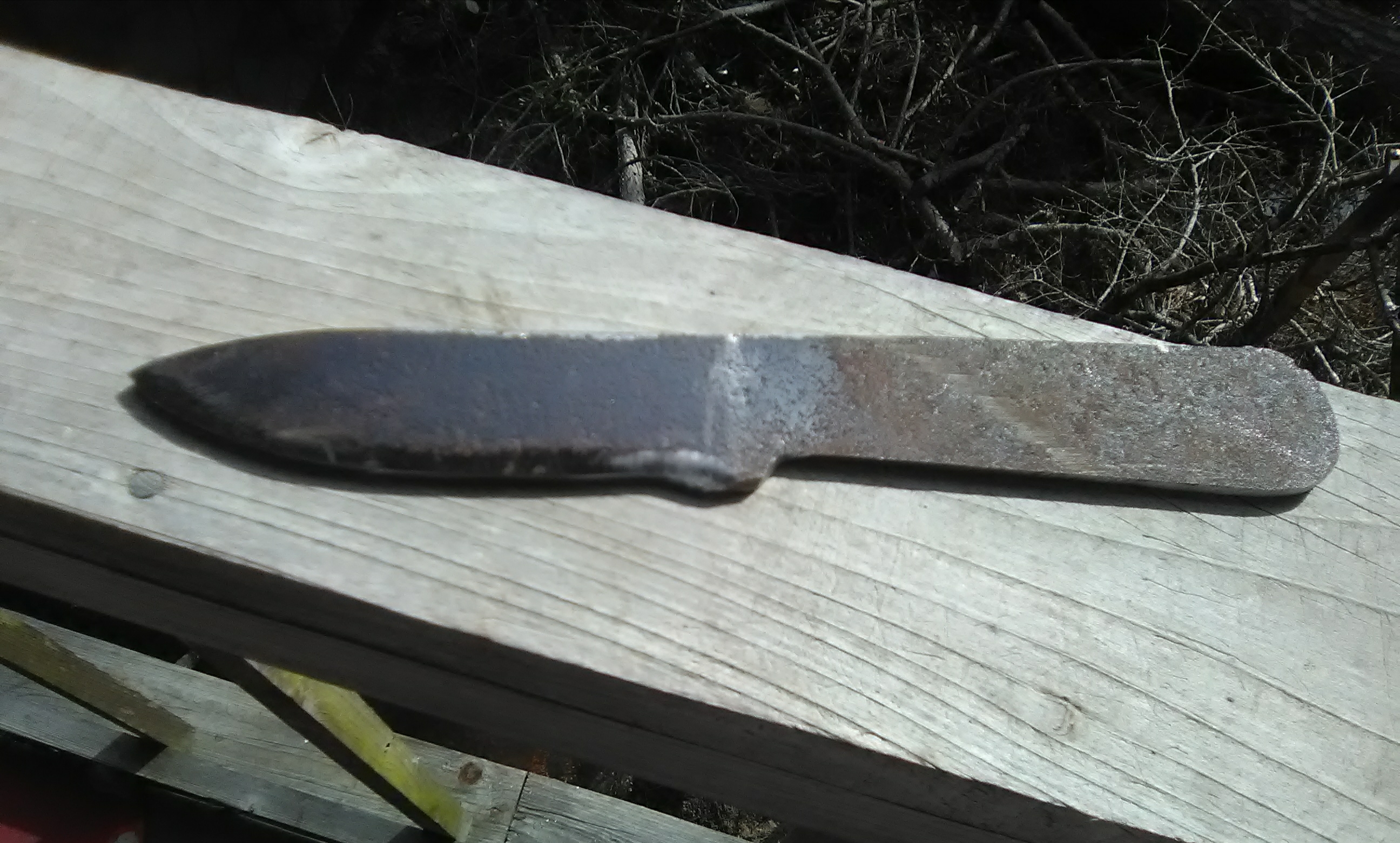

Just so we keep the thread on topic and Kephart related, I have been inspired to make a Kephart from an old sawmill blade. Blade is probably 70 years old.
Cut and shaped with an angle grinder.
I need to get some grinding belts for my HF belt sander, and build a heat treat forge, which shouldn't be a problem with all the info available here on BF.
Excellent! Look forward to seeing this one progress! :thumbsup::thumbsup::thumbsup:
