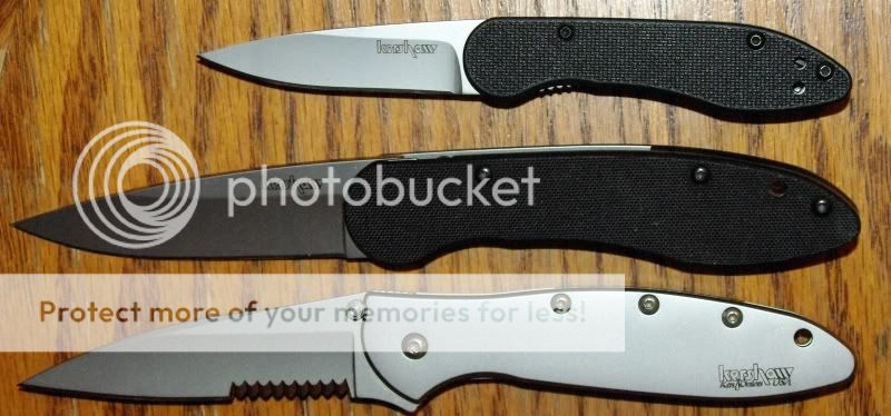

I own a Shallot and I have to disagree with some of your statements.
I don't think the fit and finish is awesome. It is good. And adequate considering the price of the knife.
I like affordable knives (Trance, Drifter, Xikar Explorer, Victorinox) and the Shallot is my most expensive knife. But the fit and finish is not as good as my other (much) cheaper knives, with the exception of the Buck Colleague.
Also in my opinion the handle is to slippery for an automatic knife which opens with such force, which you did mention.
The knife is indeed larger then you would expect and you didn't mention the very high riding clip. If I wear it a big chunk of steel is visible to everyone. Not suitable for an urban office environment, at least not where I live!
But I guess people can see that from the excellent pictures you took.
My shallot just arrived - man, your review was spot on!
The lockup on this thing is really tight - I usually end up having to tighten pivot screws a couple of degrees out of the box on assisted knives to get them to where I like them, but this one is perfect.
Blade centered, grinds are immaculate, and it's much more comfortable in the hand than I imagined for such a funky looking design.
Anyway, thanks again for the review, I think I'm really going to enjoy this blade.

Maybe I should have put in the original review what 'fit and finish' means to me... On my knife, all of the edges were nicely rounded and contoured. The screws were all seated correctly (none were proud) and none of them were stripped. There were no spaces between the backspacer and the handles, and the finish over the entire knife was consistent. The blade grind was perfect with the edge bevel being consistent side to side and along it's length. There were no tooling marks or manufacturing relics anywhere on the knife.
I'm glad you responded and made me realize that I should have probably defined my terms. I'm curious if your Shallot and mine differ, or if it is our preferences... either way, thanks for taking the time to reply!
Oh, nutbutter. :foot: Gotta correct my earlier statement: after a bunch more searching I've found that the grinds on my Shallot aren't exactly even. The grinds that form the 'swedge' on the spine of the blade, to be exact. It took me a while to find it, but it's definitely there...

OD -1 and OD – 2
I Love these knives. LOVE THEM. The OD-1 is a frame lock knife with one G10 scale. It opens via a ‘flipper’ that is mechanical, rather than being part of the blade. It is hard to explain, but in practice it opens quicker than my Kershaw AO knives. Once open, the little flipper ends up in a recess in the spine of the knife, out of contact with your hand. The knife is drilled for tip up or down, right handed only carry. The 14C28 blade was shaving sharp out of the box (that is the case for all of these knives) and was perfectly centered when closed. Closer look under the clip revealed a frame-lock stabilizer, which is a nice touch. My only concern with these knives is that there is no extended tang, flipper, or choil to keep your hand from sliding up onto the blade if you were using this knife in some extreme manner. It won’t be an issue for me as I don’t routinely stab things, but I did notice it. Also, in the frame cut between the lock and pivot, there seems to be precious little metal... I wonder about strength at this point, but we'll see. Not a deal breaker for me.
The OD-2 is the little brother… it is a liner lock with two G-10 scales. Same opening mechanism, drilled for tip up right or left hand carry. It is made in China, and the blade is 8cr13moV, but the knife is put together very well, the liner lock seems good, there is zero bladeplay. I have no issues with it. It is what I would consider a ‘pretty small knife’.
OD-1

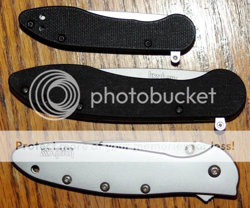

BTW, can you post a pic of the OD-1 and the OD-2 open next to each other so we can get an idea of the size difference?
I can indeed... I'll put some up tonight when I get home. I agree with you that the OD1 is an improvement over the M16. I've had a few M16's in my day, and the Kershaw offerings are higher quality all the way around, IMHO. I've never had a problem with tip up carry, but if I ever do I'll probably change them all back to TD. Once bitten and all that.
