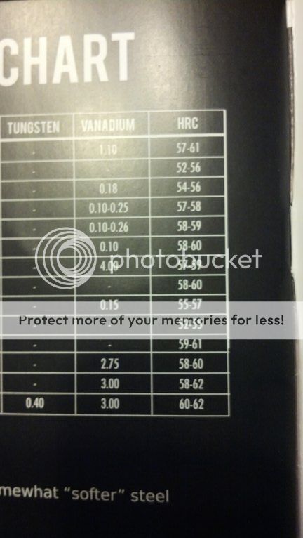

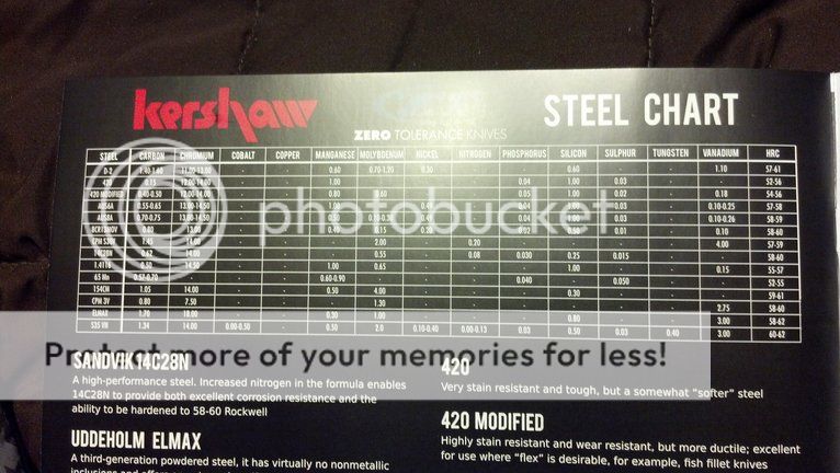

looking for the rockwell hardness of those 2 steels as done by kershaw.

I can only speak for the only Kershaw I've had Rockwell tested, and it's the CPM-154 blade on my CF Blur. It's at 60.2. That's fine for me, it's not too soft to not take advantage of the powdered metal toughness, still easy to sharpen. The catalog and website give the 58-60 rating for their 14C28N blades, so it's in there. S30V I'm not entirely sure, so I won't hazard a guess. However the S30V that I've used that comes out of Kershaw and ZT is usually pretty robust in terms of long-term edge retention without maintenance. I'd imagine it's right at 60 in the knives I have, but unless I get the blades tested, I can't say with any real certainty.
For regular use, it kind of depends on your abilities as a sharpener, the time you have, and your maintenance practices. Personally, I try to strop my knife every couple of nights, sometimes each night if I'd done some real cutting or wire stripping/deshielding with it. After I reprofiled the edge down to 16.5 degrees per side, I was able to maintain it at a phone book paper slicing sharpness with that for about two months. Last month, I did a few swipes per side on a Sharpmaker's fine stones and it was razor sharp again.
So, if you are the type to maintain, then the 14C28N will be great. It sharpens very very easily, and takes a fine edge with little work or fine grit polishing. S30V is a little (and I do mean a little) bit more involved to get the same sharpness. S30V will shine if you don't really do that kind of maintenance, and you want to keep cutting after it loses the razor sharp edge. It'll develop a toothy edge that still cuts very well despite it not feeling like it can pop hairs.

all you gotta do is contact KAI through the website and they'll send you a Catalog with this in the back, very handy to have!
I think CRK has the same numbers. Tough blade but doesn't hold its edge particularly long. It's a balance.
Thanks, Chester...good reference material. I think I'll get a catalog.

I have been looking for that chart for a while thank you for posting
