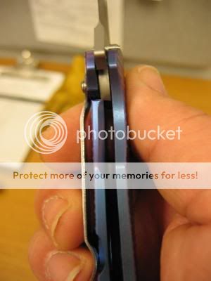

The lockup on the blue is poor, only about 0.5 mm of contact, but I've contacted Kershaw and they are going to fix it for me. Otherwise the framelocks seem strong enough without any blade play.

Here's a pic of the Bump lock. It doesn't engage as much as I'd like to see.
Yes, Yes! Same deal here with my first generation Bump - poor framelock engagement. Just email Kershaw Warranty (under Contact at their website). They will be happy to fix it for you. Below is their recommendation:
"On the Blue Bump, try "slamming" it open a couple of times. Sometimes this
will get the parts to settle in and the lock will engage more. If not, we
will be happy to fix it for you. Just send it back to us with a note and we
will take care of it."
How the heck do you "slam open" a Bump?
My second Gen Bump has a much better lockup. Maybe this was an issue with the first Gen production run???

TOB9595,
Thanks for the picture of the lockup. Looks good to me because there is plenty of room for wear - so long as the lockbar is secure against the back of the blade, all should be well.
1/3 of the base of the blade is about what the Mayos seem to cover and I feel confident with their lockup.
The pic of the lock seems to have turned me off to this knife, unless with some wear it starts to engage much more than is shown?
You might find Tom Mayo's posts and those of some other people in the Buck forum interesting. The Buck Mayo has a lockbar that doesn't come that far over on the base of the blade and there were some threads expressing and addressing that concern. These threads are dated around when the Buck Mayo folder came out last year.

BTW, the lock up issue is improving with my first gen model. I've been carrying, using, and working with it and I do see better engagement - acceptable now :D.
