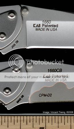

Slightly more enlarged details of the markings on the knives -
The all steel Leeks are Frame-Locks -
This CB sample is almost ideal - covering just more than 50% - slightly more than my other frame-lock Leeks.

The Composite Blade Leek is flat ground (the regular Leeks are hollow ground) on my sample of one the blade is rather thick toward the bevel/cutting edge.
So I decided to put convexed edge on the blade - by honing away the distinctive step/corner between the blade face and the edge bevel.
Please see -
Convexed Edge
where I put this edge on a SAK.
I used an EZE Lap fine diamond hone to work the bevel, concentrating mainly on getting rid of the step/corner to the edge bevel.
Because one of the main attractions of this CB Leek is its looks - I protected the face of the blade with some Scotch tape - exposing ahout 1/8" at the edge.
As the edge part of the composite blade is CPM-D2 - and D2 is a hard tool steel I was expecting a bit of work - but was very surprised by how quickly I was able to cut in the new convexed bevel.
I was able to feel the burr on the edge - and went to finish the blade on a pair of fine ceramic crock sticks for the final micro bevel edge. The blade certainly felt sharp on slicing paper.
On examining the blade edge under a 30x illuminated microscope I found that on one side of the blade I had retained most of the original bevel really only removing the step/corner to that bevel - and to my surprise I saw fold-over at some parts of the edge - surprised because D2 is supposed to be pretty crisp when hard and resists fold-overs.
I worked more on that side of the blade and honed more away - so that under magnification almost all the bevel is now newly honed. Again finishing with crock sticks for the final micro bevel edge - this time under the microscope I did not see any fold-over.
the legend side was where I initially only partially put a convexed edge on the blade leaving some of the original bevel - and perhaps that was some of the reason why there was some fold-over after using the crock sticks.
this is the current state of the edge after I worked more to fully hone the bevel to a convexed one.
this side is neater since it was the easier side for me being right-handed. But one can see that some of the original bevel remains toward the heel of the blade.
Pinching the blade and pulling toward the edge the step/corner to the bevel is now more or less seamless the transition is now very smooth and I can feel that the bevel is now convex (apple seed shaped cross-section).
The blade now cuts through better having much less resistance at the bevel transition to the face.
