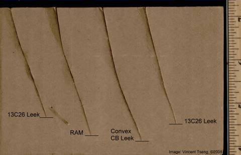

The blade now cuts through better having much less resistance at the bevel transition to the face.
Here's an informal ad-hoc test showing the improvement -
I compared cutting corrugated cardboard between this now convexed Composite Blade Leek verses the 13C26 Leek and the RAM (see Review - Kershaw RAM) both of which I had praised for having much thinner hollow grinds without too much widening/thickening toward the edge.
My previous comparison of the Composite Blade Leek with the factory edge was easily out-cut by the 13C26 Leek - see Post #5 above
This time the convexed CB Leek out cut the 13C26 Leek - and I used the 13C26 Leek twice to make sure the first cut wasn't somehow sub-par. The convexed CB Leek also just out cut the RAM.

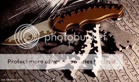

I don't think that at the composite "assembly" stage the CPM-D2 stock is any thinner than the other steel - if it were then the subsequent grinding would probably be hindered if not very difficult.
This crop from the Kershaw 2008 catalog for the Tyrade shows the "jigsaw" components for the composite blade -
and the 2 parts seem to be about the same thickness?

Wow! Thanks for the pics Vincent. Interesting how they designed the cuttings so that non is wasted.Looks like a giant puzzle.
