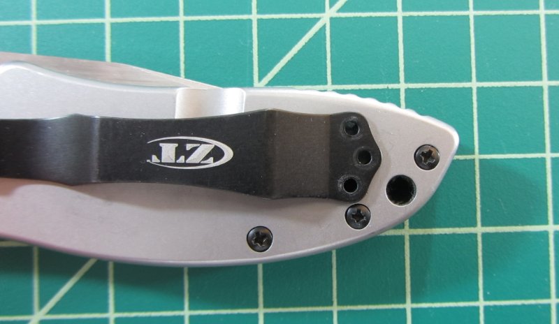

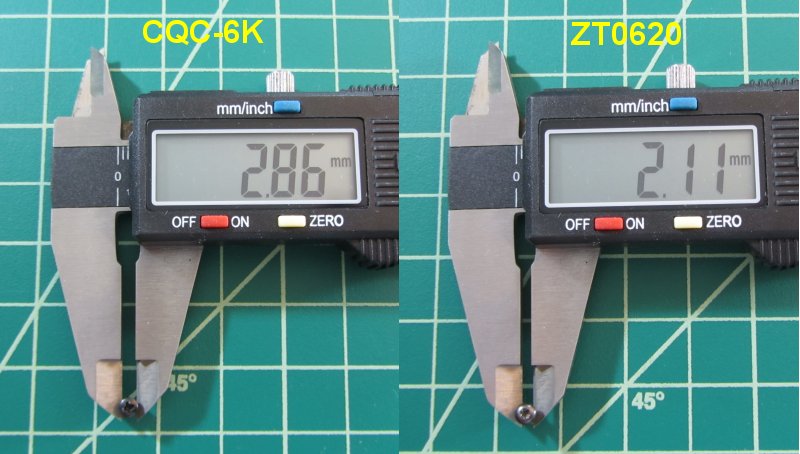

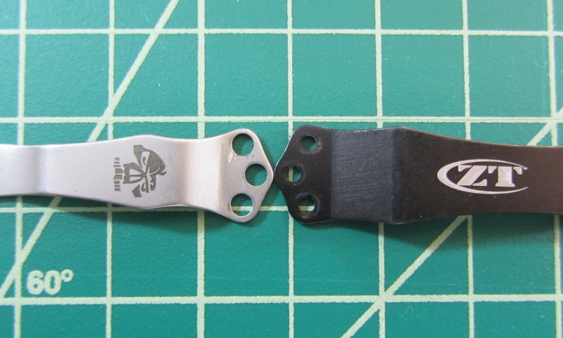

The clip hole spacing is the same, but the ZT uses smaller diameter screw than the Kershaw ones. If you have a Dremel or something to enlarge the holes on the ZT clip, it should fit on the Kershaws. You'll need to use the screws from the corresponding Kershaw though, as the ZT screws will be too small.
Here's the ZT clip aligned with the clip holes on the CQC-6K:
Side-by-side of the Kershaw and ZT clips:
Measurements of the diameters of each screw:
I stand corrected about the screw pattern! Thank You flarp! The Kershaw/Emerson pocketclip just looks tiny and the larger screws didn't help.
