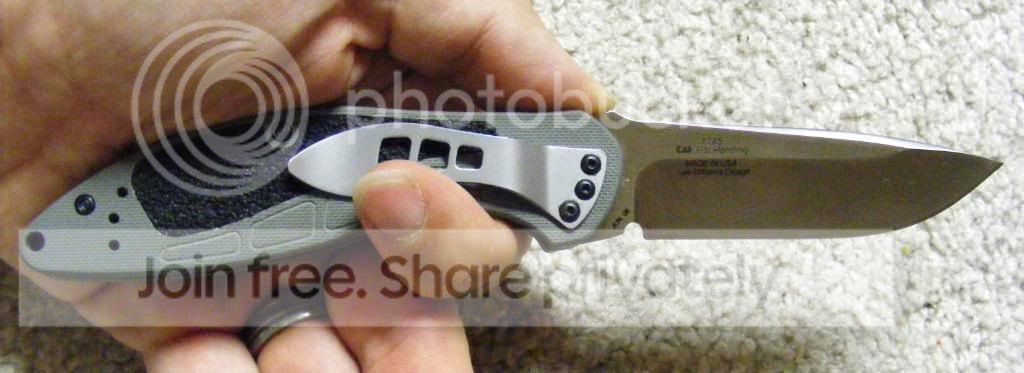

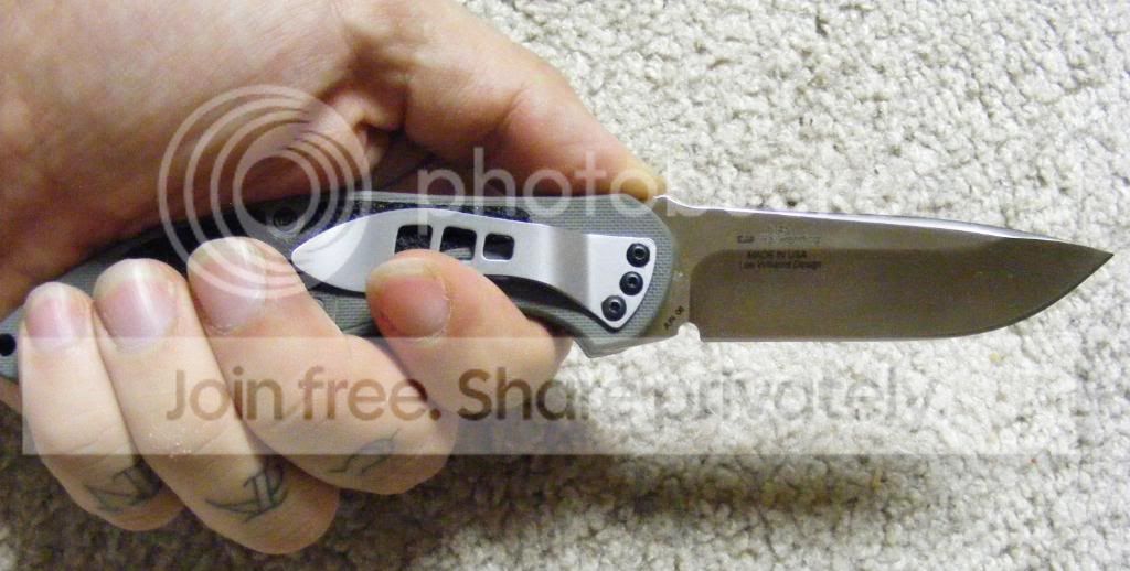

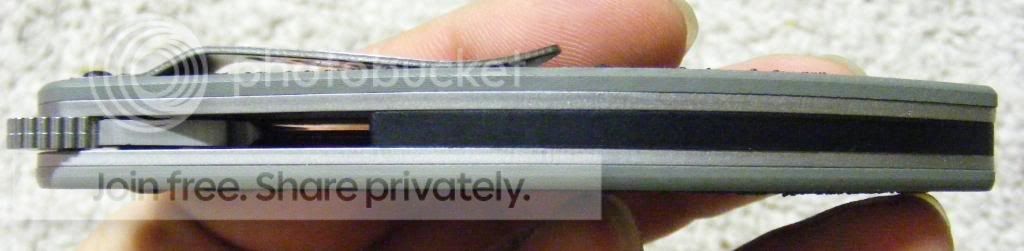

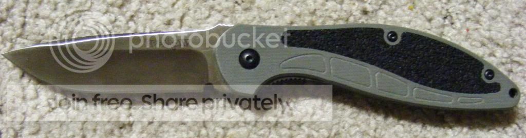

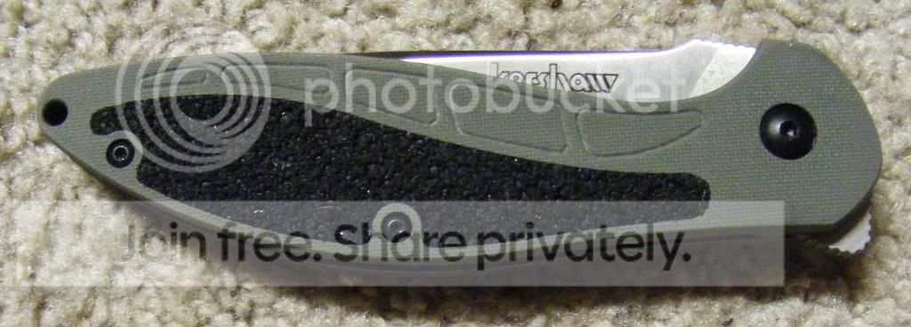

The Handle: The Ener-G 2 (from now on I'll simply call it the Ener-G) is 4-3/4" closed and 1/2" thick not counting the pocket clip.

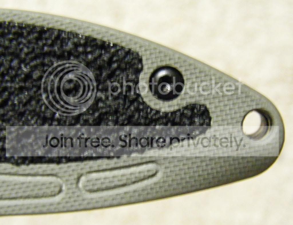

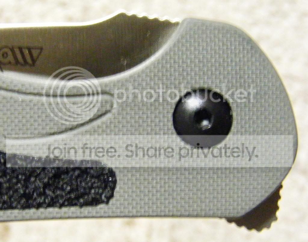

The knife is well-built; the 410-series stainless steel liners are 1/16" thick and are drilled out to reduce weight. The G-10 scales are also 1/16" thick and are a nice grey color. The knife has a black Trac-Tec insert on each side, which makes it even more comfortable.
The knife is held together with two blackened T-6 screws that go into blackened nuts on the right-hand side. They go through a black Zytel backspacer.
A lanyard hole is provided, and it will accomodate cordage up to 1/8" thick.
The blade pivot pin screw is a blackened T-8 screw, and it goes into a hex nut on the other side. Mine came perfect and required no adjusting.

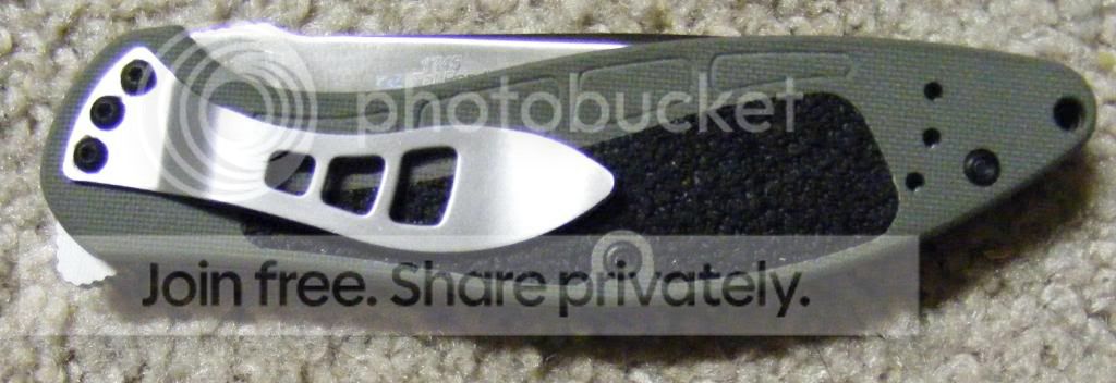

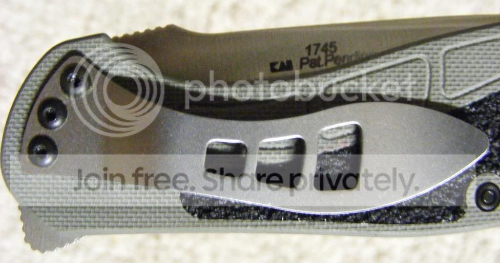

The pocket clip is matte stainless steel and rides on the right side only. It's adjustable for tip up or tip down carry and is held on with three blackened T-6 screws.
Retention is the pocket is great; the knife doesn't snag my pants, yet it stays where it's placed until you take it out. Tip-down carry carries a little lower in the pocket than tip-up.
The Ener-G is a linerlock. The liner is jimped and locks up like a bank vault; absolutely no blade play. releasing the lock was a tad hard at first. I wish the linerlock side was extended just 1/16" more so I could unlock the knife without having to actually put my finger inside the handle.
The Ener-G is comfortable in use and naturally "points" in the right direction. this is a difficult one to explain, but just pick one up, then pick up a Swiss Army Knife, and you'll see what I mean.

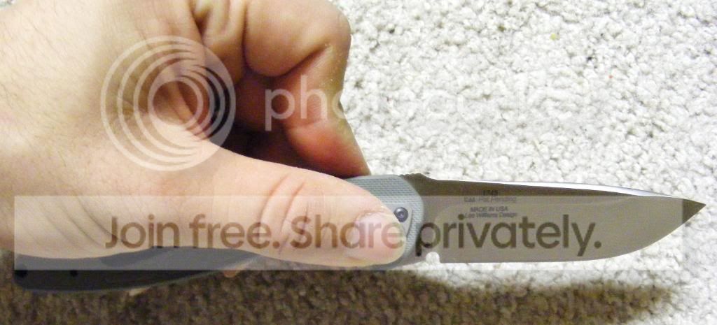

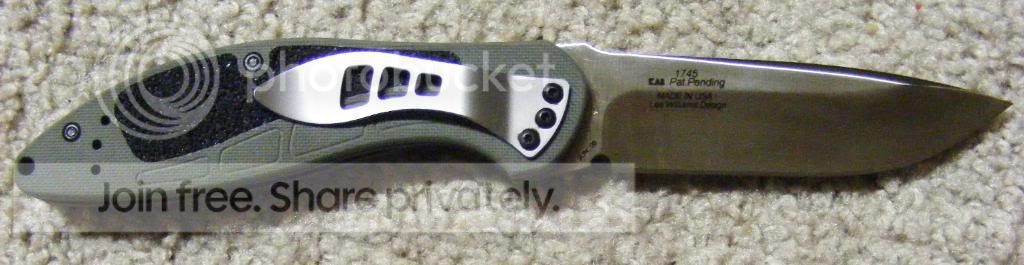

The Blade: The Ener-G has a 3-5/8" long (3-1/2" cutting edge) blade made of Sandvik 13C26 stainless steel at 58-60 on the Rockwell scale. It's 1-8" thick and satin finished. The blade is hollow ground from about 3/4 way up.

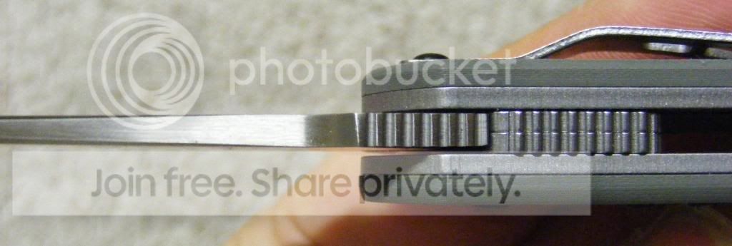

It also has jimping on the thumb ramp. When locked open, this jimping meets the jimping on the flipper to make 1-1/8" of functional jimping on the back of the handle / back of the blade.

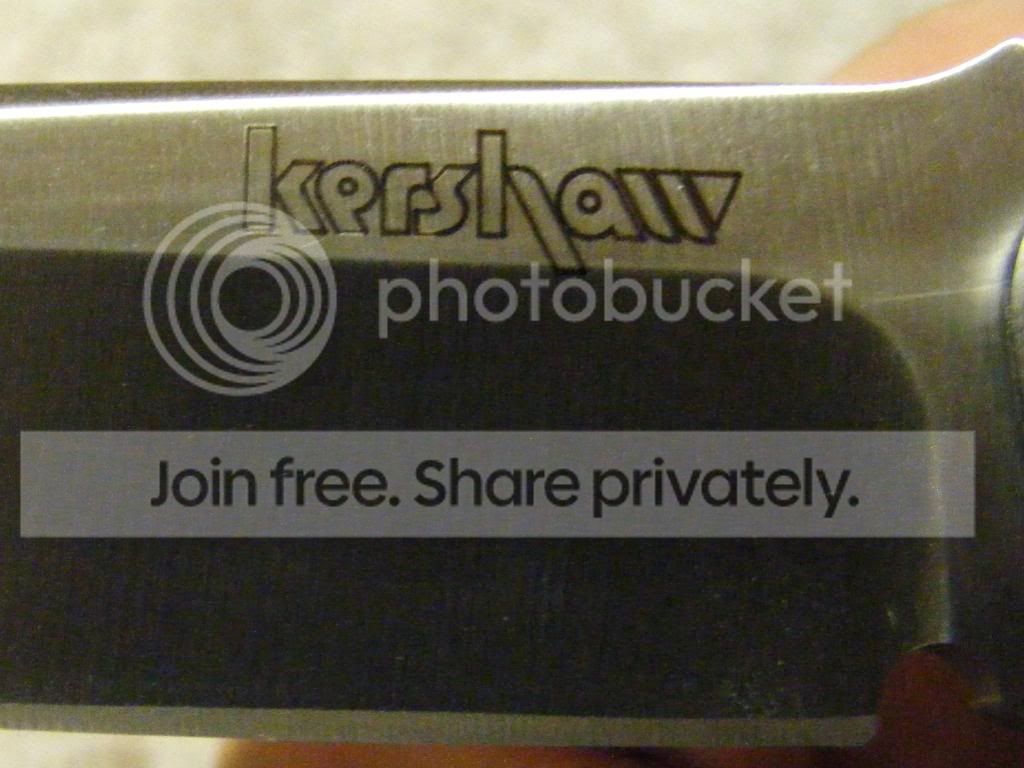

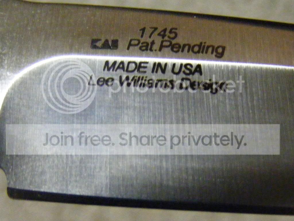

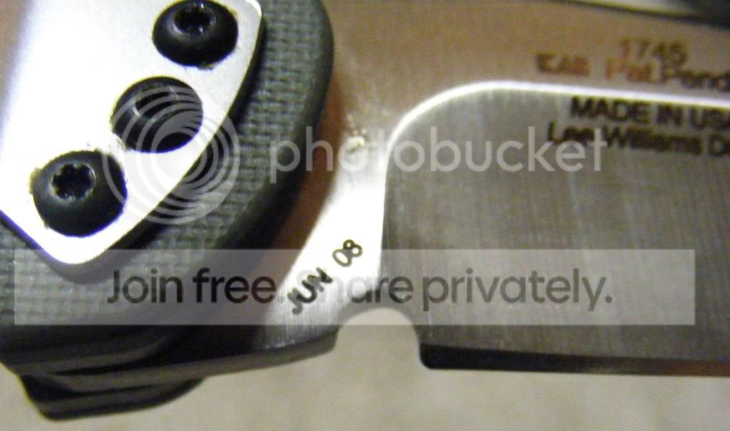

Blade markings...
I like how Kershaw puts the month and year of manufacture on their blades. Mine is from June of 2008...

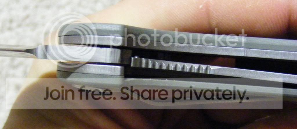

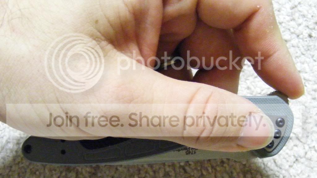

My Ener-G came extremely sharp and was able to shave hair without any work on the strop. The blade is opened vis the flipper. This is a free-floating piece of metal that's held in the handle with two stainless steel pins. By putting your index finger on the flipper and building up pressure, you can pull back on the flipper and it will open the blade. It sounds a lot more complex than it really is.
Once opened, the flipper stays in the handle; it doesn't follow the blade (it's not attached to the blade in any way). A unique feature. Look at these photos again to see the flipper inside the handle.
From the spine side...
From the edge side...
