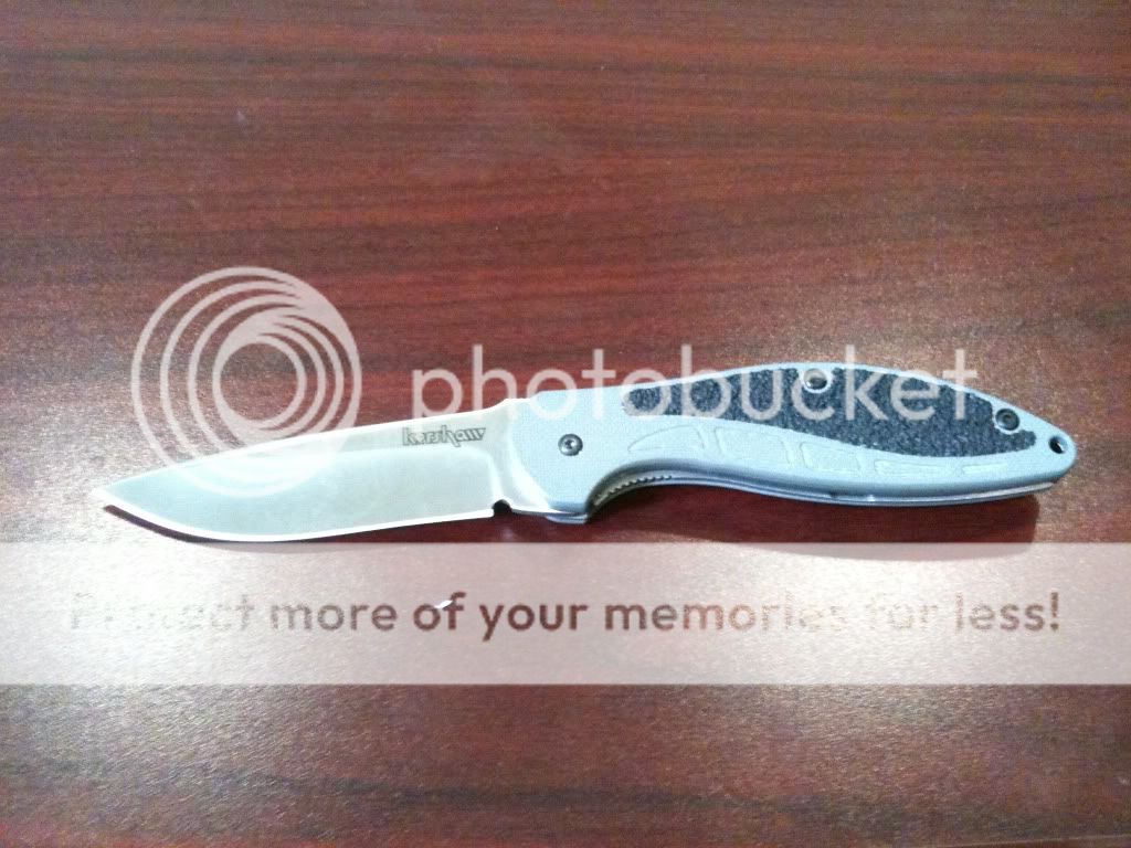

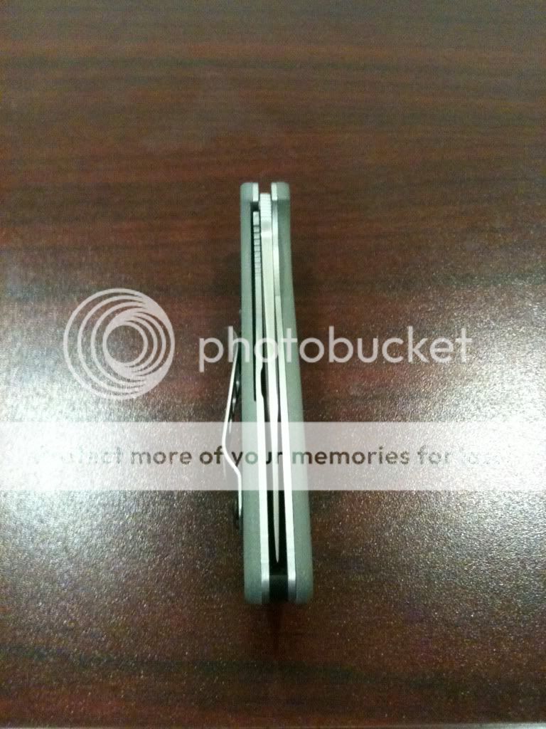

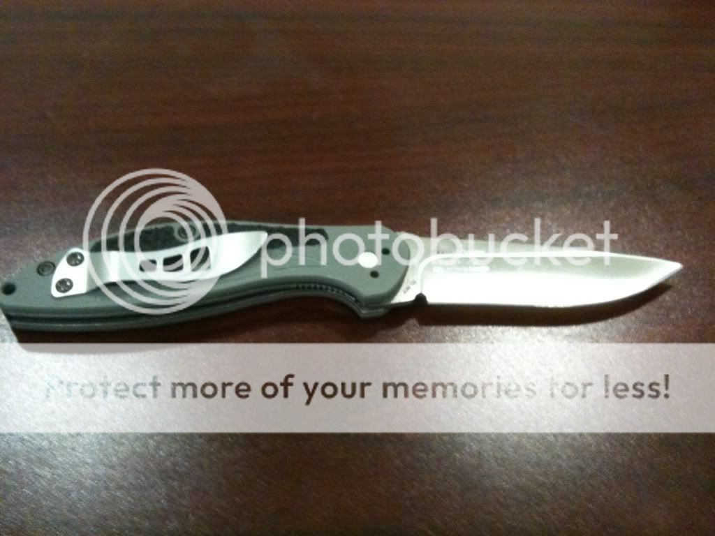

Hello all. I just recieved my Kershaw Ener-G which costed around $30 shipped and I must say I'm blown away. This knife is incredible! Even at $50 bucks I would consider it a great buy. The handle feels great in the hand, Screaming sharp out of the box, USA made,I love the blade profile, the g10 is great and I love the color, I like the steel and with maintence on extra extra fine stones or a strop I imagine it will stat sharp indefinitely given my experience with AEB-L steel which is supposed to be the same as 13c26, it flips open well, the blade is centered, it's very light which I really like in my knives, has early lockup, dirt cheap so I'm not the least bit concerned about using it, all in all this is hands down the best $30 dollar knife I've seem and as of now I like it better than the persistence even.
Now for the cons... The blade had some wobble out of the box and when I tightened it the pivot screw stripped but the wobble is mostly gone. It only wobbles when pushed side to side from the tip of the blade using a good amount of force. Second the track tech inserts I could do without and the G10 itself provides a better grip. I think over time the Trackteck inserts could wear out a pocket, given the placement in relation to the pocket clip. The flipper flips most of the time but not as much as did before I tightened it which was pretty much every single time. I'm guessing it will break in over time and not be a issue. Here's some more pics

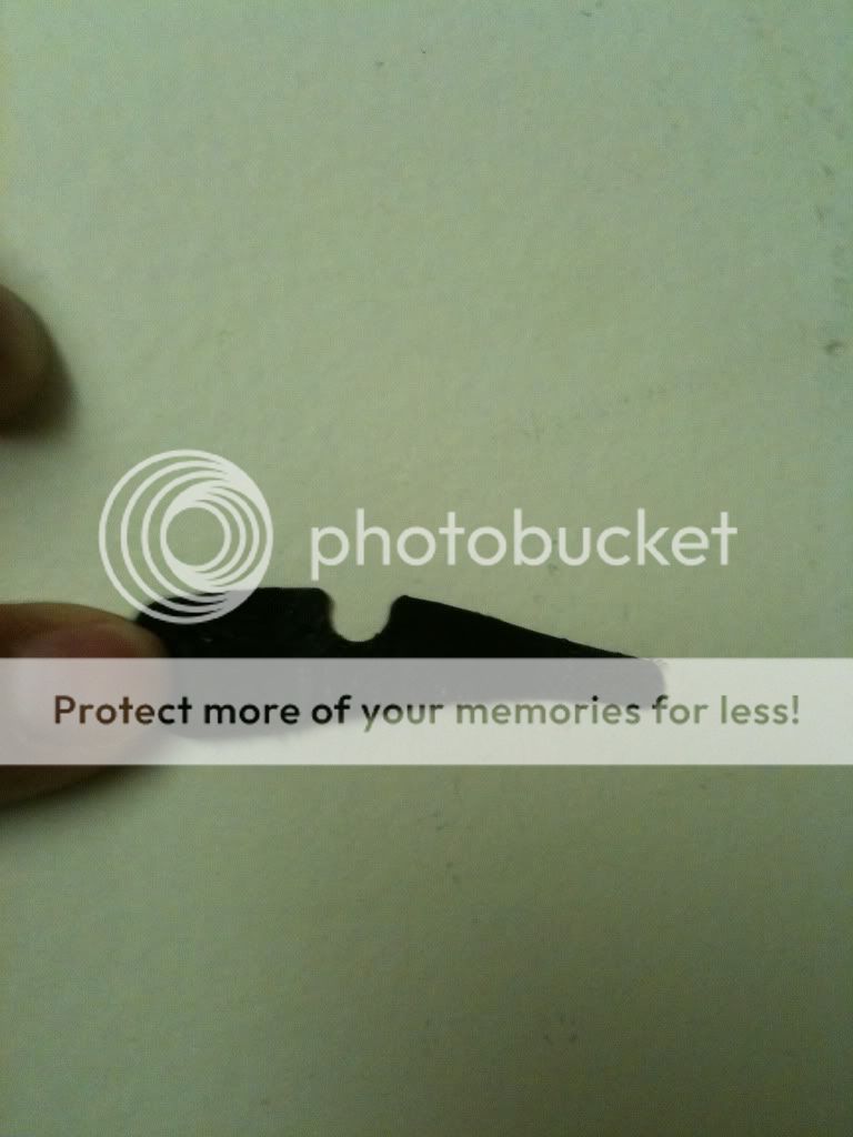

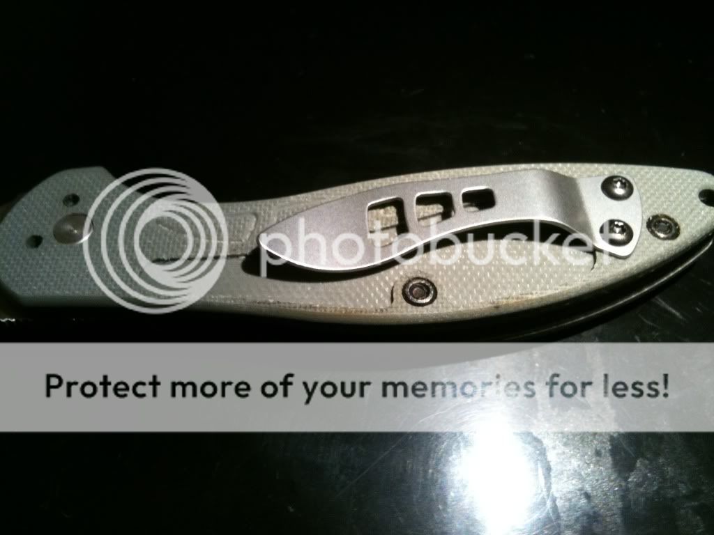

I was melting down the insert with a butane torch because filing wouldn't work and one side started to unpeel so I just pulled the rest came off. I like it much better now.

Did the insert come out in one piece? If so, it would be easy to use as a template. Just glue it onto the piece of wood and start shaping. If you do it right, it should just slip into place.

Yes it came out in one piece. How it happened was I was burning it with the torch and smoothing out the surface with a semi round object pushing towards the tip of the handle and after a few passes the edge of the insert towards the tip of the handle started to lift, so I pulled it out light and slow and the whole think came out. Here's a pic
it slides out of the pocket just right now.
Nice. Now all you have to do is superglue that to a thin piece of something cool and shape it with sandpaper.
It works really well to find things that match the inside radii to wrap the sandpaper around (like a coffee cup or a pen). The only tool required is a pack of various sandpaper grits (and maybe a saw). If you don't have any wood laying around, PM me and I'll send you some scraps of mine.

The pieces come out easy enough and in one solid piece , just lift a corner with another thin tipped knife and peel off , you can even reapply them.
You would not need superglue to put them on a clean piece of something else to use as a template , they will self stick.
Getting wood that thin and perfect by hand though would be quite a chore , I think a person with a good shop of tools could do it easier.
