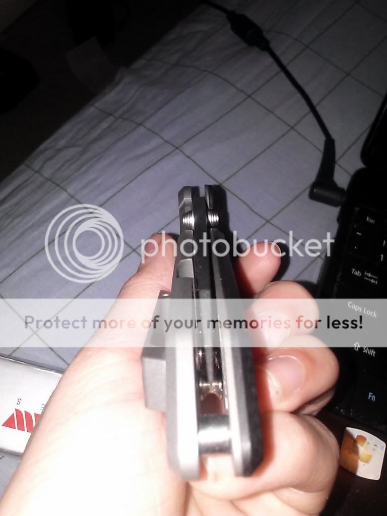

Are there any fellow Kershaw owners who have bought a frame lock design where the blade came centered in the frame?
I just received a Kershaw Volt SS Stainless Steel Speedsafe Knife and the blade is rubbing on the frame.
I checked my Leek when it first arrived and the blade was centered. I also heard that the new Cryos have this same problem with the blades not being centered?
Is this normal or a defect?

It's hardly a defect, especially on a budget knife. It can be fixed in a matter of minutes. With the knife closed:
1- Loosen all the handle screws (don't remove them, just loosen them)
2- Loosen the Pivot screw, again don't remove it
3- Get a small piece of paper and fold it a couple times. Wedge it in between the blade and handle until the blade is centered.
4- Tighten the pivot screw all the way.
5- tighten handle screws from the furthest away the pivot, alternating sides if needed.
6- Remove the paper, and slowly loosen the pivot screw just enough so that the blade can be flipped open.
