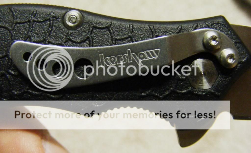

The pocket clip is stainless steel and is polished; it carries the Kershaw logo stamped in. It's positionable for tip up or tip down carry, right-handed only. Retention in the pocket is great, although tip-down rides lower than tip-up. The clip is held on with two T-6 screws.

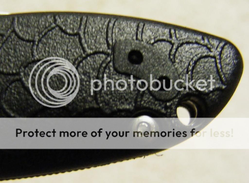

Showing the butt end, including pocket clip placement, lanyard hole, and the bolts that the handle screws go into...
