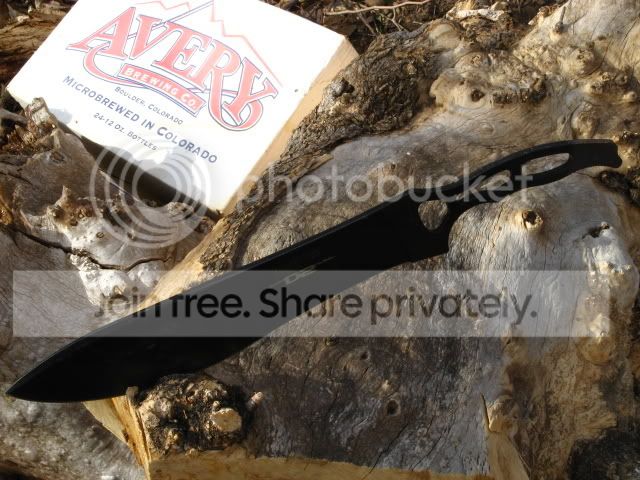

I'm not much of a fan for using D2 in a blade over 5" long because of the "brittleness" of the steel. That being said, I did beat the heck out of it pretty good without any problems. I am in the middle of project right now in which I have cut it down to just a tad over 5" and removed the handle. Just so everyone knows, the hand is the rubber type stuff on the outside and then its plastic and then it's a skeltonized handle - not much in terms of steel in the handle. I plan on stripping the coating, thinning out the edge, take it to about 15 primary and 20 secondary, and re-handle it. I would pay the $55 I paid for mine again.
