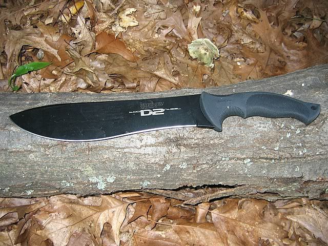

Thanks to Samo for the headsup on this GREAT KNIFE!!
I got this for ~ $60 shipped.
It's a GREAT field knife.
It's 22 ounces of D2 steel, rubber handle, kydex sheath, 10 inch blade.
I had loved my HI Khukuris for outdoor bushwacking and such. They are heavier than this...Gotta weigh em. My BAS was my fav till this Outcast came along.
I whisked thru light brush and weeds like it had a motor on it. THin blade and long cutting edge helped in this.

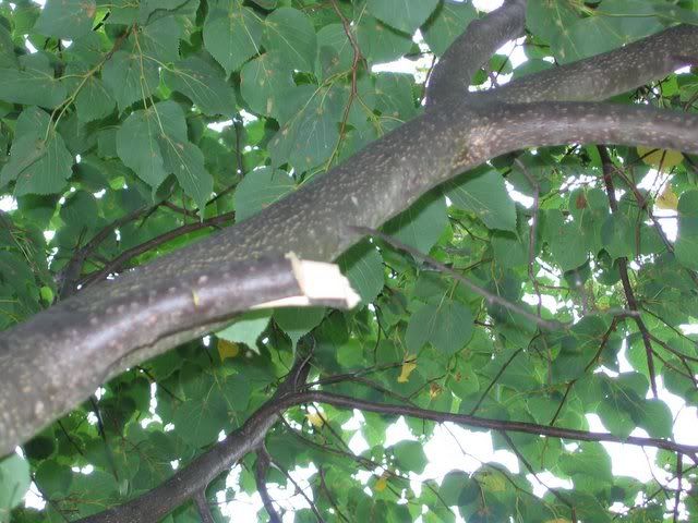

I lopped a 1.5 inch limb that was way overhead. Must have been over eight feet cause I didn't get a good swipe with the blade. Had to reach way high and didn't come down as I would have liked.
took two swipes till it was cut thru.

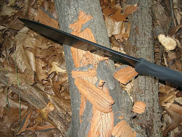

Well I used it a mite and the edge was still sharp

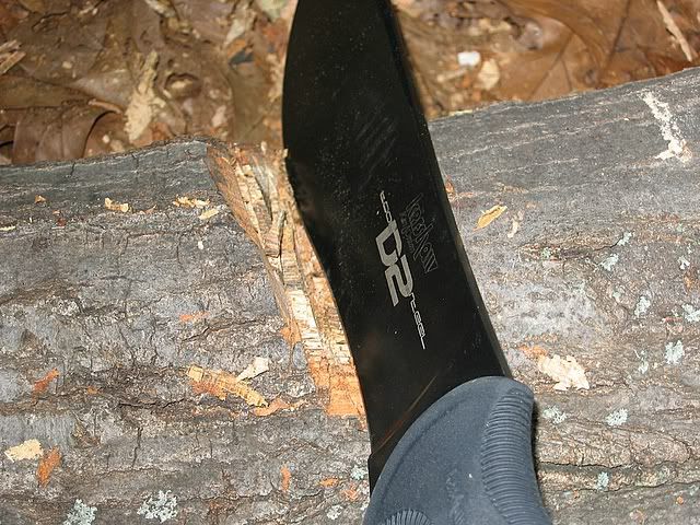

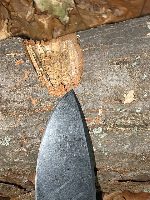

So I took to choppin through a large trunk.
After 50 or so hatchet like cuts I stopped. It's damn hot and humid out nowadays!!!!!
But I was satisfied that I could cut through most anything...if I really need to. A saw is what I would use on this anyway.....Chipped out a good deal of wood when I was done with choppin.

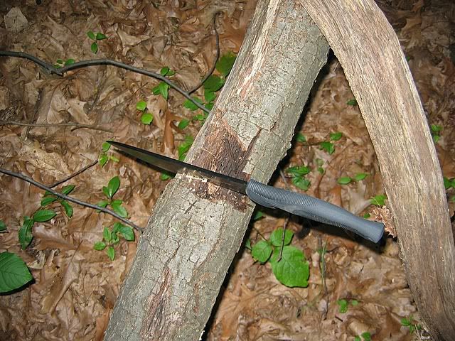

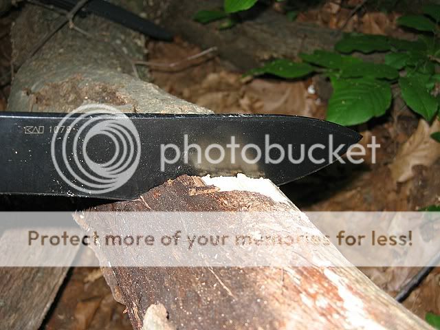

So How will it baton...It's thin so will it break? I didn't have any end grain to baton thru so I drove it into some trunk.
The limb you see to your right was the baton stick.
Very IMPRESSIVE WITH BATONING THIS!!!!

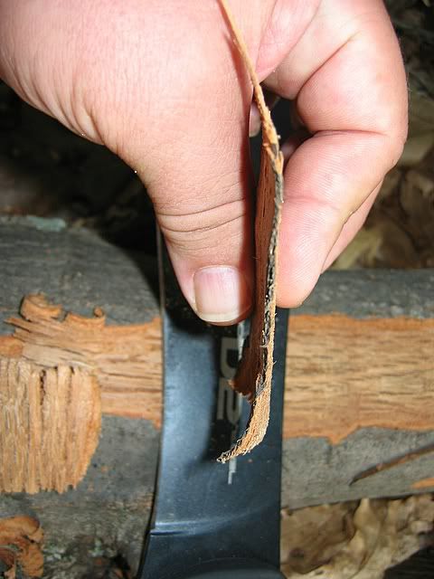

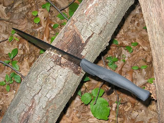

When I was done beating it like a madman and sweat was pourin off me I figured I'd sit a spell and draw pull the knife and see what it's do. I figured the edge would have rolled
NOT!!!!!!!!!

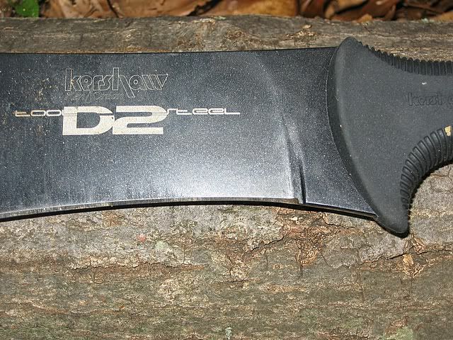

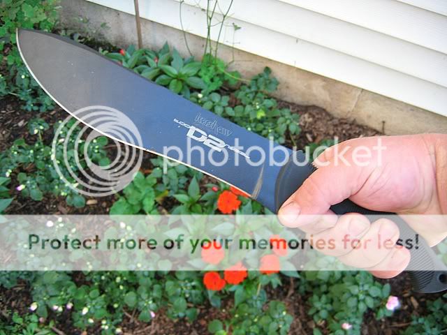

Course I'm using several different areas of the blade. Belly for chopping and batoning. The belly drew thru very nicely but it's a bugger to pull cut and keep on a plane to get thin stuff with a belly. It keeps wantin to veer off to the side.
This piece is thinner than it appears ...

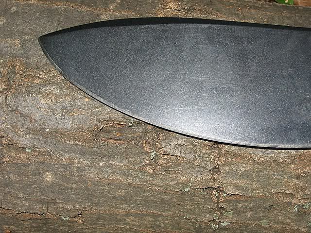

This is the edge when I was done with all this. I didn't steel or strop or sharpen thru the whole ordeal..
All in all a fantastic knife at a GREAT price.
I really wonder how your BSA, if well sharpened would compare? My intution, having used the same two knives, is that the HI Khuk will blow through that size wood like butter.
That must have been some iron hard wood!
Batoning across the grain like that is *much* harder than splitting wood with the grain. I split some kindling with the Outcast, it works fairly well.
Yes, I used mine for a draw knife as well, and saw simliar good perfromace. Recurves perfrom well here, since they are shearing through the wood while pulling through, since the edge is being presented at an angle to the material being cut. See JM's and Chad's posts on OSF several years ago regarding this.
Again, all I can wonder is how other knives, espcially the HI Khuk that this replaced as your favorite field knife would have faired? Based on my won use of HI Khuks and the numersous field reports, it would be not be phased by this work.

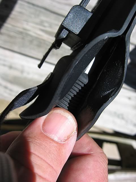

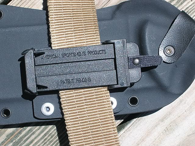

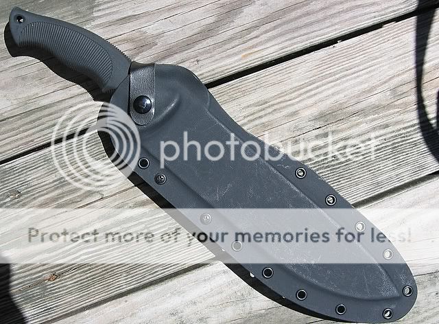

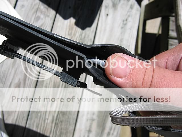

Pics of the sheath.
Fits well in the sheath. Nice and tight. I wonder how long the knife keeper (lashdown for the handle) will stay together, feels a bit flimsy but with the materials used it may last longer than me :)
Weighs 22.8 ounces in sheath. Many configurations available with the eyeholes. TO move the TekLok or lash the sheath to leg or pack.
Belt keeper is efficient and BIG. The belt is a 1.5 inch Wilderness five stitch. There is no slide to take up slack of the belt size. dunno if this will be a concern in field use. I haven't spent much time in the woods with this on my belt.

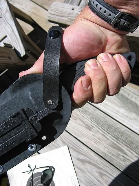

The sheath has a split thumb ramp which I have come to enjoy from other kydex sheaths. It is an ease to draw.
The handle fills the hand when drawing and "unlocking" with the thumb.
