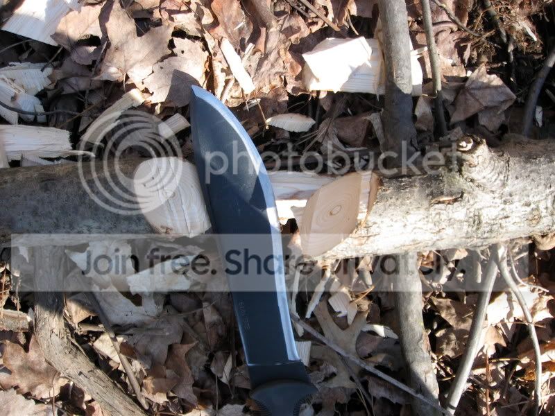

i spent about a total of 2 hours probably grinding the Outcast before i was really satisfied with it...but i think it was entirely worth it.

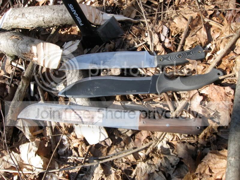

yesterday was nice out, so took a few blades into the woods to play with. i took the Outcast, a Crowell/Barker competition knife, a Fiskars 14" hatchet, and my heavy machete.
i was pleasantly surprised by the results.

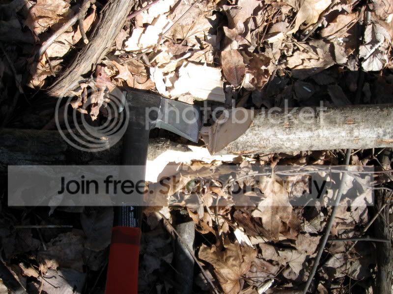

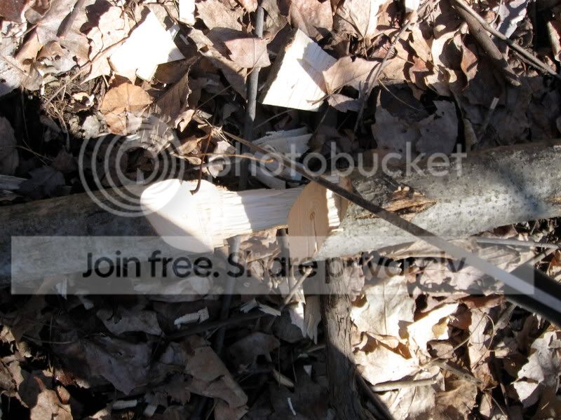

i only did one trial of each officially, but i did a bunch of chopping with all four yesterday. i used the Fiskars as my baseline, since i consider it roughly optimal efficiency for chopping.
Fiskars-22
Outcast-23
Heavy Machete-25
Crowell/Barker-28
i would say that the Outcast matched the Fiskars on almost everything. i was chopping maple up to about 5-6" diameter, and it worked pretty well. it didn't have quite as much hitting power as the hatchet, which means that it didn't rank as well on the larger wood, but it did work really well.
when i originally recieved the Outcast, the edge was about 3/32 or 1/8" thick, with about a 40-45 degree inclusive bevel...very thick!
i layed the bevel way back and convexed it, so now its a real chopping machine! i also squared part of the spine so that it can scrape tinder and a firesteel.
also, i wanted to mention that i was very pleased with the edge retention. it stayed hair popping sharp after a pile of chopping hard woods. since i ground the Fiskars back, the edge retention has been much better, but the Outcast still far outclassed it.

james, i agree on the competition knife...its a decent blade, but i think it doesn't have enough of a blade-heavy balance, if you know what i mean. the handle is a bit blocky, but this one isn't mine so i'm not going to round it out any... i would say that the comp. knife holds a pretty good edge. i might say its a little better than my Fiskars (keep in mind that grinding on the Fiskars has got back to harder steel, and edge retention is much better than with the stock axe)

james, i agree on the competition knife...its a decent blade, but i think it doesn't have enough of a blade-heavy balance, if you know what i mean...
Yessir, we're definitely on the same page. I agree with each of the points you made. I also think the belly should be more pronounced and more towards the tip... it seems the sweet spot where it chops/cuts the best, is a couple inches behind the tip... I feel like this is costing me, in terms of balance and the fact that the fastest-moving part of the blade, the tip, isn't in play in the actual cutting. I'm also not sure why the ricasso and handle are so damn long. I can literally wrap one fist and two fingers from the other hand on this handle, comfortably. I wear an XL glove snugly, and usually complain about handles being too small.
Again, having said all that, this thing is built like a tank and I have been plenty happy to carry it in the woods. It definitely stands up to hard use.
