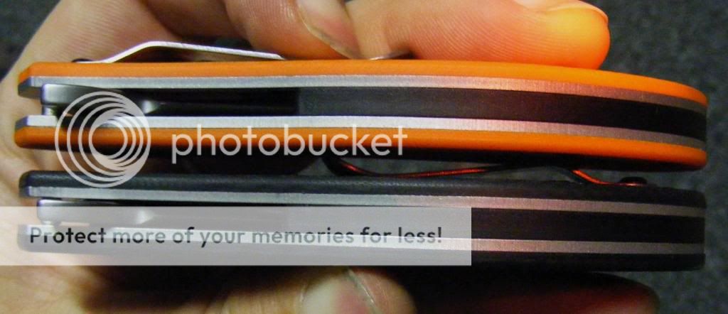

The Handle: The Packrat is 4-1/8" long closed and 7/16" thick, not counting the pocket clip. It has 410-series stainless steel liners, one locking, and G-10 scales. the handles are held together with three black T-6 screws, which go into nuts on the right side of the handle. The blade pivot pin screw is black, and uses a T-8 screw.

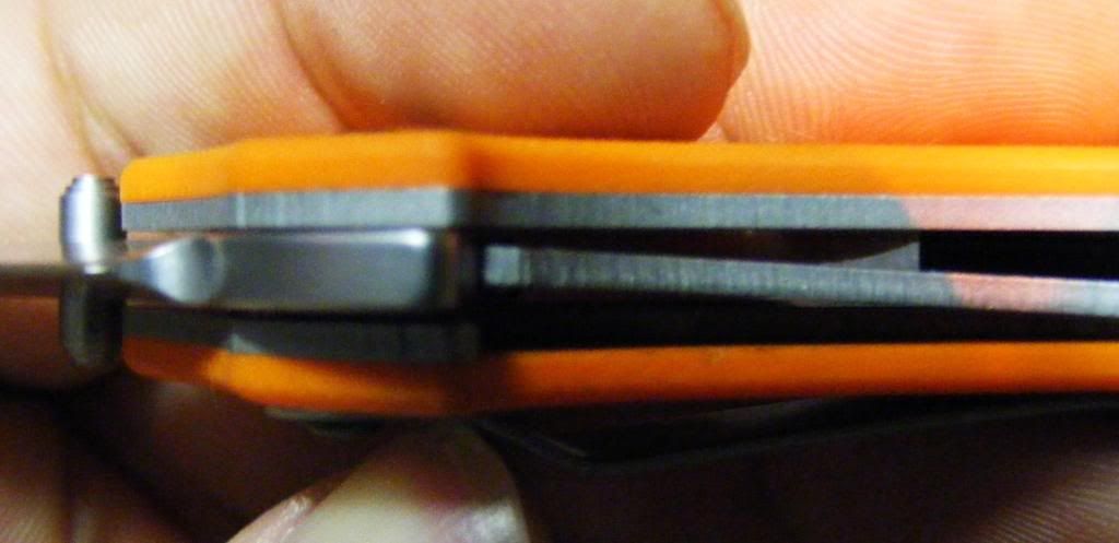

The Packrat is a linerlock. The two I have are great; no blade play in any direction, and the liner engages the blade for its entire length on both.
The orange one engages the lock a little farther than the black one, but both are perfectly functional.

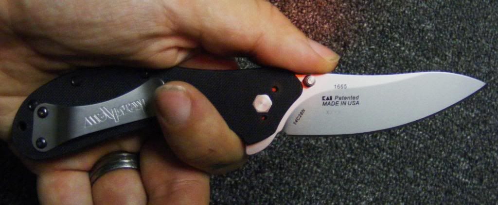

The Blade: The Packrat uses a Sandvik 14C28N stainless steel blade at 58-60 on the Rockwell scale. It's 3-3/8" long and 1/8" thick. It's flat ground and has a brushed finish.
Both of mine came hair-shaving sharp. There are thumb studs are on each side of the blade, but I just can't get my thumb between the stud and handle to make them useful; I have to use the flipper. When open, the flipper forms a choil, which is nice. There's no jimping on the spine of the blade, but I don't think it's necessary due to the slight curve on the handle.
