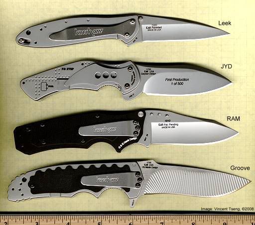

Another thing I should mention and Kershaw should be praised for - is the newer hollow grind on this RAM (and the 13C26 steel Leek) -
One of my long time peeves is the widening/thickening of the blade toward the edge of hollow grinds -

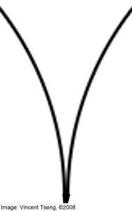

Typically a hollow grind is like -
where there is a distinct thickening/widening of the blade before the actual final cutting edge - simply because it is easier to manufacture - even handmades often are like this.

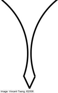

An ideal hollow grind would be closer to this -
where there is NO thickening toward the edge - but this may be harder to manufacture since there would be heat problems grinding toward the thinning edge.
The newer Kershaws - at least on my samples of one each on this RAM and the 13C26 steel Leek, are much thinner toward the edge and widen only very little.
I think this is a very good thing.
