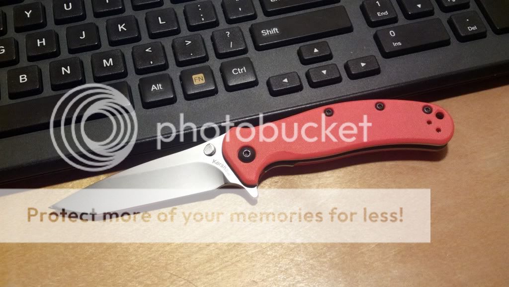

I can't do the amazing quality photos that kneedeep can do, but I thought this thread needed some shots of the Tanto Zing.
So, here's mine... I've done some polishing to the blade and darkened the pocket clip, so it's not exactly what you'll get from the factory... I just wanted to do something a little different...

What did you use to put that nice mirror polish on the blade?
English Custom Polish (liquid, 4-steps), small pointed felt bobs (one for each step), and a single speed Dremel wired to a dimmer switch for speed control. The polish was some pretty expensive stuff I originally got for the wheels on my car. Just used a little dab on the felt bob and set the Dremel speed nice and low. I also used masking tape along the grind line, that's how I got the nice hard edge between the polished area and the bead-blasted area. I was a little disappointed at how easily it picked up scratches afterword though. Seems like anything that isn't a microfiber cloth will put those "angel hair" scratches in it. I do carry the knife occasionally though, so I've decided not to obsess too much over maintaining a perfect finish. All in all, I was quite happy with the way it turned out, especially considering it was my first try.
