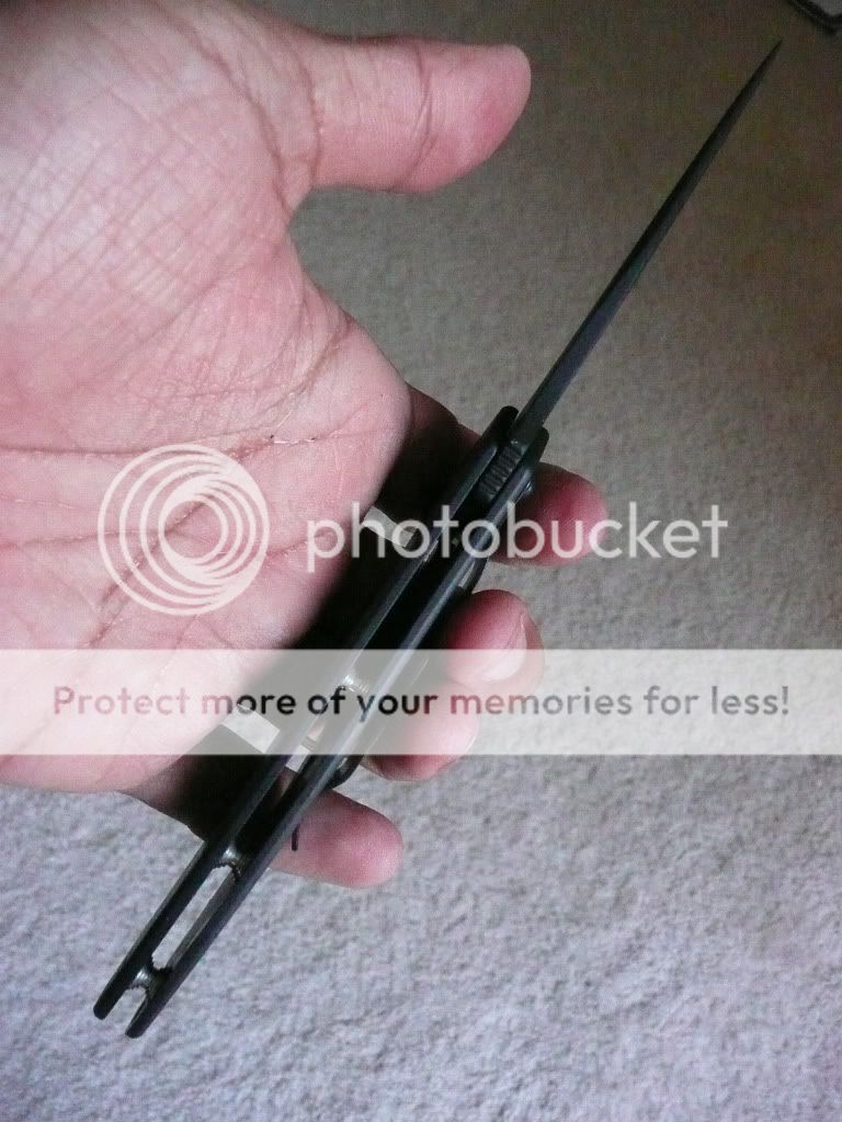

So I got a blem Kershaw Shallot from kershawguy due to the fact that I kept hearing great things about them, and wanting to do some home-brew things without accidentally trashing a $50+ knife

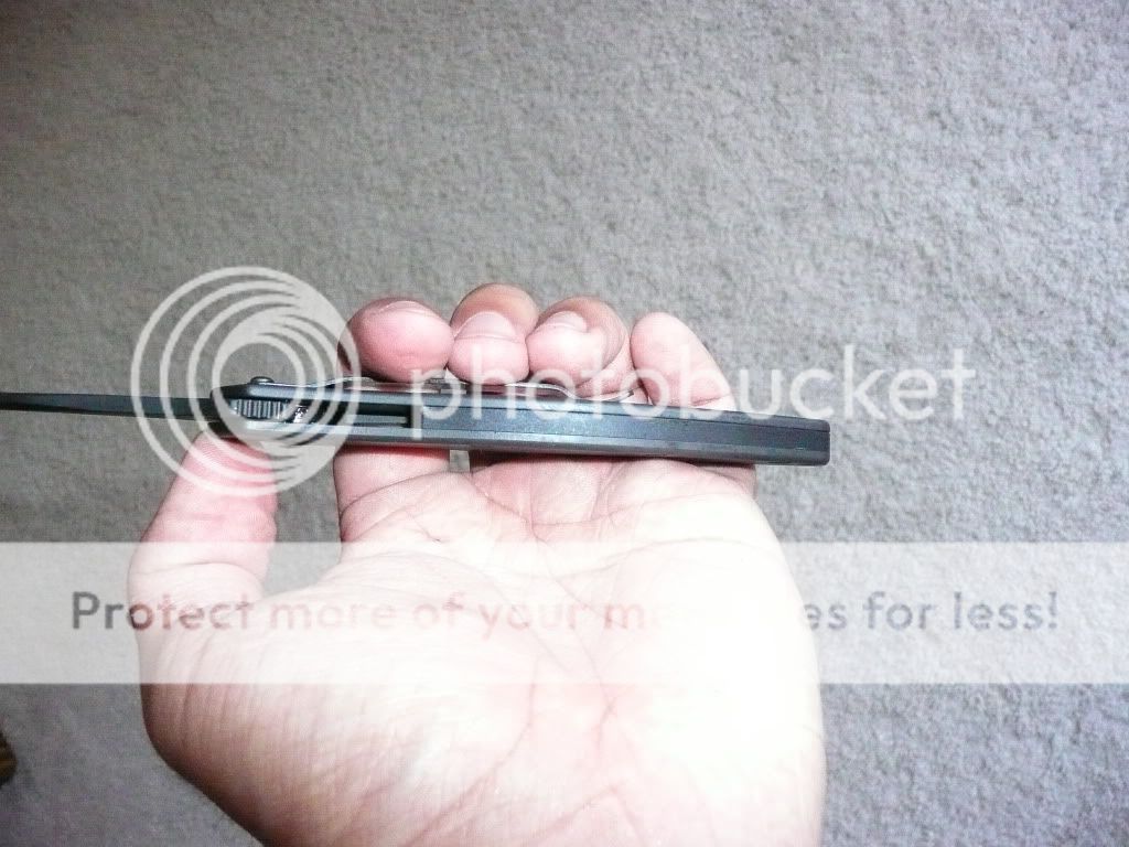

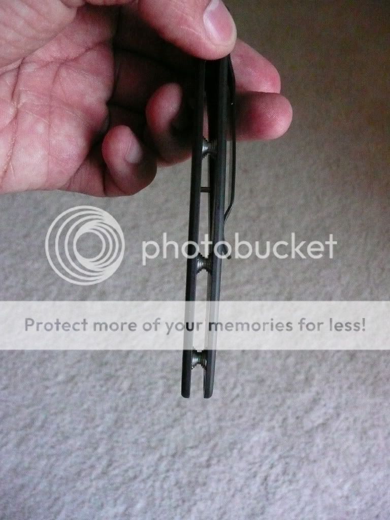

I added custom standoffs to the Shallot, since I felt that the plastic (G-10?) insert just wasn't fitting for a knife as clean and pretty as the Shallot.
So, now my knife is completely metal, not a single part or piece of plastic on it anywhere!
Stock
Custom Standoffs!
Next I want to trim the torsion bar and reinforce where it presses against the knife
Let me know what you guys and gals think!

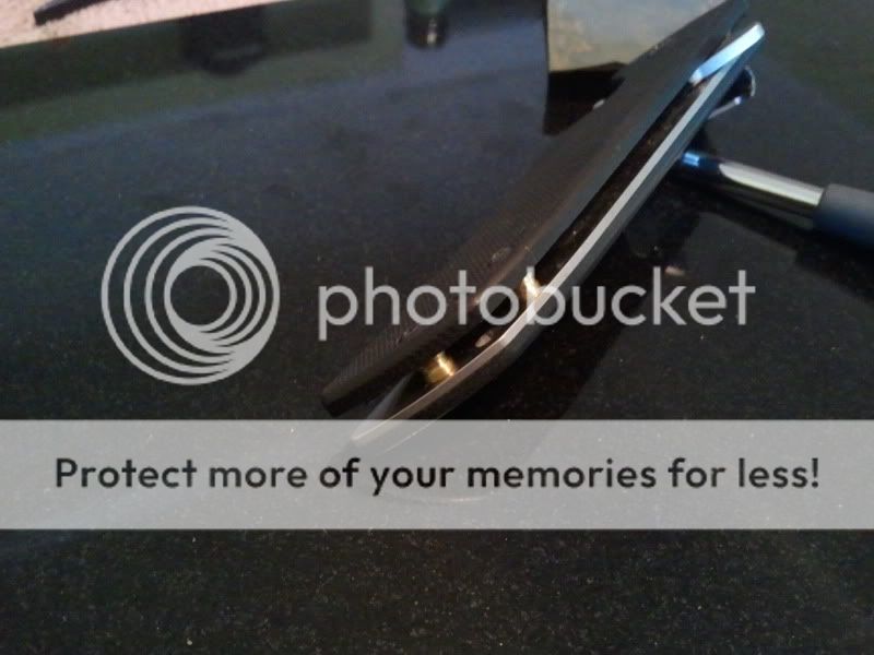

When I ordered the standoffs, they only had those in the proper width I needed, and the holes in them were too small for the screws.
I had to drill them out, and it's a little hard to see, but I marred them a little. Didn't realize they were that soft.
They were also a bit expensive, ordered from KnifeKits.com
Does anyone know another place to get knife parts and such?
I wonder why they were soft (the standoffs), I would have thought they would be hardened at least a little. If you decide to drill out another set of stand offs, I would wrap them a couple times in masking tape. It provides adequate cushion and might prevent any deformation or marring.
Sent you a message on where else to try and find some standoffs.
Thanks!
I did wrap the standoffs in soft rag before gripping them with pliers
Perhaps the grooves in the pliers were too aggressive and sharp. Drilling was easy though, and the holes in them helped keep me drilling straight down.
Thanks for the message too! I appreciate the help!
No problem. At some hardware stores, they sell rubber covers for the plier jaws too, it is a trade off protection for precision. Might also be worth the couple bucks to check them out.

If you want to buy or make your own standoffs, they measure to 5/32" or about .156 or .157
Not sure what the drill size I used, it was the smallest bit I had, and just happened to work perfectly
