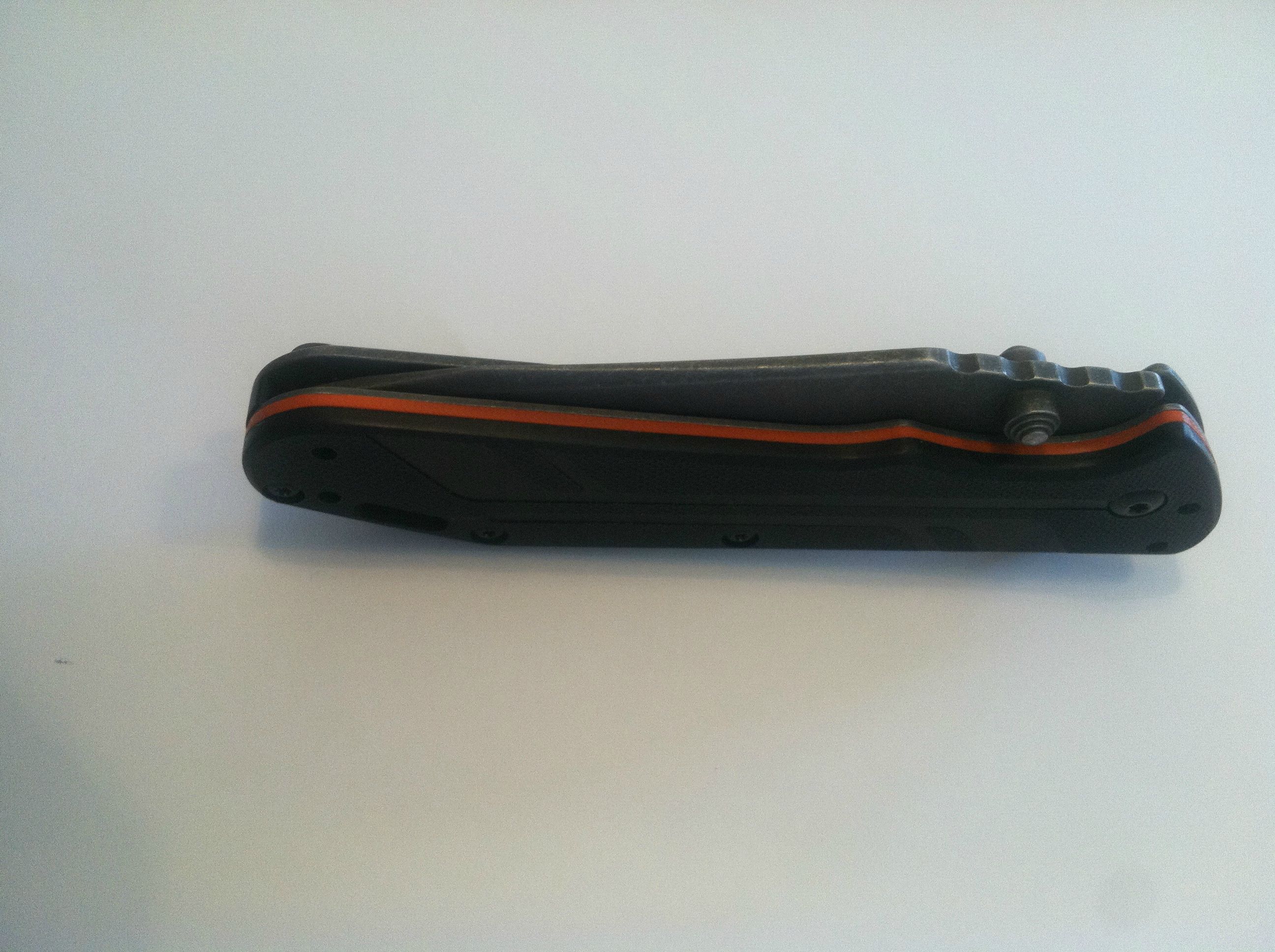

I couldn't leave it alone. I decided to mod my Thermite. I added a forward finger choil and took some weight out of the liner. FYI the liner on the G10 side is hardened! I had to anneal it on the back to drill it out. Cleaned up nice. Now off to EMP to get a new scale and a bead blast job.

I tried that too .It is smooth but I don't have a diamond tipped burr to do this mod. If you did do this you could take out the liner and cut the screws shorter and make the whole thing thinner. Just need a bigger washer for g10 contact to blade.
What did you use to cut the choil?
I've deassisted multiple A/O kershaw's (where it was necessary to add a detent hole) and I did so with a dremil, very simple and takes all of 5 minutes.
Dremel tool and sanding drum followed by a sharpmaker med. stone to deburr edges.
