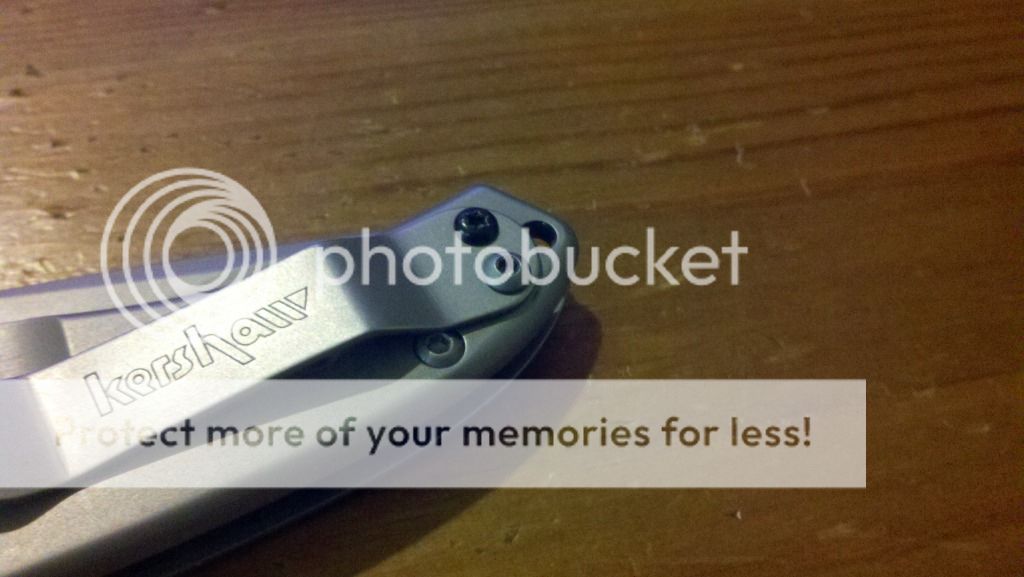

Hello all, I purchased a Vapor III, and the first thing I did upon opening it was try to reverse the pocket clip.
Unfortunately, one of the screws stripped out instantly and now I cannot remove it.

Hmm, fixed it myself, for now,
I Hammered a T7 torx bit into the stripped screw, and then used the T7 to unscrew it. I heard a distinct "pop" upon unscrewing it, like there was loctite in there. I replaced the stripped screw with another from a donor knife that uses a T6 bit. Looks odd, but it works for now:
