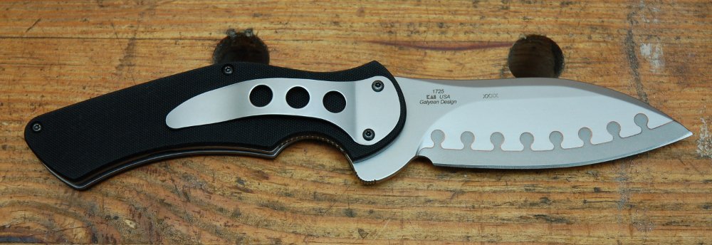

Did KAI have two types of composite blade technologies? One is like what you see on the Kershaw Tilt and JYD SG2 with mostly straight lines separating the two steel types. The other is all of the latter ones with various types of jagged lines, the copper braise line clearly visible and mostly with a "CB" suffix on the model number. On the JYD SG2 I can barely make out the copper line. On the Tilt no such copper line is visible and superficially it does not look as strong.
The JYD SG2 is not CB. It's laminated/clad/san mai whatever you want to called it. Same with the SG2 Blur. There is no copper filler on a JYD SG2. Both my Tilts are DLC coated so I can't see the copper filler either. Is your Tilt coated?
What you're seeing on the JYD SG2 is simply the grind line that shows where the SG2 is exposed after 410 stainless was ground away. The steel above that line is 410 stainless and steel below is sg2. This blade did not start off as two different pieces of steel that were welded together. The line you see on the Tilt is the filler metal used to braise weld two different pieces of metal together. The line can be straight or patterned as seen on other CB knives.
