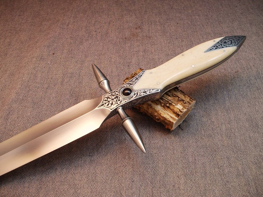

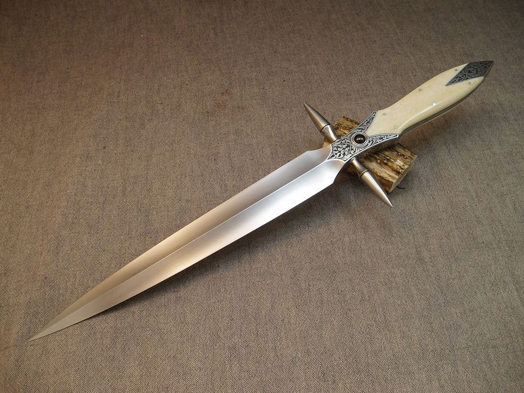

Evening Gents, just finished this piece in time for next weekends Australian Knifemakers Guild Show.

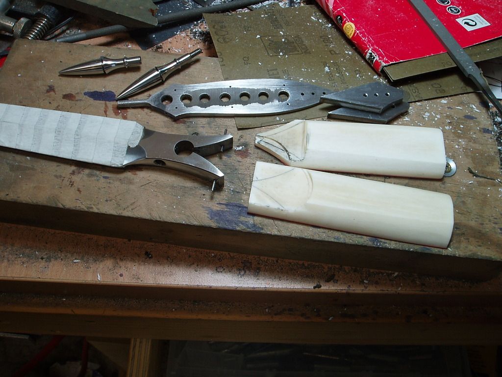

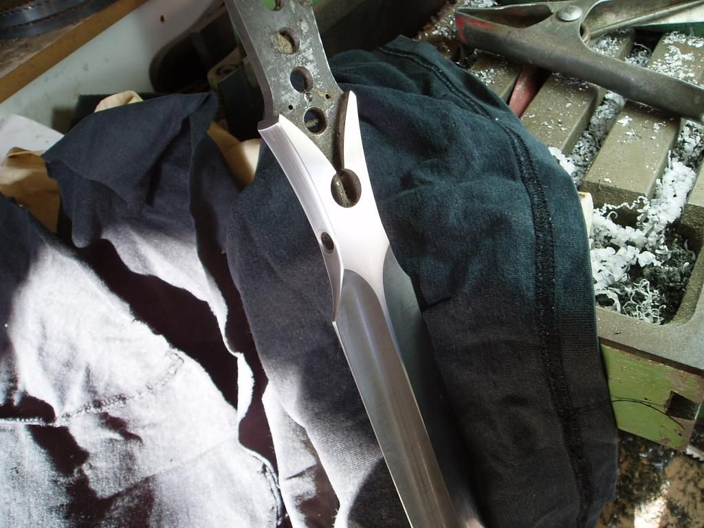

Blade is 440C, tang insert is ATS34. Rear bolsters are 416, guard pieces are 304 stainless. Scales are Giraffe bone, the stones are 10mm Garnets. Engraver Danae Cresswell.
OAL is 18" X 11 1/2" blade. Hope you like, for my part I'm glad it's over:)
what a beauty! I can only imagine the time and patience that went into making that blade. Thanks for sharing. :)
as Robert so eloquently says -- simply marvelous! Very elegant and likely will not hang around long. Have a great show.
Very interesting design and beautifully ground blade. The pictures really help in understanding the complexity of the build. The engraving adds just the right finishing touch. Congratulations for a special piece.
