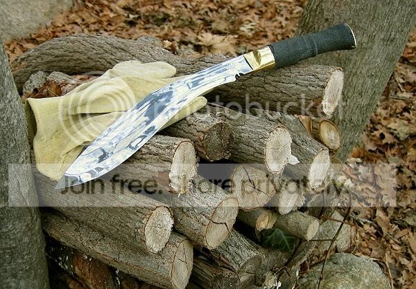

I've written a comprehensive review of a 16.5" Chiruwa Ang Khola. Beware that it is pic intensive and not yet proofread. For those of you who already own something from HI, there are no surprises, but if you are on the edge or thinking about buying, you may find this very useful. Below are a few samples of the photos you can expect. You can check it out here: http://funditor.110mb.com/Chiruwa Ang Khola Khukuri Review.html Come on guys, it's one more click... you've come this far - a step outside of bladeforums.com won't hurt :)

One question. Were you wearing gloves during the entire exercises? Reason I ask is the ridge. From what you wrote, it helped with a secure grip while chopping, but if you had un-gloved hands do you think it would create a "hot spot" or blisters after a while?

Alright. You seem to have had much better results with your Khukuri then I did when I put it up against my hatchet. Perhaps I need more practice with the Khuk, and then try it against my hatchet again. For comparison, I was using the exact same model as what you used.
Along the lines of Tarmix's question. Do you also think using gloves provide a good shock absorbtion against the full tang chiruwa handle? I know my khuk left a nice bruise on the inside of my hand.

A polished kukri ? Whimp ! The ridge is a pain even with gloves. Mine has been greatly reduced and is now comfortable . Do the Nepalese have very small hands ? I know they are much shorter than I am. Anyway don't be afraid to modify your tools to fit you !!
I suspect that, given the size of their hands, Nepalese hold the khukuri with the ridge between their little and ring fingers, not in their palm. (Also prevents "Butt Bite.") Many khukuri handles do not allow this grip for larger Western hands.
Several "village" khukuri I have do not exhibit the sharp ring; it has disappeared by deliberate smoothing or through use. They feel better to me in prolonged use.
Second Yoshi on khuks with stick tangs - less shock transmitted to the hand.
