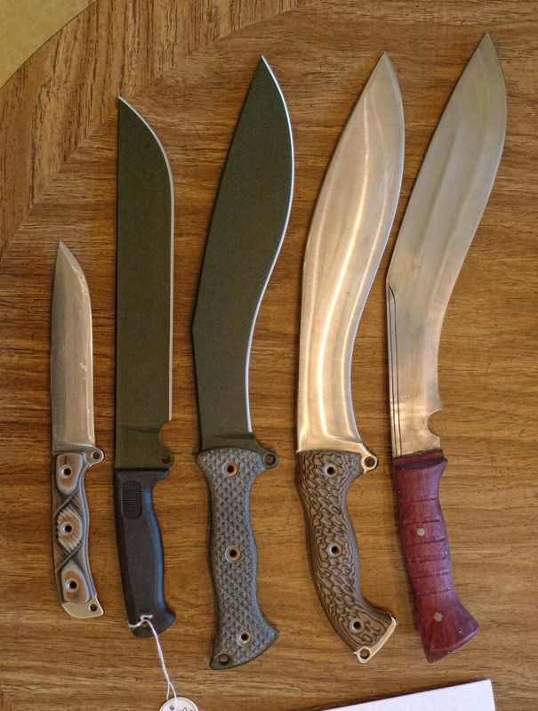

Not to troll, but who makes that pretty little bugger in the pic with the Khukri?

This is where most KLO fail. The tendency to use factory flat steel stock and grinds leaves numerous flat surfaces which look good, but which will tend to generate a high level of friction and binding when cutting through heavy materials. To appreaciate this you need to look at the whole knife and not just the profile. The Cold Steel machete may look like a kukri in profile, but the cross section is just a thin rectangular box.-n2s
