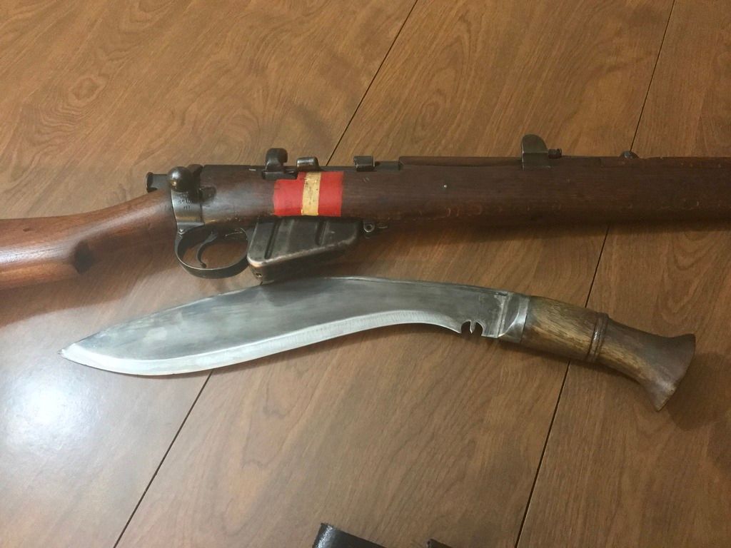

Khukuri patina photos

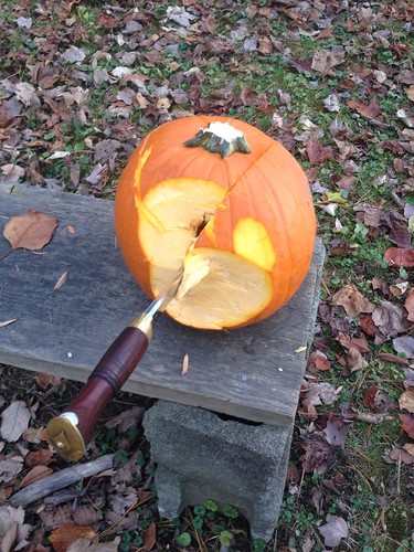

I didn't know it at the time, but 10-15 minutes soaking in a pumpkin put a little patina on my BAS.
It colored my Ganga Ram as well, but its not as noticeable so i didn't get any pics of it.
check this one out:
http://www.bladeforums.com/forums/s...ayan-Imports-Kukuri-s?p=10335833#post10335833
I used my WWII to cut up avocados and the greasy slime loosened a lot of stinky patina. My blade now looks cold gray, and is much more attractive now. It no longer leaves any darkening on foods or white towels when wiped off. It is also rust free when it gets wet. Before the avocados, the blade would start to turn orange or brown if it got wet for a while. My patina is now "hard and stable". I guess it's much more natural now too. It still looks the same, otherwise.

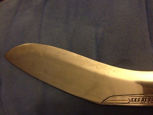

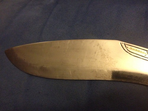

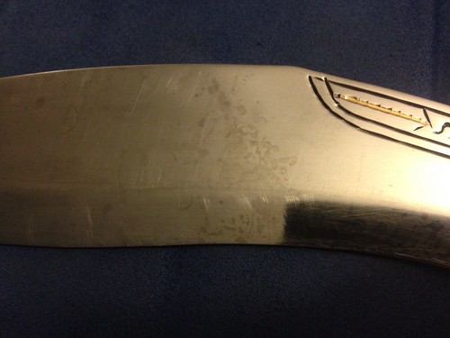

I soaked my 25" Kumar Kobra in vinegar for 8 hours yesterday. Here is the result. Kind of reminds me of the swords Zombie Tools are selling with the worn apocalyptic look.
It's actually darker than in the pic and video. The camera light make it brighter than it actually is.
Video:
