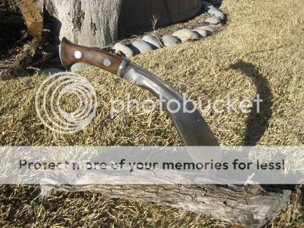

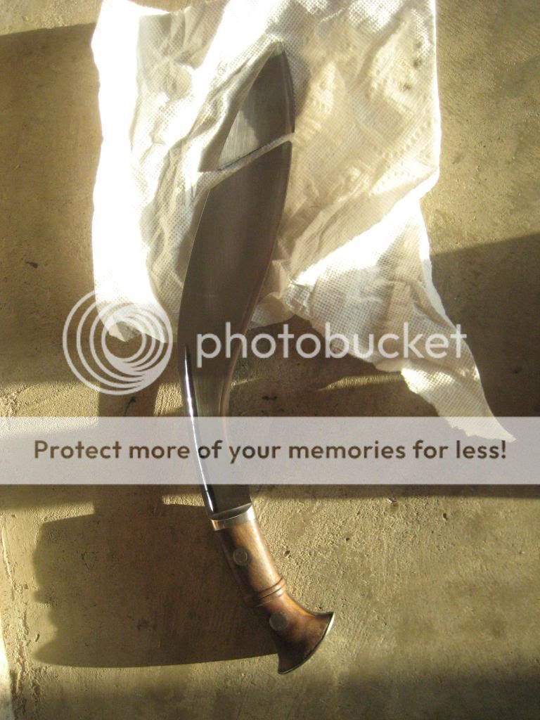

When life gives you lemons....make khukuri lemonade! I've had a khuk for a while which had some problems. The main issue was a poor heat treat which caused the area of the forward belly to be just about dead soft. Strangely, the mid-belly heat treat was well done, but any contact with even green twigs would cause the forward belly to fold and bend like an empty beer can in the hands of a testosterone filled high school kid. So, it sat for quite a while as I had no idea what to do with it. It seemed like it could be salvaged as a chopper, but it was too heavy for my tastes, and that several inches of soft steel was just in the way.
Well, I got the idea of making a specialized tool for clearing palm tree fronds. I have a palm tree and trimming it is a royal pain. The fronds are tough, super tough when dry, and the working area gets really tight. Add to that they're covered in thorns. One of those thorns penetrated my work glove a few years back, going into my knuckle. I pulled back, but it left a little something to be remembered by:(. So one finger surgery and two years later, and I won't be doing any hand modeling. So, a tool just for clearing this tree might make some sense, especially since the blade is useless otherwise.
My goals were twofold: rid the blade of useless steel and lighten the load. Both could be done by hacking the blade at the hard/soft junction. But, I decided to angle the cut to remove more weight. The result, which is a little under 16" OAL (no clue on the weight yet), feels very nice in my hand, and puts a good hardened belly at the end of the blade, great for chopping in tight spots. The extreme tip of the blade is still soft steel, and I plan to leave it dull for inevitable contact with the ground, but the rest of the cutting edge seems to hold up well. While it looks a bit like a Gil Hibben prototype:D, it's pretty handy. It chops quite well and seems well suited for trimming large bushes or other work near the ground, as it has no tip to interfere with ground level work, as normal khukuri do. It also makes decent curls! Overall, I'm impressed with the little beastie! Time will tell whether it was brilliance or folly, but at least It's now a useful blade. Thanks for looking.
The khuk.
Some hack saw and file work.
And, Viola! The khukarang, or Frankenkhuk, or something which looks a lot like a breaching sperm whale:)

How does the Khukurang feel?
Hey Jay! It really feels nice in my hand. The khuk, although heavy, felt well balanced before the transition. It feels better now. We had summer weather yesterday and I gave it a short work out. Today is winter again, so it'll have to wait for more use. So far, I think I may have made a sweet yardwork tool. It's thick and bullet-proof, so I'm not worried about hurting it, yet it's easy to use. I imagine it won't work well on light, springy vegetation, but It'll do what I want. The main thing is it was nice to make a useful blade out of it. I'm afraid to try a parang. If I buy one I'll end up with twelve! Take it easy.
Great work! It looks good also, and you took a blade with issues and made it work for you> Good job!
Thanks ArchAngel. The look of it is growing on me. BTW, it started life as a 28 oz. khukuri, which is a bit heavy in my book, but now weighs 25 oz. It feels pretty nice and balances well. I'll likely continue to tweak it. I like handle rings, but this one is too far to the rear, so that'll likely go away. From there, who knows. I can see myself filing down the of the butt plate as well. It's large and adds weight were it doesn't belong on a dedicated chopper. Take care.
