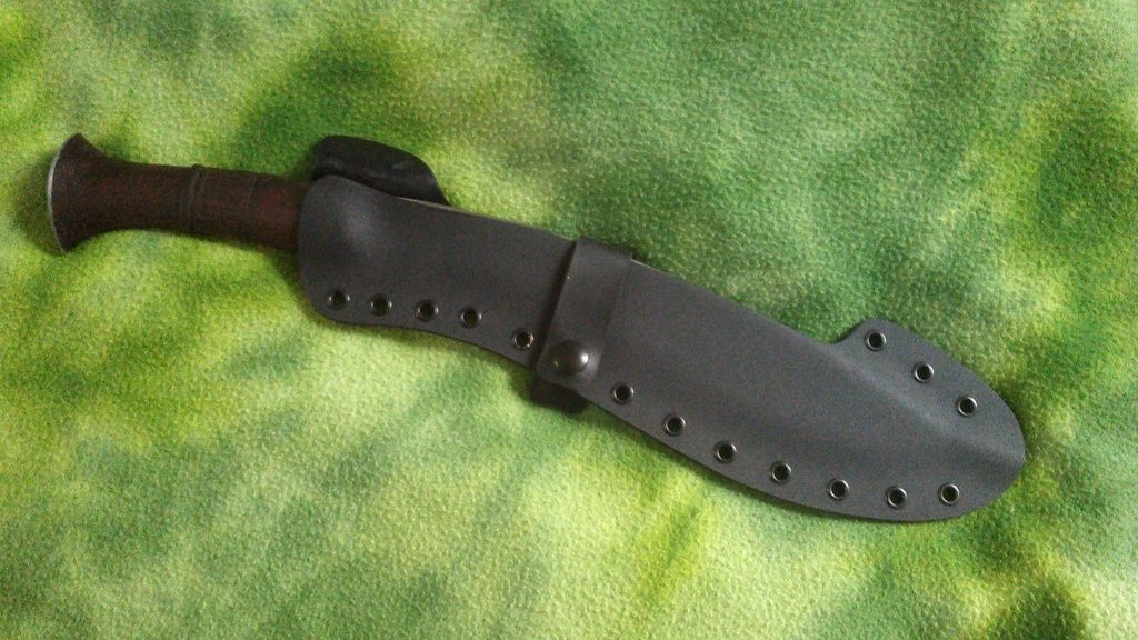

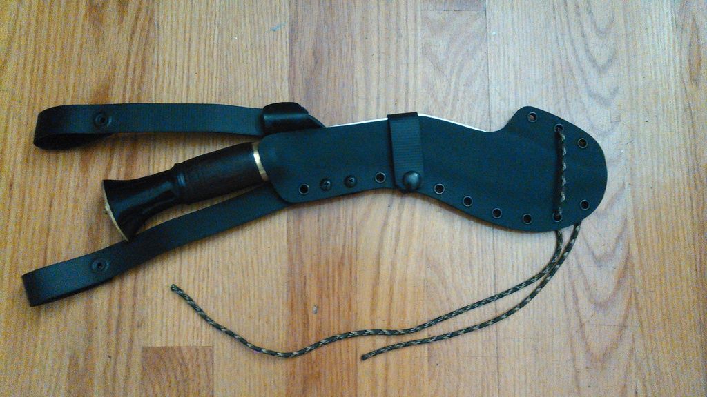

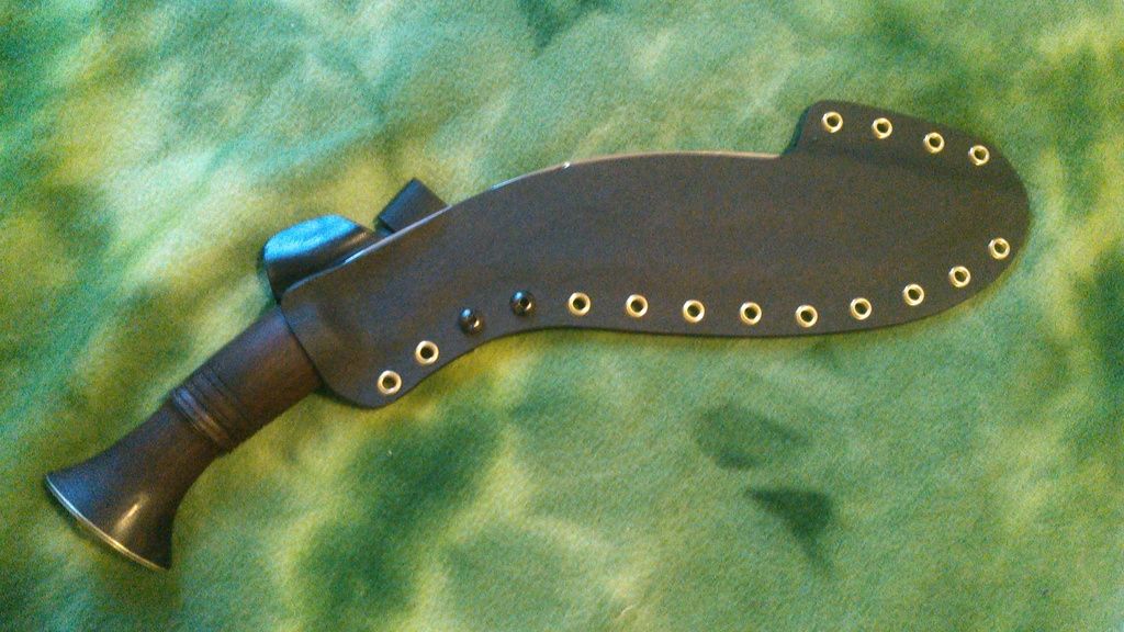

I make kydex sheaths for my most often used blades. Depending on the blade, I often have a retention strap which prevents the blade from being drawn.
This is no strap. The thumb tab is enough to keep this Foxy Folly in, even when shaking it upside down.
This is a BAS with the strap right above the "hump," and it doesn't budge
M-43 & Tamang, both have straps that prevent the blade from being drawn, but you can pull it out an inch or 2 due to the gentle curve of the blades/spines
Wow, those are some awesome sheaths. That's exactly the type of sheath I would want for my Ang Khola. Thanks for showing me those, it's good to know that there is a sheath for these that has really good retention, and also is more slim. I do love the sheaths from HI, but admittedly I would feel more secure with something like these. For a long time I've avoided this concern, wanting to be true to the traditional HI sheaths, but it was always in the back of my mind. So ultimately I think I prefer something like these here that you've shown.

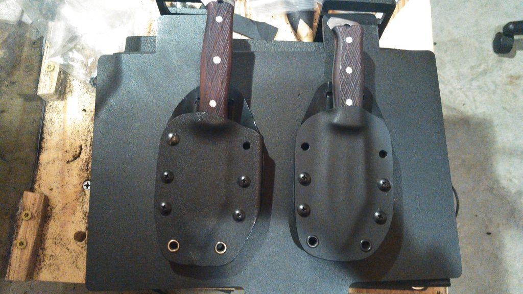

Definitely some talented leather benders on here, including RockFarm by the looks of it. If you'd like kydex, I can do that, or one of the other kydex sheath makers. I've done quite a few khuks now. Of course for any of those options you'll have to send your blade off for a week or 2, so plan for that
Just a week or two? :rolleyes:, I'm just playing, you were going through some trying times with your "kids", glad it all worked out for them.
Seriously though, SG can do really nice Kydex sheath work, for sure. I wear my IBBB kydex sheath almost daily.
