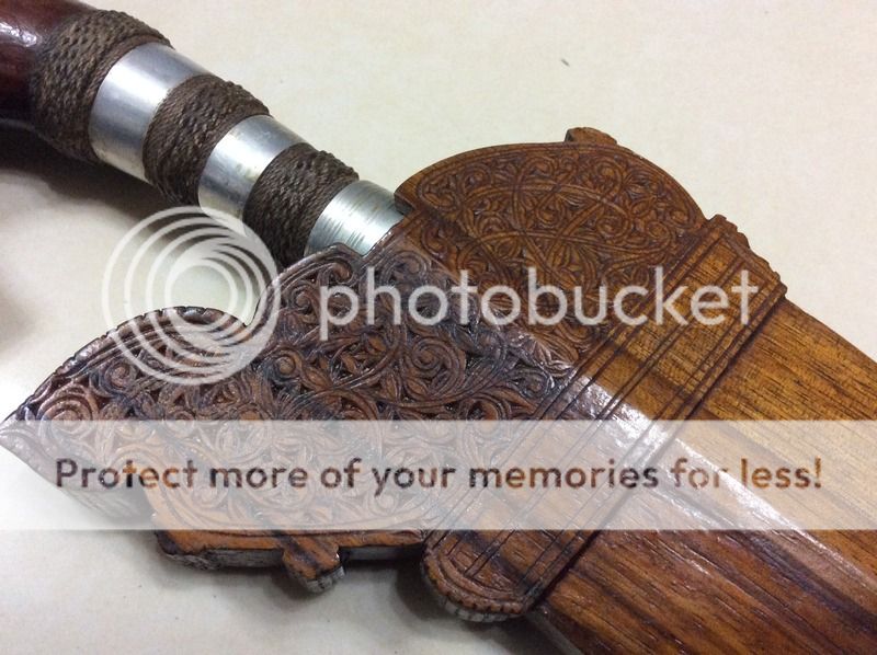

At one time it obviously had a wrap to hold the sheath together but it has since disappeared. Anyone know where to get rattan or reed whatever it is to restore it I would like to do so. Otherwise ill have to make a bunch of agave cord and do it like they did. The hard way:D.
d0e6fdb270cfe08840383c5f435427db
When I received it the halves were slightly glued together and the finial at the end had broken off...again. It obviously had a repair at one time. I went ahead and split the case halves so to speak and glued the broken piece back together. Im pretty sure the two halves were only held together with wrap and not glued so Ill keep it that way.

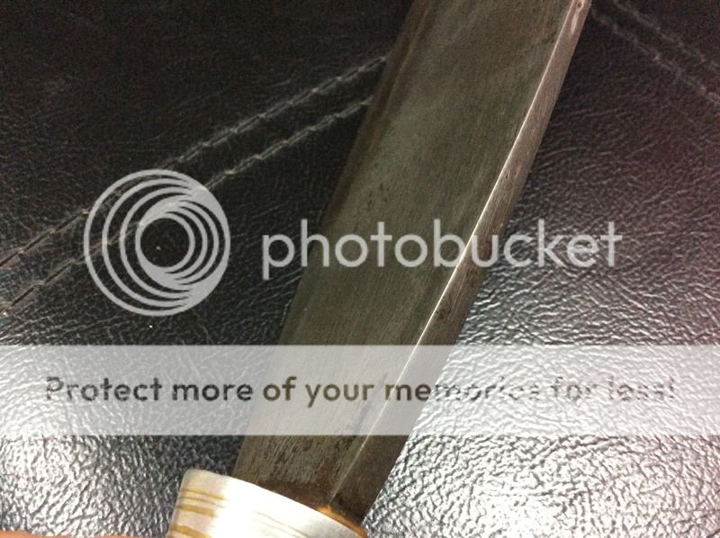

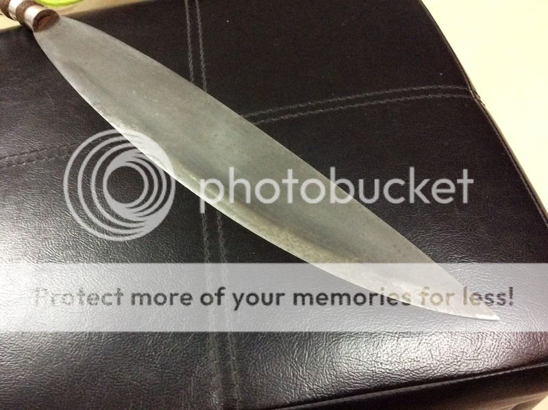

Some nice lamination patterns! I wonder if I should etch it a bit or leave it alone? Still trying to decide.

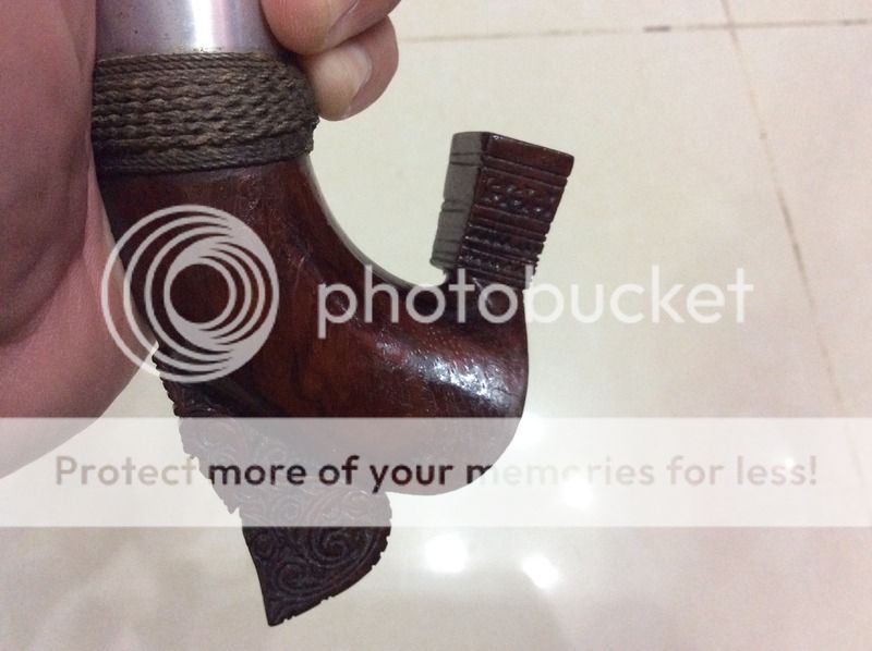

Im amazed these havent broken off yet. Theres a little checking in the handle but all is still there. What an amazing weapon this is. Thought yall might want to see this blade up close. By all means if you have one yourself feel free to post it. Ive seen a few others with the wrap still intact but they get pretty expensive when complete. Thanks my friends! Enjoy!

I love those Barongs! FFG! That will slice & dice! If you want to etch it to bring out a little more contrast. Get a gallon of apple wine Vinegar, a flat roaster pan and a box of baking soda to dump on the steel after you decide you like the etch and want to stop it. a little scotch brits pad to scrub it with the baking soda still on it will bring out the pattern and stop the oxidation.

you can wick some superglue into the cracks in your grip to ensure they do not go anywhere. the fancy little bits on antique ones generally get broken off, so be careful with yours. they're worth more with unbroken grips.
steve furguson has posted a thread on how to replace missing rattan turks head wraps on scabbards that is worth reading. LINKY

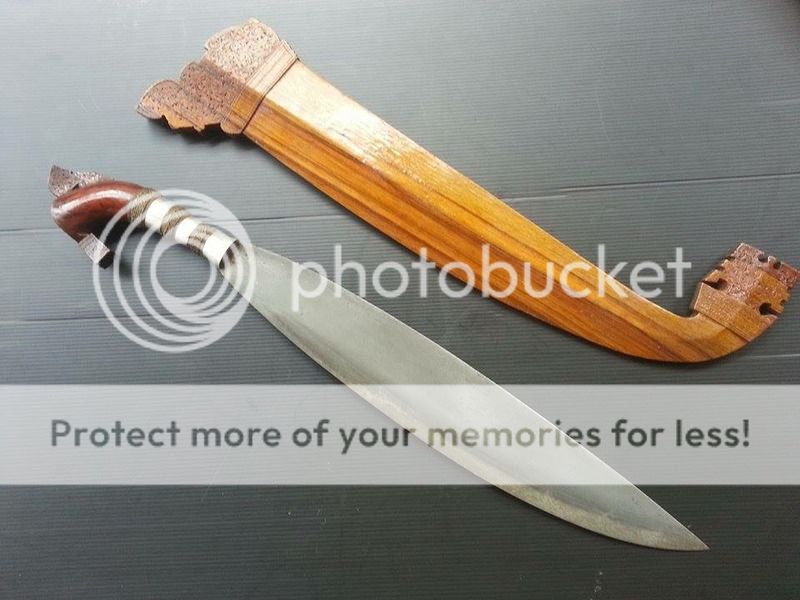

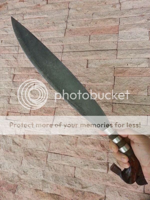

Thank you for sharing your Barong ndoghouse.
I have only one and it was my late father's. I don't know where he got it from or it's history. Has been with us for almost 40 years.
Perhaps someone can give more info on it.
Photos were taken with a phone camera in poor lighting.

Thanks Rhino. Apple cider vinegar same thing right? I think ill do that on this one. It really has some nice patterns. Especially around the edge. Thanks for the info.
edit: OK bro. Etch is on! My wife uses apple cider vinegar for everything. cleaning, hair care, sanitizing, she drinks it... never in short supply. She even makes it herself. Sure does stink when shes fementing it. Whew!!! Thats ok tho because I have 150 pounds of blackberries fermenting in the bedroom now. I call it a draw:D

That rattan wrap is what I want to do with mine. I have to integrate the crossovers from front to back bands as well somehow but once you get that pattern down It should be possible to figure out. Ill play with some string first and If I get it right ill do it for real. There was also wrap on the handle like the one Nepki posted and like JW's blade. Id like to do that as well. Should be a fun project restoring it. Thanks for all the good info Kronck:thumbup:

Thank you Nepki. That one is gorgeous. Even better since it is a family heirloom. Love the carvings and the shape of the sheath. That looks to a bit longer than mine even? I notice yours has a bevel on both sides like mine. I have heard they commonly have single bevel as well. In that case I guess it would have to on the side of your strong arm? Thanks for posting them pics. Ill use them for reference to fix mine up. I wonder if mine had wrap on the ferrule like that? I know it had it on the hilt on the back of the ferrule.

Niice! For what it's worth, I tried etching my Barong with warm vinegar and it didn't do jack. I ended up having to use FECL (PCB Etchant). I diluted it 1/3 with water, nuked it in the microwave for 30 seconds. I also heated the blade up. I rubbed the blade with the hot FECL for about 30 seconds (if you don't rub it beads up and you get an uneven finish). Then I washed the blade down with windex to neutralize the acid. Repeat until the etch looks the way you want it to.
