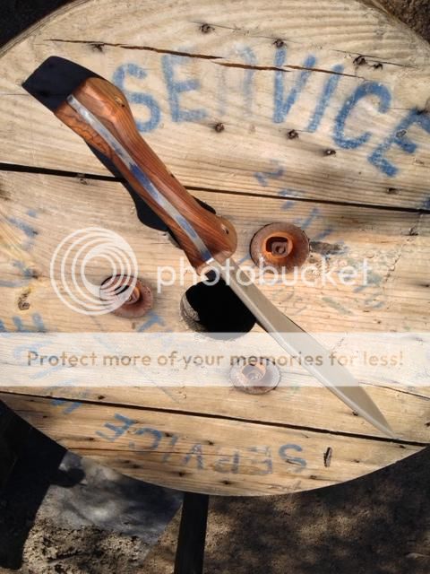

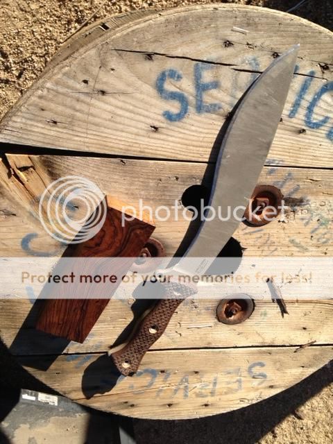

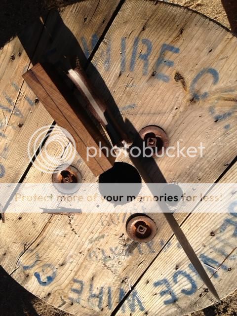

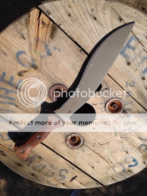

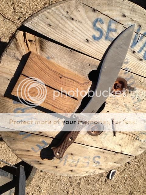

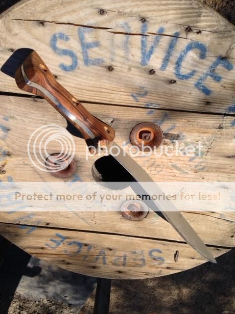

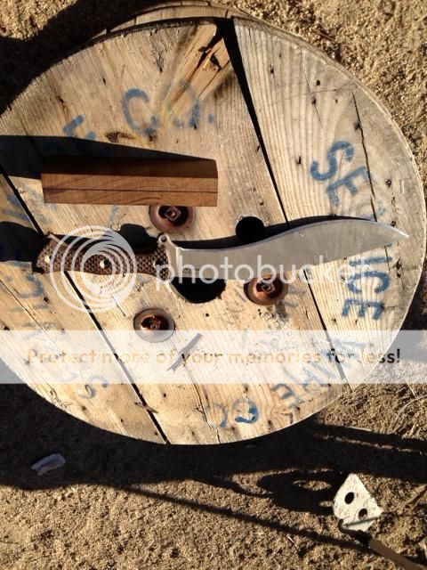

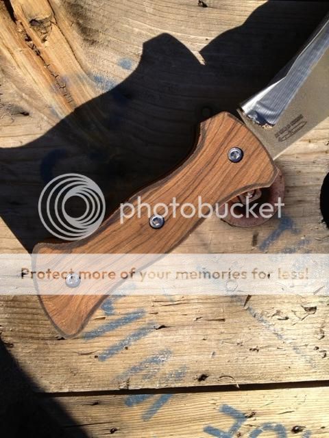

Hi everyone, I love my Killa Zilla II :cool::thumbup: It out chops everything I have, with the factory profile. I had very little issue with the handle, except for the cut out at the rear talon hole. I wasn't able to get back on power chops.
Also I wanted some thicker handles like more traditional Kukris.

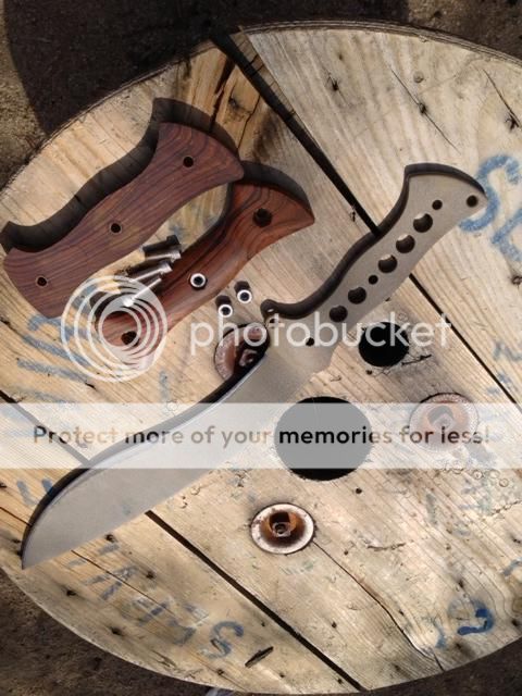

So I made some Bolt ons so I could clean under them and, I used solid 1/4" stainless steel hardware. I figuered thats good for heavy abuse.

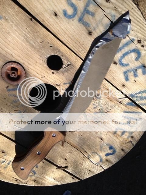

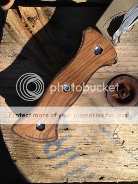

Still need to sink the nuts at this point

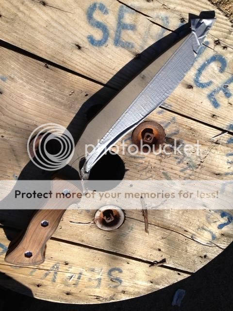

Rough shaped at 80 grit
Things are looking up :)

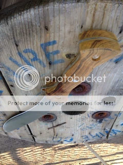

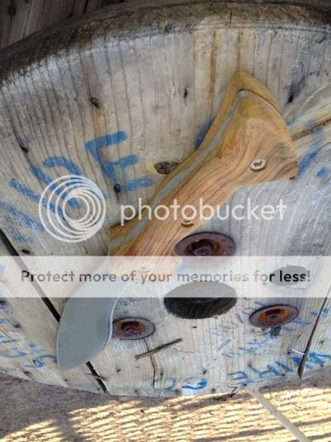

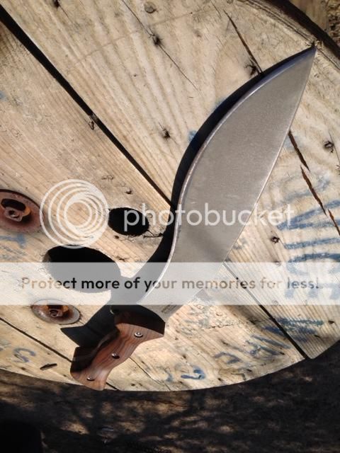

Ok, so I have it roughed in and I tested it out on some medium chops. The wood handles are so thick and so dense(being desert ironwood) that the vibration in the tang is almost fully absorbed. I never really worried about vibration or even paid attention to it, but I can definately feel the difference. I can get farther back and chop comfortably and without the vibration it seems effortless. Like the beast woke up:eek::thumbup:
Also there's one little secret about the KZII...why it's .300" thick and so much lighter than the Test Team. It looks like it was shot with a .50 cal about 5 times, under the handle, and it wasn't even phased.
More pics to come
Thanks for looking,
Al

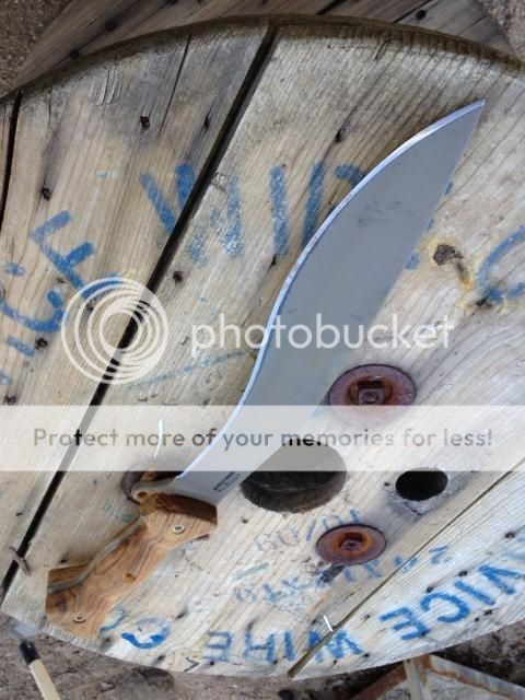

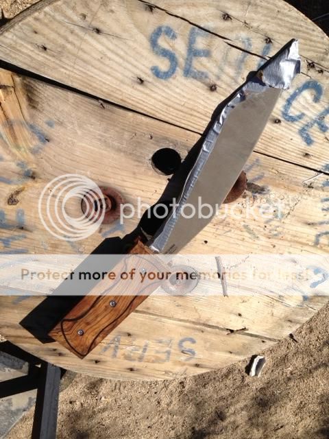

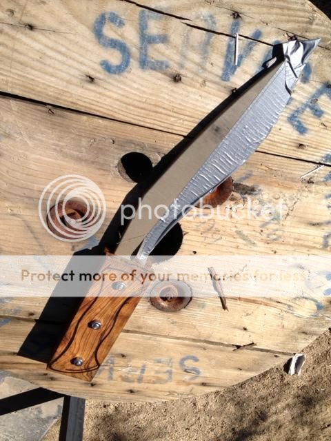

Shaped a little more and sanded to 150 grit, just to get a look.
Thanks, I chisel sharpened a screw driver, and narrowed to proper width. About 3 blisters and 2hours later, presto like magic. :)
So there are holes in the tang?
That's interesting. When he was asked about about the idea of lightening up and improving the balance on big knives by adding holes to the tang, Jerry replied that it was a bad idea on big choppers, as it caused too much vibration to the users hand.
Do have a pic of the holes?
Thanks GunDog,
Resin here is a pic :) If there was vibration from the holes, its gone now. :)
I remember him saying that about skeletonized tangs like the skeleton warden:
(from hogcult)
Did he mention the vibrations specifically regarding drilled holes?

I believe that round holes reduce vibrations... Something about even distribution and no resonance caused by different shape/width of material around...

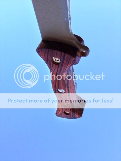

It's Arizona desert Ironwood. It's naturally stable. No artificial flavoring :)
You could stabilize it, but its not needed. And it changes the look.
I get it from a very reputable business, now in Tucson. He has all the permits to sell it, and he knows his Ironwood. Most of the pieces he sells are clean too. Thats hard to find in Ironwood.
Is the wood stabalized?

You are correct.
Found his answer: http://www.bladeforums.com/forums/s...other-thread-got-closed?p=8857036#post8857036
It is clear from the context that Jerry was referring to the milled out tang, as found on the SLUT.
Holes, then, are apparently OK on the tang of some choppers. (But you can't get your knife modded to add holes. So it goes.)
